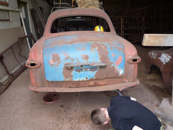

    I have fit the trunklid better
    It's to short in the lower edge
    I welded in little sheet in the lower edge an gringed in the edge for good fit
    Her come some pic of the shape of the trunk lid before i started of rust repair
    It were not good the the 1951 trunklid
    /Stefan
