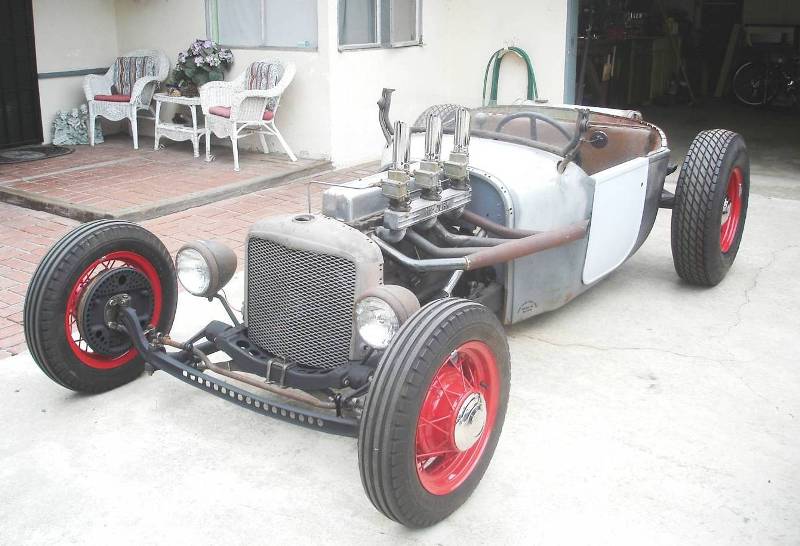

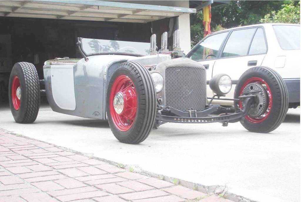

    Well, I thought I would post some photos of my ongoing project.

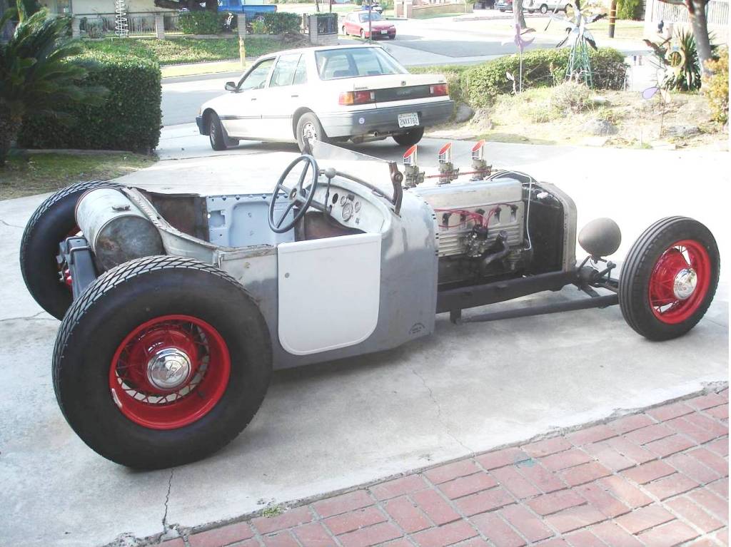

    It is a '22 Dodge cut down touring body; a '29 Ford frame that has been z'd 11 inches at the rear and narrowed 6" at the firewall.
    Running a '49 Chevy 235 "high torque" 6 with Mc Gurk cam and intake, Nicson covers and a Mallory duel point. A '36 Chevy 3 speed, and 48 Ford running gear. I have an early steel quick change that will go in it as soon as it is running again.
    It is coming together slowly as I can only get a few days garage time every couple of months with my over seas work schedule (Russia).
    My wife does a lot of parts chasing for me while I am gone, so a big thanks to her for her help and understanding.
    We bought it 4 years ago as a 3/4 built project (kind of ratty), but I liked the basic setup and saw the potential to end up with what the wife and I wanted. We got it running, drove it for a month while figuring out all the changes that it needed, the took it down to bare frame and started over. I have included a collage of pictures that gives you an idea where we started from once we had it running.
    Hopefully you can see some positive changes.

    Did you cut and shut the '36 and 48 driveshafts in order to run the Chev gearbox to the Ford torque tube? I know that the ford front end will fit into the Chev coupling for the torque tube.

    Yes, the Ford shaft and tube were shortened and connect right up to the Chevy trans. No problems with that one.

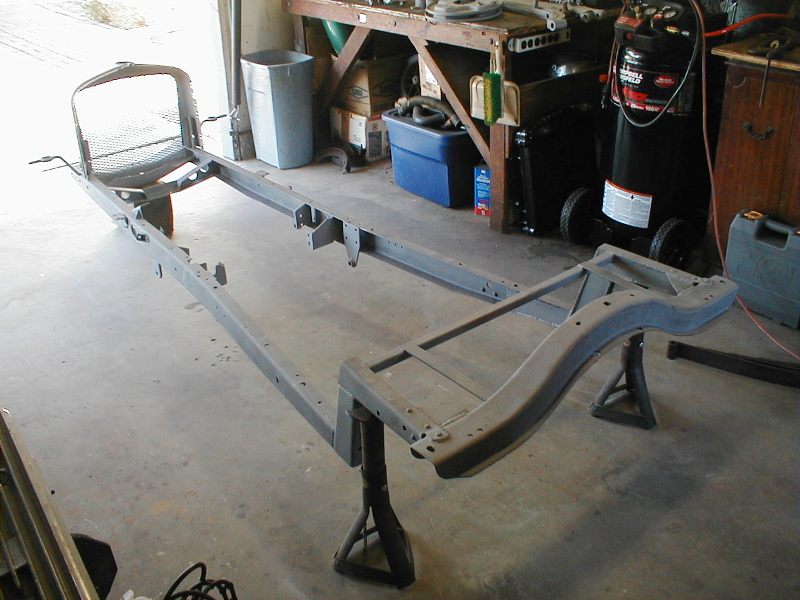

    John, glad to finally make contact with you. I have tried to get in touch with you a few times...cell phone, house phone, email....never could reach you. Is the '31 coupe the one that was in your garage when I was in Fresno checking out the dodge??
    Attached are some more photos...frame after welding, holes filled and sand blasted; the doors after reworking; front end after drilling backing plates, axle, and front crossmember.
    And the early steel quick change that will go in soon. '22
