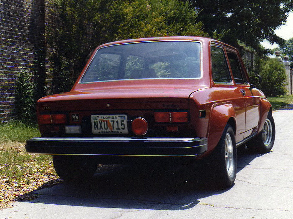

    The color I have penciled-in for my 29 coupe is one I've really liked for years. It was a Fiat color from the early-70's that I had on my 1973 128. It isn't red, or brown, but reminds me of a terra cotta. Like a shiny, wet clay pot. I don't have a code, but it's a handsome, commercial-ish color. Here are some crappy images of my 74 128 sedan in that color. I thought I saw a new Fiat painted a similar color the other day, but from what I can tell on their web site, it is more of a copper metalic. The new Fiats also come in a neat medium blue / green. Later, Gary

    Gary, that is a nice color. That is the problem, there are just so many to choose from. I sit at redlights and look at cars around me for ideas. One good thing is that since the car makers are building such boring cars these days they have come out with some sharp colors to try to put some excitement back into them.
