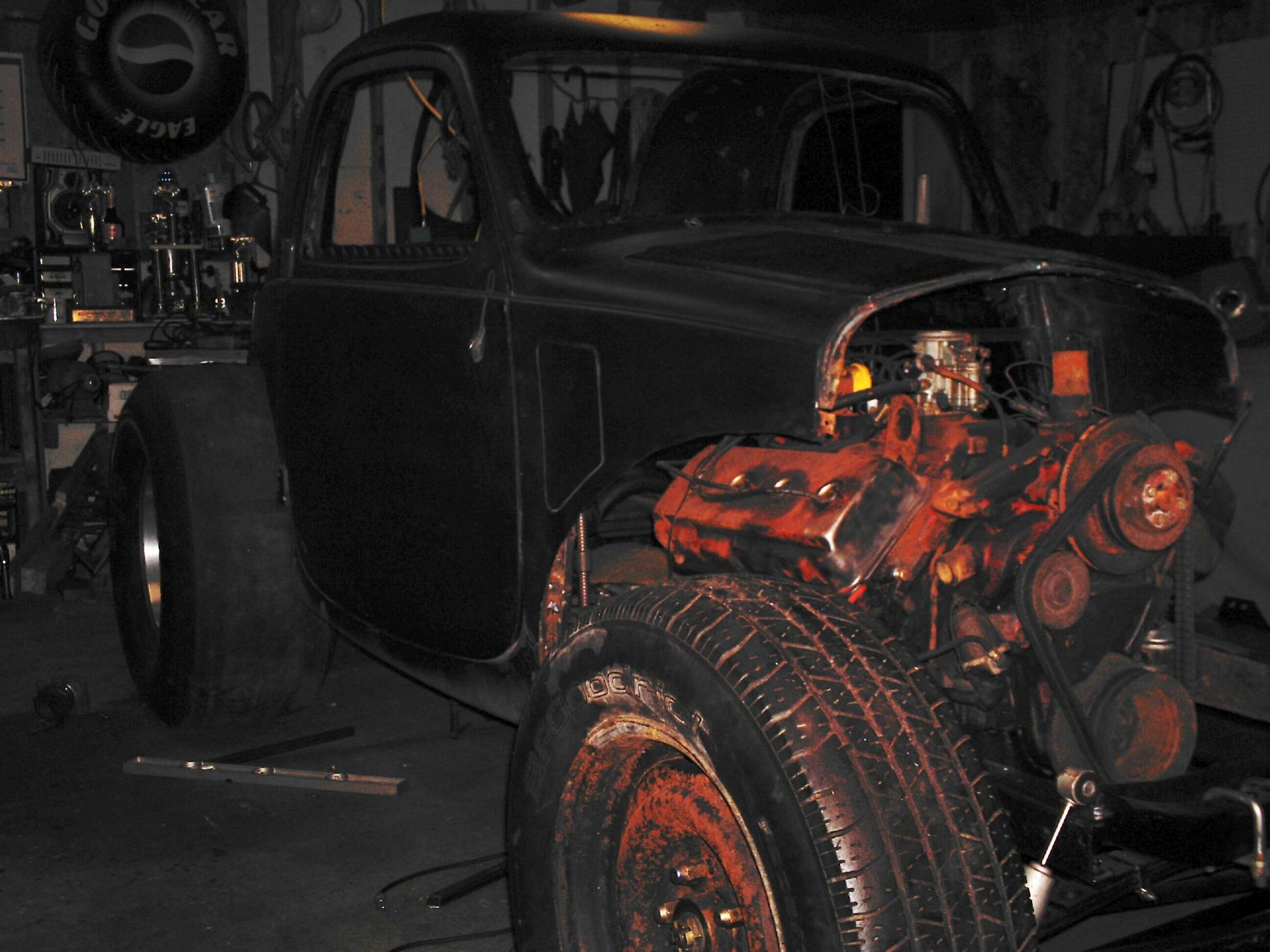

  24. well it's been a month, the floor ribing is pretty much in now....scored a set of M/T slicks and natural rubber tubes...gives me something to roll it with...think i have the old fiat pedals figured out, hopefully get the steering in this week...and the body bolted down..tons to do but we've finally made it off the jack stands...:rolleyes:..some pics, even though my digi cam is going bad, makes everything look red...and the hemi needs a bath!!!!!!

  27. thanks, Bob:D:D...i wanted to roll it out all weekend.....but my 21' four winns is parked in front of the garage, parreling the garage...live in town and between the cherokee and the 48 flat fender, i'm out of room!!!!
    besides, i've been bustin butt to try and get it together enough to get towed into Sins of Steel this saturday, hopefully by Costland's AD Chevy truck...last big Hamb freindly happening that i'm aware of semi-locally.... besides, i'm hope'in to get some advice on who can bend up the headers i want to run.....and some advice on choppin the top a tad...been thinking 1 1/2 rear 2 1/2 front...maybe...:rolleyes:........
    here's a few pics lightened up a bit..still have weird coloring though:(,,,look better in new window/browser mode...they almost look like black and white photos:p

  29. well i had to move the boat to straighten out and mow in front of the garage:rolleyes::rolleyes:...so i figured i'ld roll Lil Beast out the door a bit..:p:p... Lil beast peaks out.jpg
