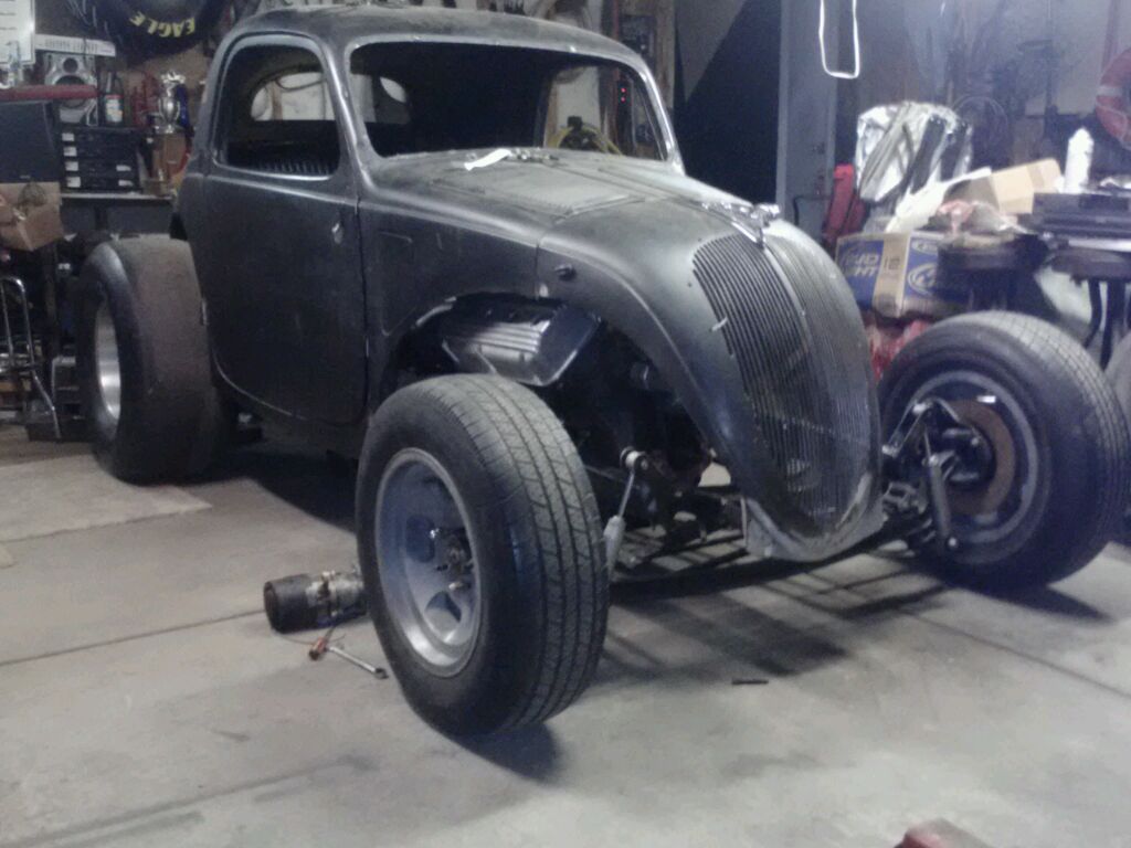

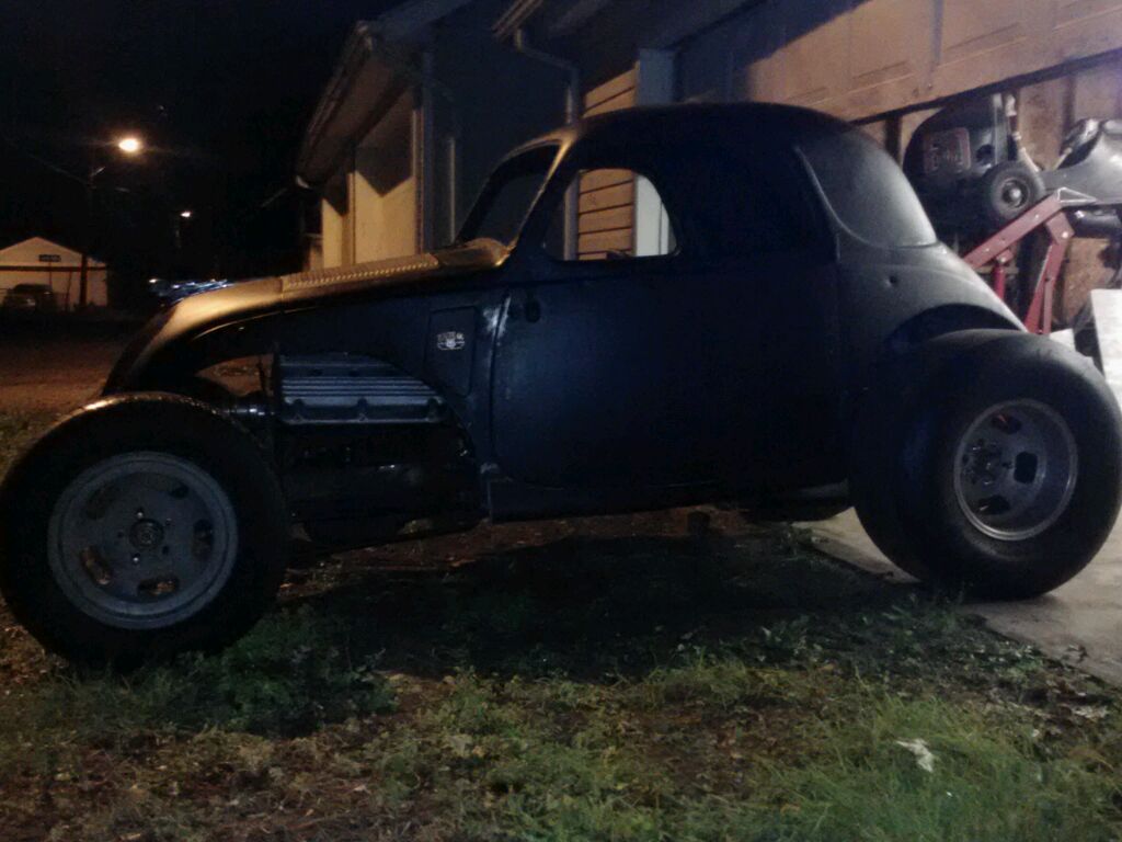

  11. Tarlo i wondered what was going on with your topo...hadn t seen any updates in a bit...selling hot rod stiff...i hate selling just about any of it ...i guess ya could call me a hoarder....but my steel hemi valve covers just sold as i m posting this,so.... :eek:
    But today i hauled the 22' fours winns out to a friends for storage
    Now it s not blocking the garage door so i can move things around for the motor swap in my 48 Willys jeep....so i rolled Lil Beast out to sweep out the garage for the.motor swap in the 48....damn thing always looks so big in the garage when ya been stare n at it for years..first time it s been aloowed to peek out in a couple of years...being outside it s like it shrinks when it is outside:rolleyes:
    So i thought i ld let it hang.out till it got fully dark...lets just say it helps to turn up my morale...

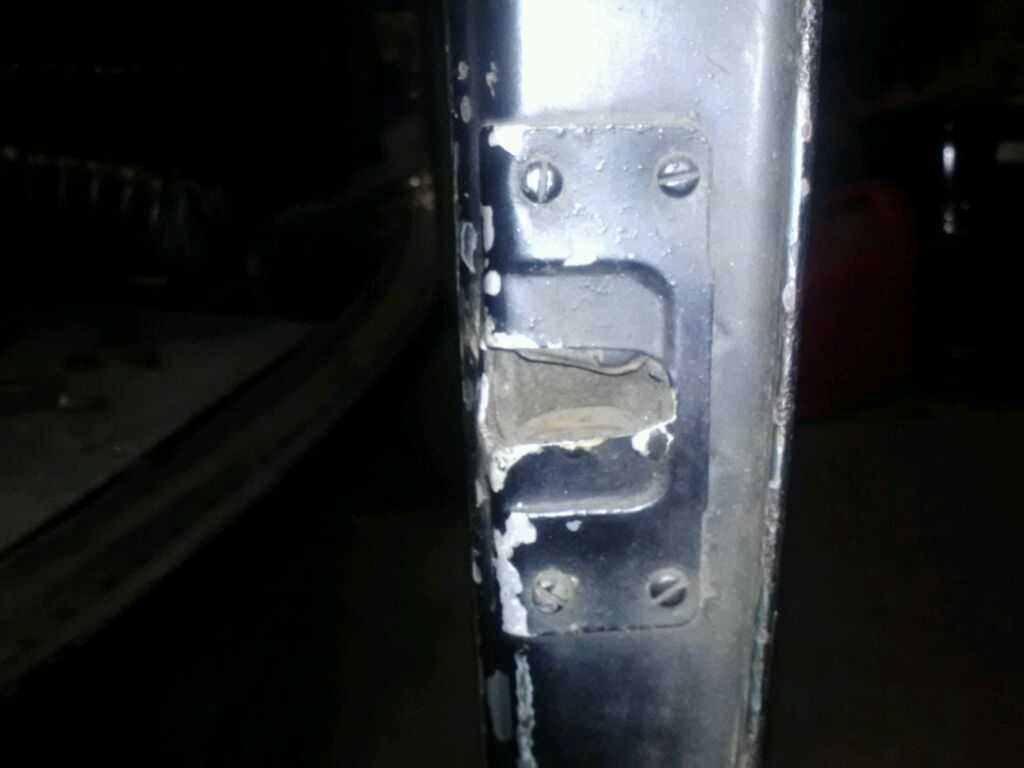

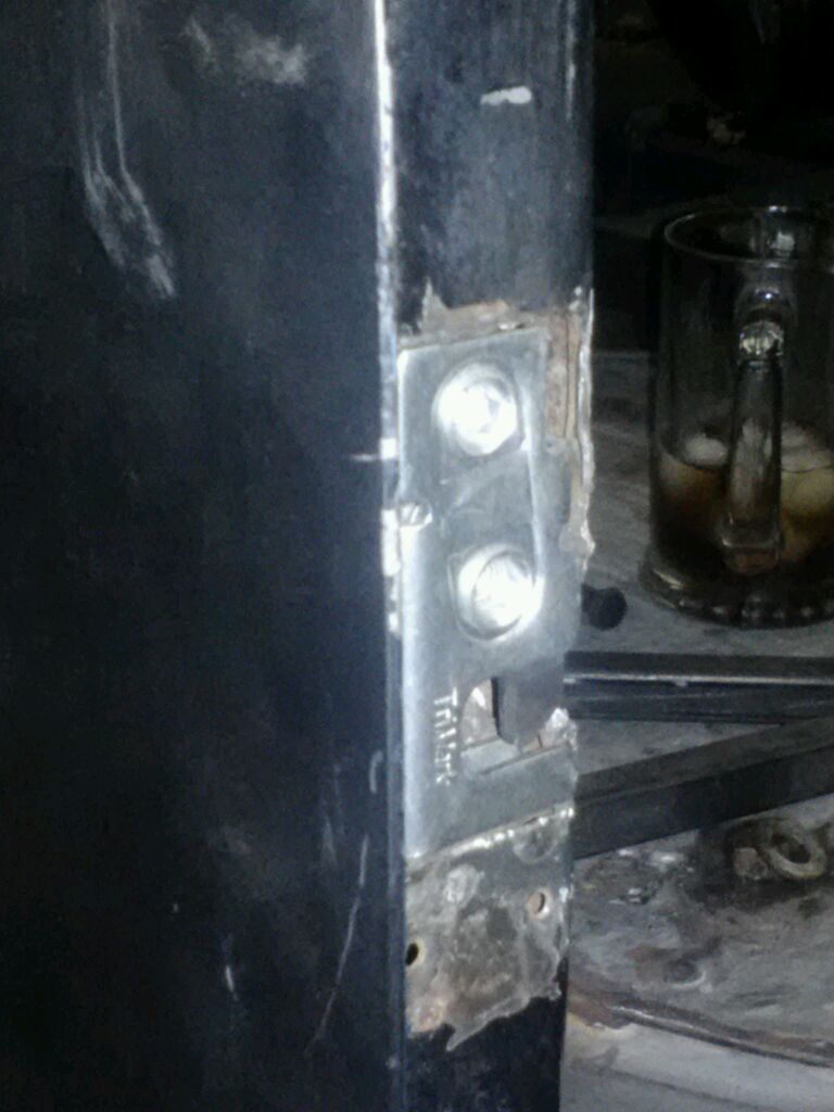

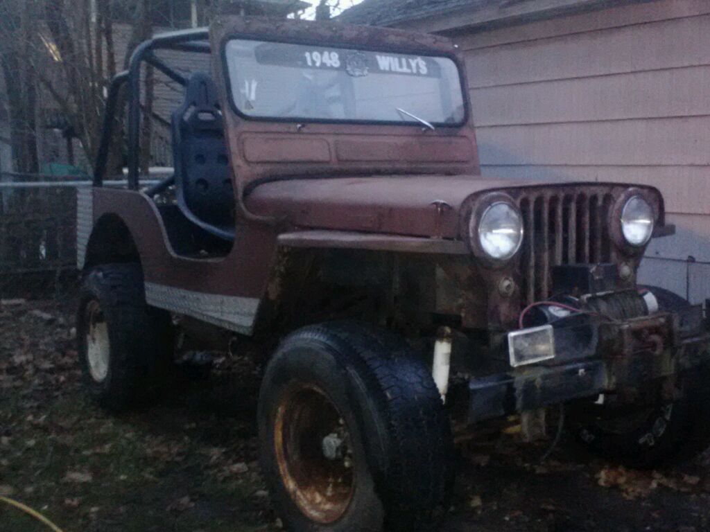

  22. Took a break and went to my brothefs for the past weekend...5 days in beavercreek....had an early turkey day get together ...so i toom a break from the 48. Willys tonite and started fitting in the lower micro bear claw latches in.the.doors...there was a stock.guide that i ised the recess for..it waz nust a vuide withojt any latcb-ability to it...had to open it up a 1/2" but fit well..and it is reinforced from the.factory there in.the.door
    Sent from my DROID device using the TJJ mobile app

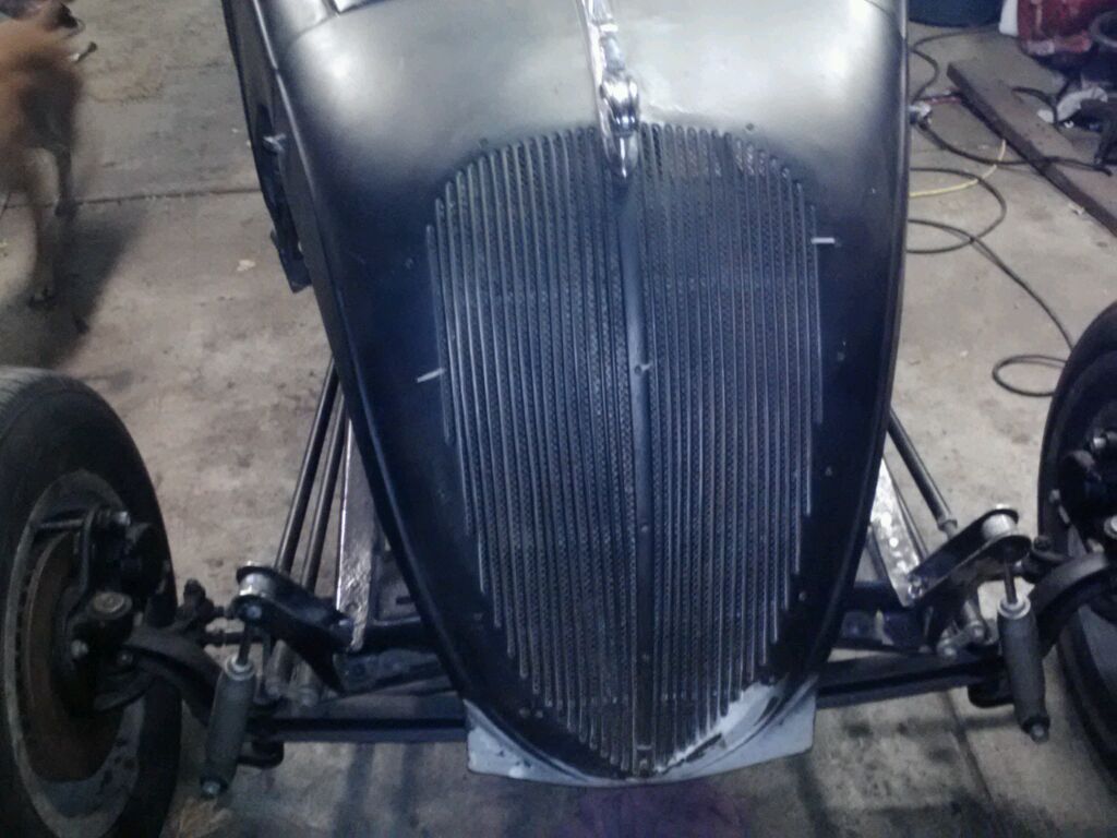

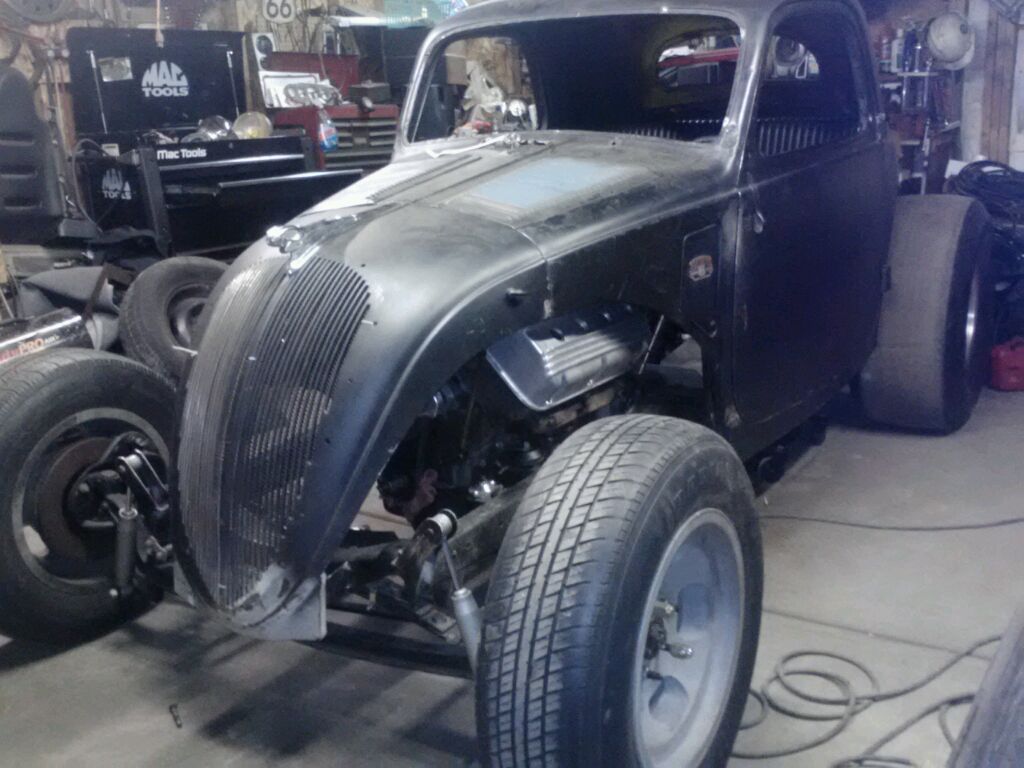

  23. Got the 48 together to run it around town a few miles worth ....upgrade motor..new clutch set...new radiator...still alot left to do but is driveable to move it around uploadfromtaptalk1354591269538.jpg
    Then noticed that the old radiator i pulled from the willys looked about right size for Lil Beast....copper and brass rad..not original for a willys either..forget what i pulled it out of...but it fits the topolino welll.

    How wide and tall is the radiator? Looks real good sitting in the Beast.

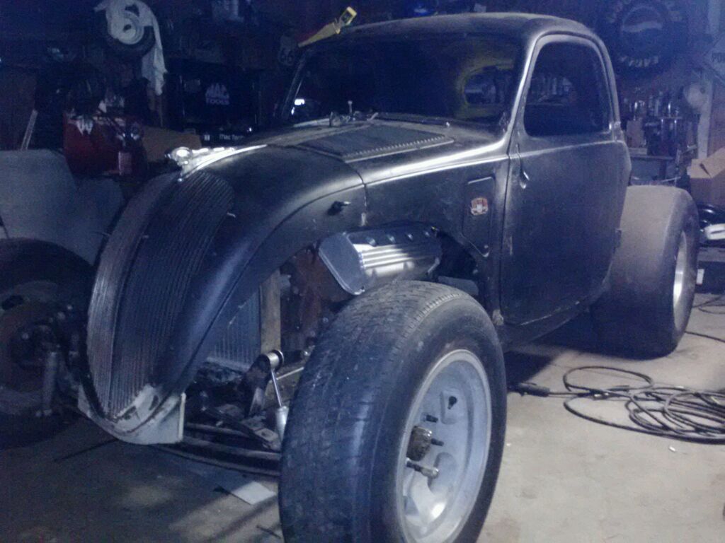

  26. It s good to be working on the topo...i ll be goinv back n forth between the fiat and the willy s..just some minor stuff to do to have the jeep mechanically .finished....just happened to notice how close the rad looked sitting there in the garage...i trimed the rear of the front cross member and got it sittin just about where it needs to be....
    Bob th radiator measures 20" wide by 19 tall... core is 20" wide by 13 1/2" tall...2 1/2" thick...i think it ll be plenty for the hemi..plus the fact there ain t much enclosure to hold the heat...my blown 400 i ran in the vega wagon had a 16" by 17" griffin in it and it never had an issue....the radiator is sitting in place in this picture with the grille/nose in place..
    And it hides behind the grille nicely
