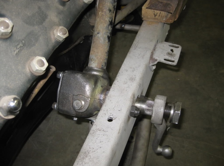

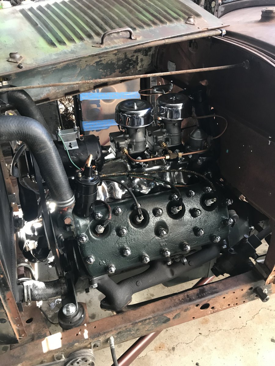

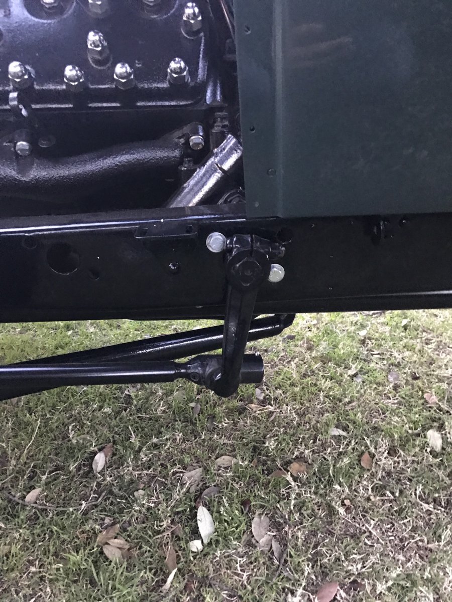

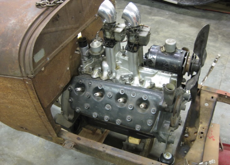

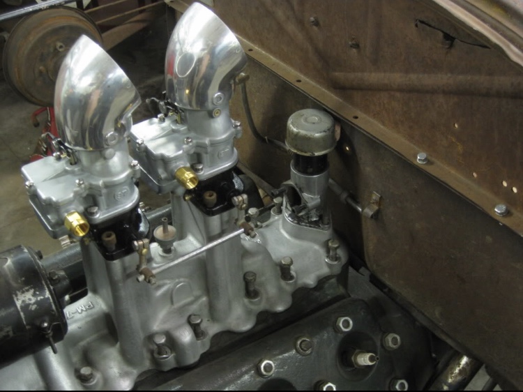

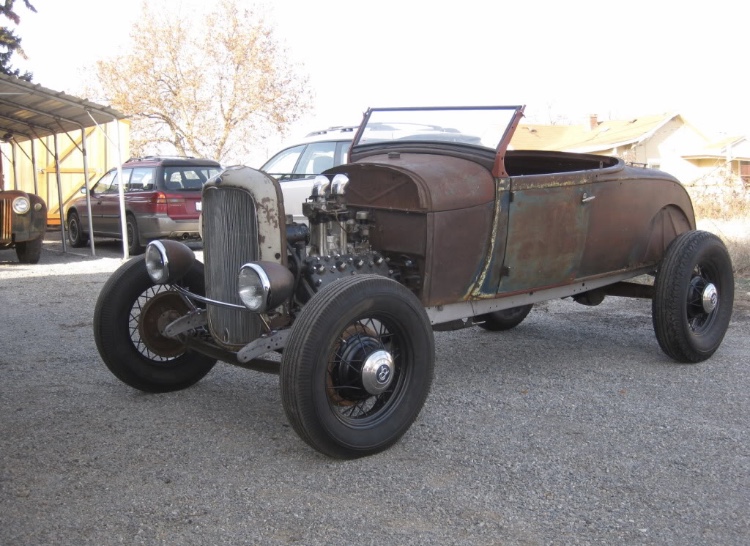

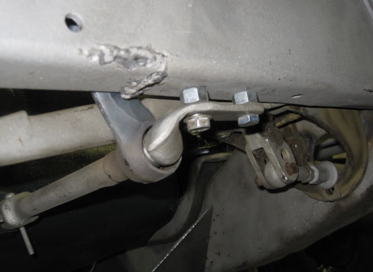

    35E93D35-9FB8-4A6D-9653-0F54BB3F4F66.jpeg 84102DA1-0DDF-415D-99E7-A2A49A4DAF97.jpeg I have put a few 21 studs in 29’s Model As only issues I had.... is the oil breather/fuel pump stand area had to modify the breather tube, for the steering box I moved it back about 6” to clear the headers or stock exhaust manifolds. Also I ran the gen the lowest I could to be able to run a fan of the gen, cut some of the fan blades down also

    That is helpful news. Did the new angle of the steering wheel bother you at all?

    Did use a column drop, from lime works and shortened the column

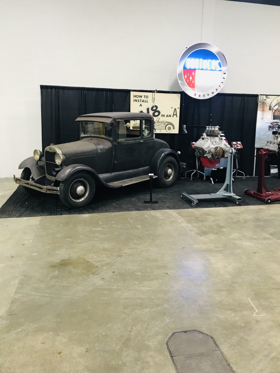

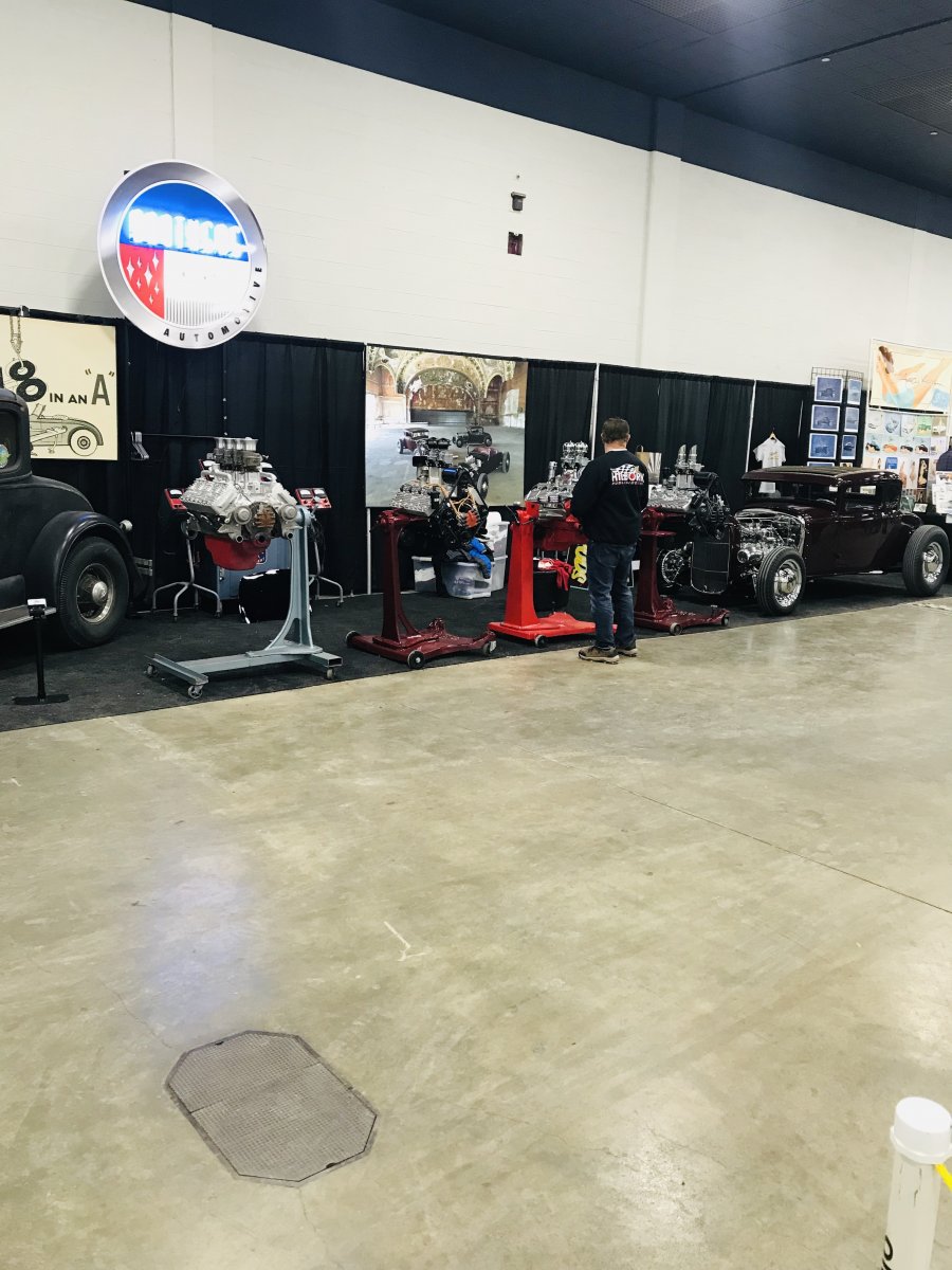

    Setup at Detroit Autorama is pretty much done.

  15. catdad49
    Joined: Sep 25, 2005
    Posts: 4,158
    catdad49
    Great display, those engine "buggies" are Too Cool!

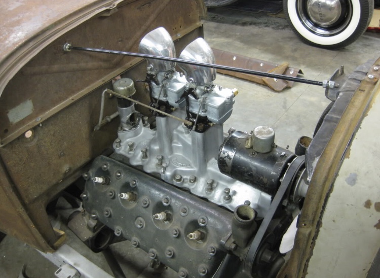

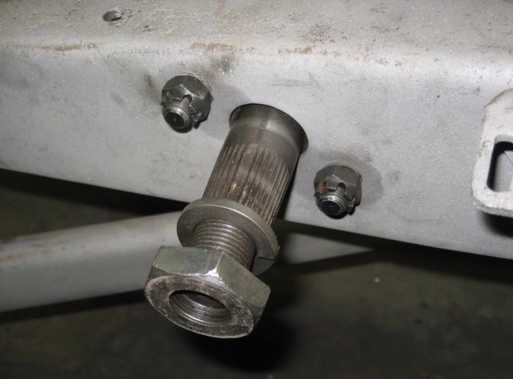

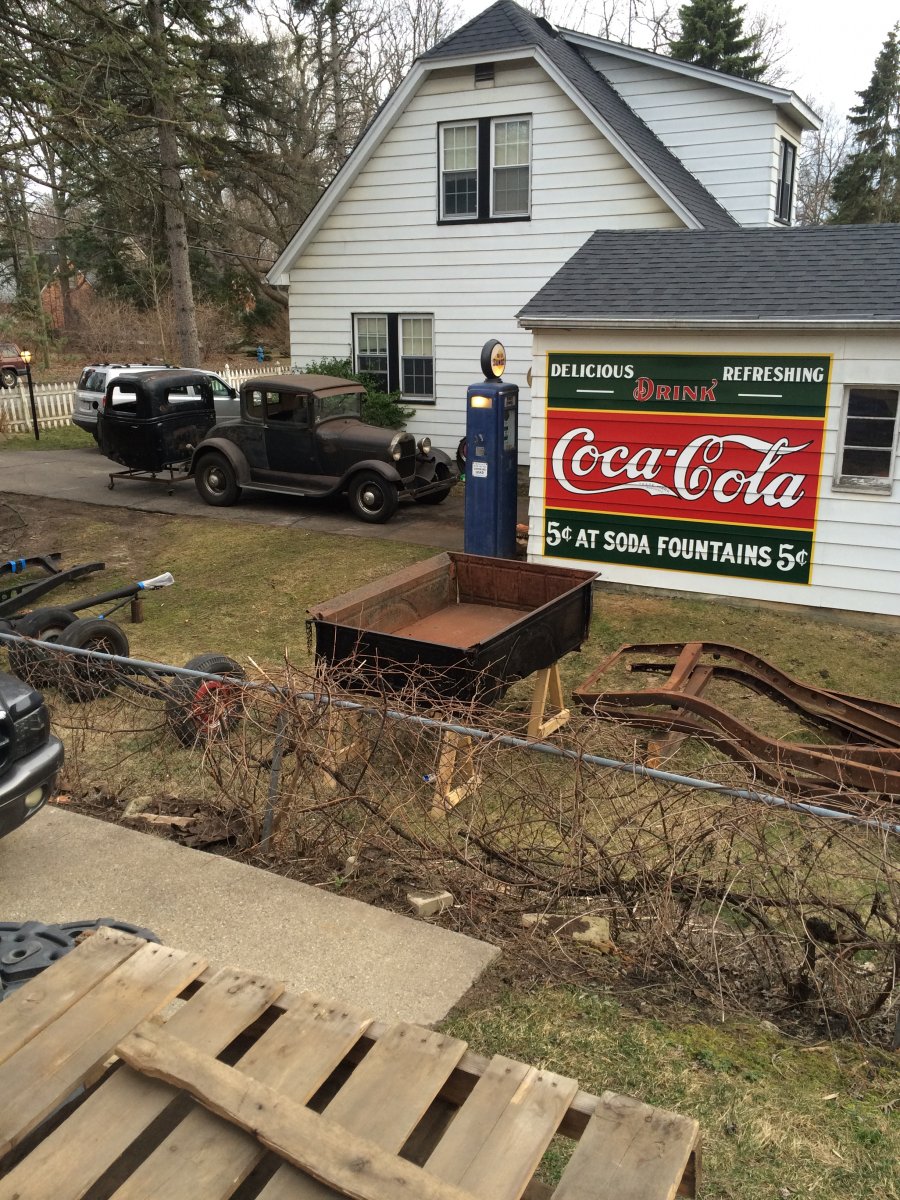

  16. I put a 34 221 into a 29 roadster. But I did modify a few things. I put an F-1 box in it with an A flange welded on, in the stock holes on the frame. It is snug but it fit. I also used an F1 cross member and pedals...things you will have to consider beings the way the engine/trans/pedals mount on a stock A. For a radiator, a stock 32 V8 was used, cut down but the car used a 32 grill (also cut down to fit in line with the cowl). I would think you can probably get a new radiator made to fit a 28-29 shell, but set up for a V8. @leakyboatlouie is right about the breather, it, or the flange on the firewall, will need modified. There is simply no way to "bolt" a V8 into the car without some sort of modifications. But planning ahead and using the right combination of parts, you can make it look like it came that way.
    Side note- My brother bought this car from me when I had it 75% done and had to finish all the small details to make everything work. I had it kind of mocked up, engine and trans in but he finished the pedals, radiator, steering, headers, etc. he finished the car, even raced it at TROG Pismo. It’s also coming out in the new HopUp. It’s a great running/driving car.

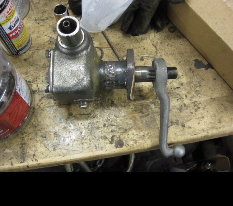

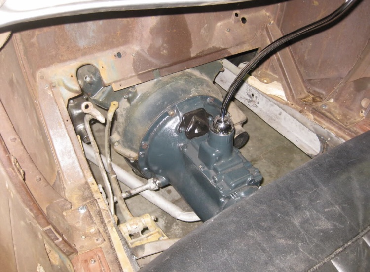

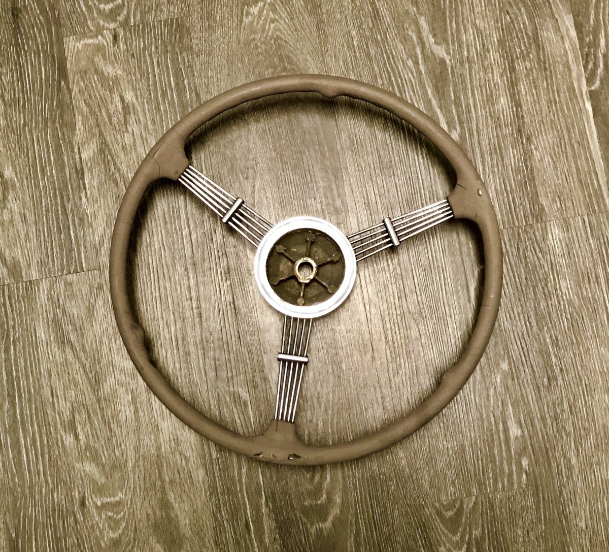

    Thanks Chris. I have a 39 trans in it already and I am keeping the mechanical brakes, they work just fine ( I know I will catch hell for that but honestly they work awesome) so I do not need to do anything as far as that goes, except for making a mount for the trans as it just hangs in there now with the clings v-8 tranny to model a engine bellhousing.
    I did pick up a banjo wheel and steering box at Autorama, think it is somewhere between a 35-37 but not sure because I have hardly looked at it. Does a early cross steer box provide more room? I bought it just for the banjo but maybe the whole thing could be used in my A.
    As far as the radiator that will get taken out and have new outlets put in it for the Flathead. Still gonna run my original grill shell.
    lothiandon1940 likes this.
  18. How are you going to mount pedals? Just use the clings set up? I used a clings set up with a V8 trans in my old A coupe, I can't remember what they do for pedals. And for the radiator, look closely at the bottom tank. It will need to be modified to accept an outlet on the pass side. It's not impossible, but not a bolt in either
  19. As for the box, 35-36 are junky boxes, 37-48 are a lot better. Lots of guys swap 37-48 boxes into 35-36 Fords as an upgrade. If you post a pic I can ID it. I am not sure how a cross steer bow would work, but I would guess they take up a lot more room then a 34-eariler box, or an F series box.

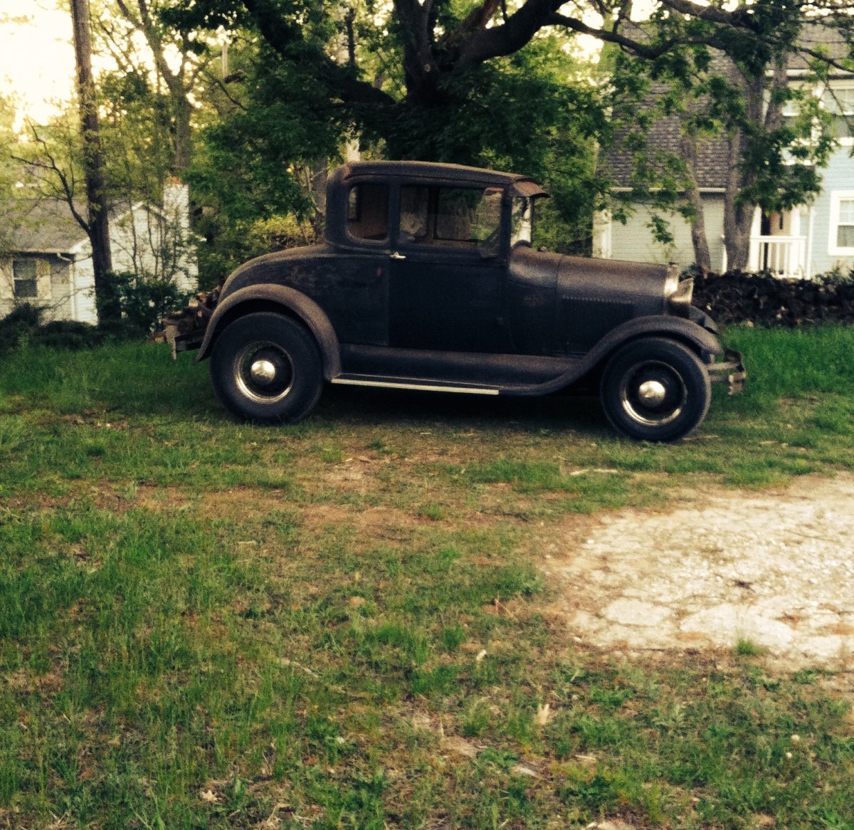

    Sweat coupe, does it have a drop axle or is that stock setup with 1935 wheels?
  21. olskool34
    Joined: Jun 28, 2006
    Posts: 2,432
    olskool34
    Reversed eye main leaf on the front spring

    olskool34
    Clings pedals mount the stock A pedals to the 39 box via an adapter. As for the box turns out it is a 35-6 box. All I was really after was the banjo wheel anyway. The box has tons of play in it. The Wheel is fitting however as my engine is a ‘35 and so are my wheels so it seems I am going after a 1935 theme, lol.

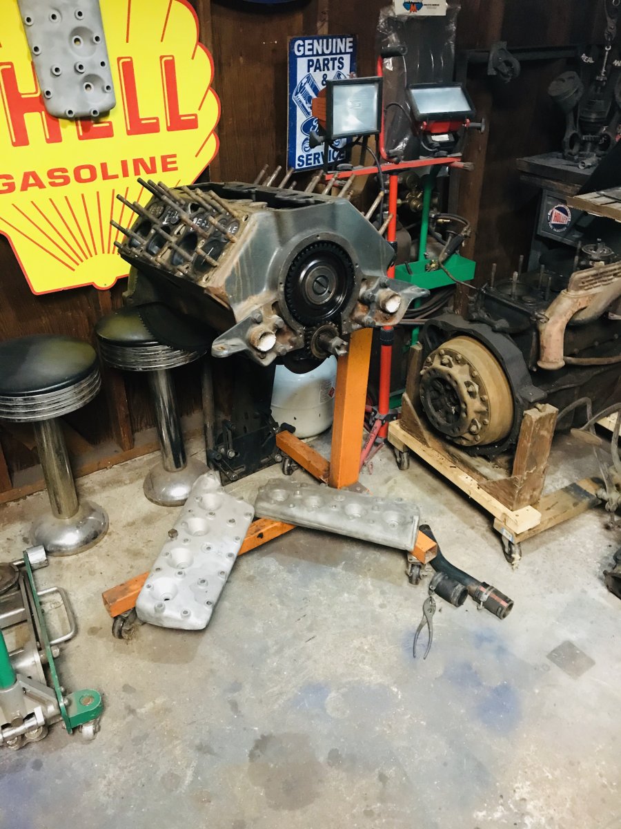

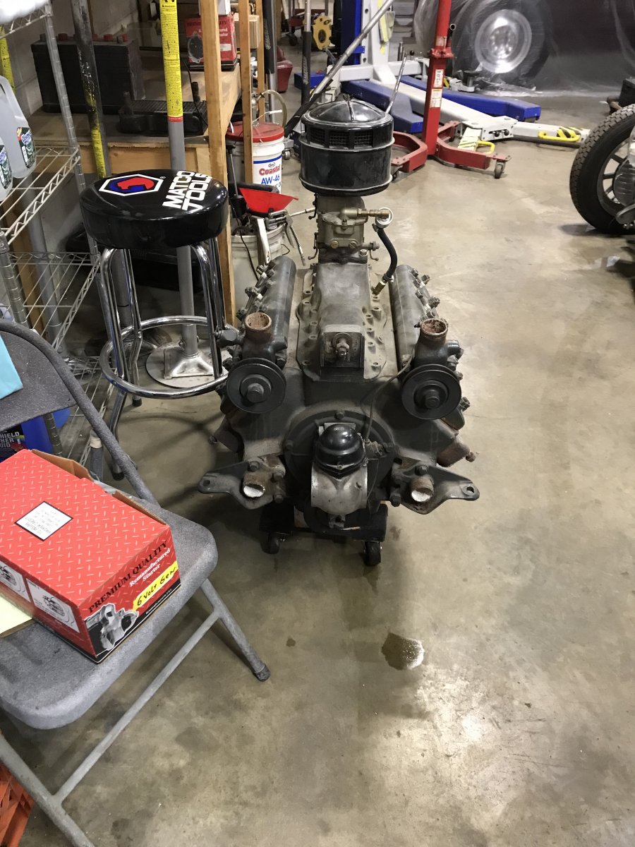

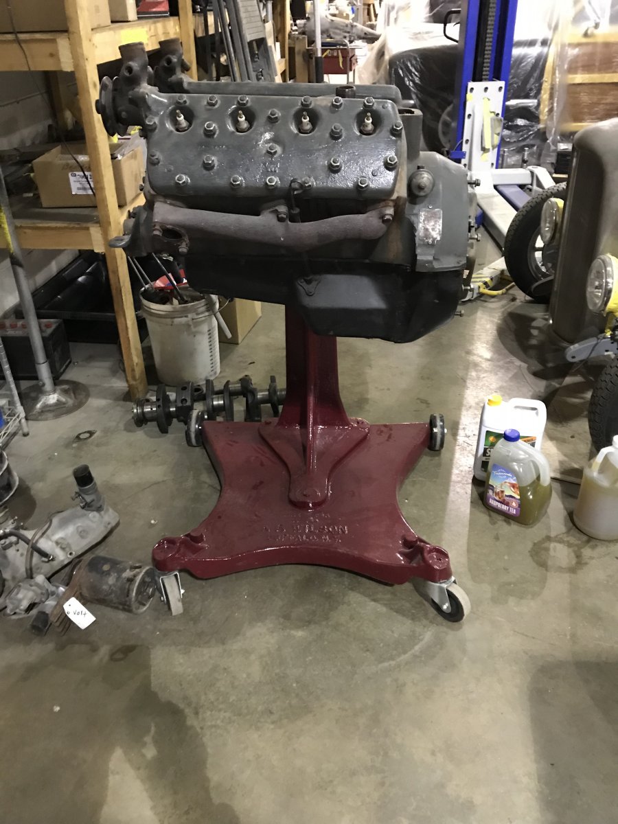

    Had a chance at lunch today to get the Flathead up on a stand. Going to pull the heads and pan and see what’s inside. It has adjustable lifters in it and has an old rebuild tag on the side. Also found that little stamp on the front that I thought I would not find. L-B. It is an insert bearing engine! Very nice to see that.

    Were exactly is the stamp located ? I can't tell from the picture. I've got a 36 that was supposed to have been rebuilt setting in the corner.
  26. olskool34
    Posts: 2,432
    olskool34
    It is at the front driver side of the block between the intake and head.

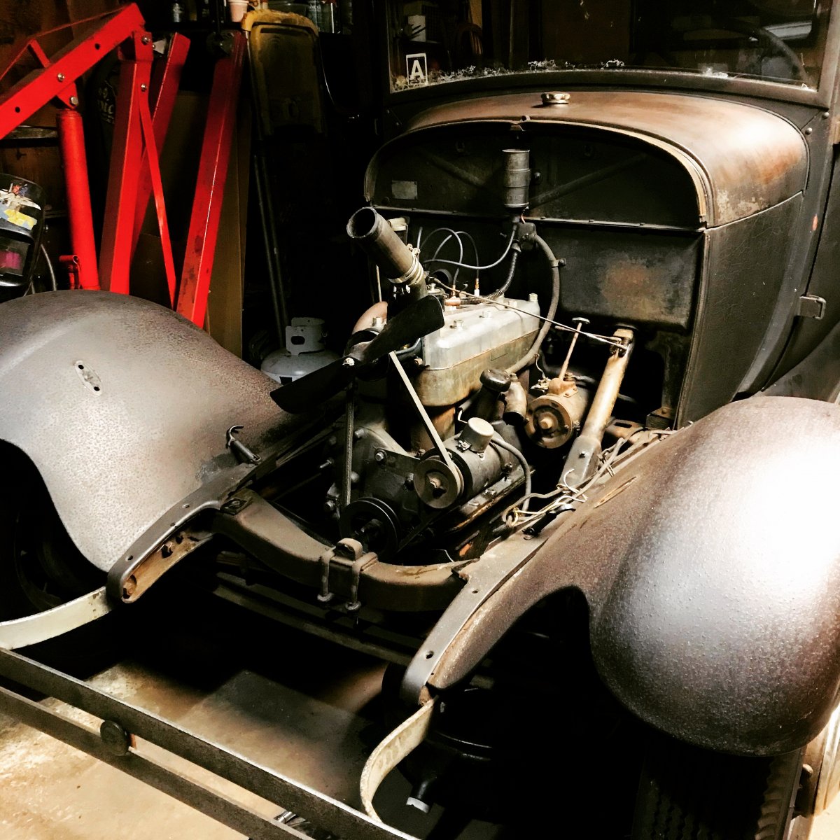

    The switch is no in progress. Ran a Winfield head on the banger for a total of 8 miles and it is just not what I want. Time to do the swap.

    Front sheetmetal coming off.

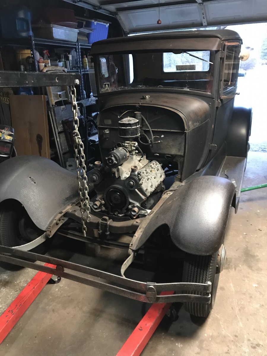

  30. olskool34
    Posts: 2,432
    olskool34
    B2F2618E-0CF8-42F0-BB92-94E3BB5F24B4.jpeg It fits. Lots of work to do now. It is already back out to mount a 32 wishbone on the stock front end to clear the pan. Then it will go back in to make engine and trans mounts. 543994B3-8310-443A-908C-3D24F810F2F0.jpeg
