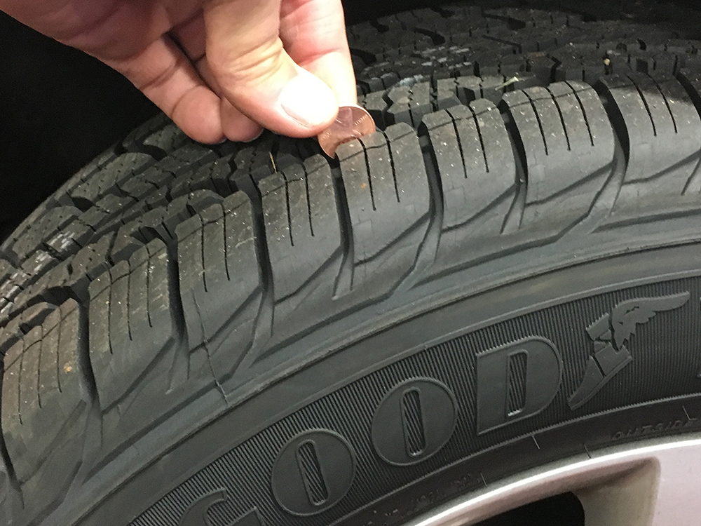

  1. I was working on my old beater tonight and while I was taking a break I was staring at my tires and I hate the way they look, they are black walls but they have bold lettering and some other markings.
    Anyone ever sanded or shaved their sidewall's? HRP

  4. Yep. DA sanded all the crap off the sides. Wiped with some thinner. Looked great

    I too have sanded all the lettering off of the sides of some tires with a DA sander, generally started with 80 grit in spin mode to get the high spots off, then switch to dual-action and buff smooth. You don't have to sand it super fine to get a good smooth sidewall. Helps to practice on an old shitty tire first.
    Not as good as real period-correct tires, but it definitely helps the look.

    Yes I have. Angle grinder with 80 grit then DA.
    Are those the Goodyear tires you are running? You would have to sand all the lines off too, all the way around. Not worth it. Looks like a modern alloy wheel. If not, let's the actual tires. Looks better than a Hankook tire or something like that.

  14. That's not my actual tire, I snagged the off the internet to use as a example. HRP

    Couldn't agree more. Lots of labor polishing those out and they'll still look like modern day Good Years. You won't fool anyone including yourself.
    Sell them and at least compromise with some Excelsior radials.

    I know your wanting to retain the tires you have, but worthy of mention is the Cooper Trend setter & BFG's as they offer about the cleanest sidewalls over the counter, the question remains if your size is available.

    Yep, if they are a few years old, not new as the title says, just wear 'em out. It's a time consuming, filthy job sanding them.
