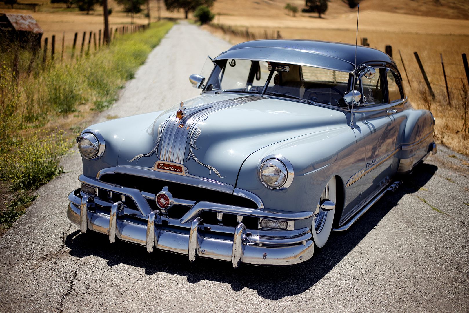

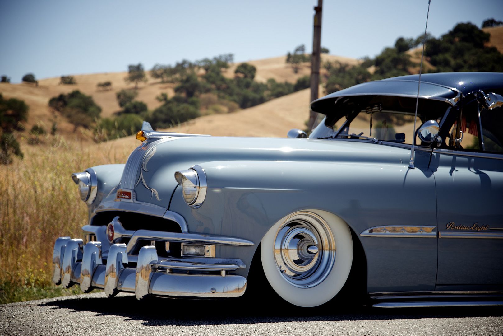

    alot of updates...
    new stance for one.
    bagged & notched the rear, lowered the front alot more with dropped uprights.
    smaller tires in back to perfectly level it out (no pictured)
    new motor/trans.
    after much debate we went SBC, but something VERY cool.
    it's a 283 62' vette block, punched out to 292.
    80's IROC heads w/hardened seats (run 91 pump gas no problem) 50's cast iron intake, OE GM ram horns, '54 4-jet fully rebuilt, korean fireball cam.
    vintage ribbed cast air cleaner cover & valve covers, and alot of other trick reused, reclaimed, NOS, and/or hand made/modified US made parts.
    it's paired to a fully rebuilt 700r4 & a rebuilt factory rearend.
    the thing sounds nasty...
    lakes are hooked up and ran straight at shows. when capped, have a quick 12" glass pack turn down right behind the last cap on each side, unseen for a more mellow rumble.
    also just flaked the roof...no pics as of yet, but with a subtle yet very kool choice over my metallic navy top, lil' daddy roth's "Crystal Beth"

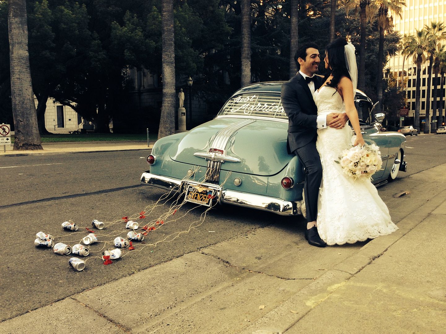

    was able to be a groomsmen AND driver for one of my good buddies wedding last weekend.
    not only did I snap these two badass pics, but it shows a few of the new mods.
    now running 600-15's in the back to perfectly level out the car on full drop.
    also flaked the roof & had the entire car buffed out days before the wedding.
    dropped the front bumper 2 inches & plan to do the same in the rear next week.
    ...and the coolest of them all, dropped the license plate to the rear bumper & added a front end chevy overrider.a
    then added more silver streak under the trunk to add to the flow in the rearend.
    I think it's not both subtle & slick and prob the only one out there with it.

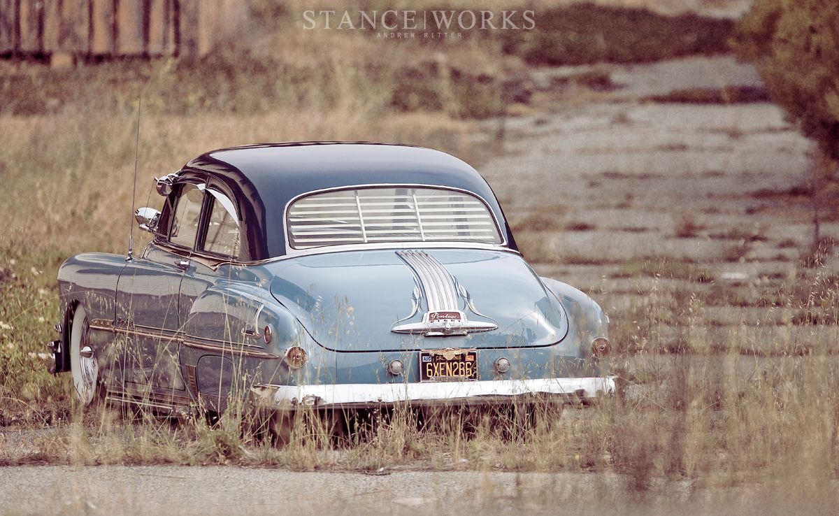

    what's to get? originality is great, sure...and a lot of this car is original.
    but keeping something bone stock is beyond boring...any car guy "gets" that.
    I believe everything I've done is extremely tasteful...done right & done kool.
    here's one from last weekend.
    I dropped the rear bumper over an inch, 4 linked the rear, and added some beefy shocks up front. thing rides like a cadillac.
