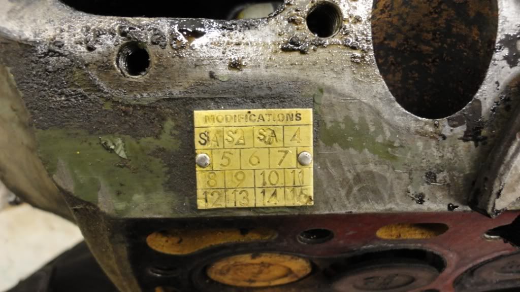

    Done some measurings, ended not so good that I first though.
    The identificaton plate indicated that the bore and crank was stock, but it turned out to be .030 bore, std crank with some wear.
    Found another identifiaction plate near intake
    That might indicate that it have been serviced three times?

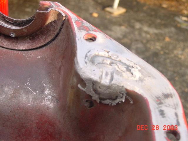

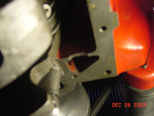

    I bought a french block and main caps and built it here in the states for my 40 coupe. I made blockoff plates for the rev limiter (whatever you call them) holes, installed a 4" crank, adj lifters, Elgin cam, and left it a stock bore for a 255 cube. So, all of the US hop-ups/parts/tricks will work quite well on these engines. This engine is hooked to an S10 5-speed. For all intents and purposes, top and front of the block is 8BA, bottom and back is 59AB. Therefore, you need to use the 59AB pan but you must weld up the breather hole and cut a relief in the block so the passage where oil would have flowed out of the block through that breather will run back into the pan. If you don't do this you'll have oil all over the place - ask me how i know!!
    My block was factory relieved, I'm running a stock 8BA distributor w/Pertronix conversion, and 2 deuces. I run a "poor man's Thickstun setup" via an 8BA aftermarket intake and 4" risers. I use a 59AB fuel pump/oil fill stand so I have some breathing out back and a PCV valve through the front oil breather hole. The intake oil fill hole I plugged. As has been said before, a 10" clutch would be your best all around choice unless it's going into a real light roadster (or somthing similar) where a lightened 9" flywheel (the big ring cut off) would emulate the lightened alluminum flywheels. I have this in my 32 roadster with a 59AB flattie and 5-speed.
    These blocks are super pieces, plenty of nickel in them, and they are a bit heavier than the US blocks. Less prone to cracking, if you get one they are usually pretty good. I've been running mine about 7 years now (got mine when Halibrand frist got them) and if you come from an area where good blocks are hard to find, you might save some money by getting one of these blocks. They do come up on eSlay from time to time and I've seen them go for $1500-2800, depending on completeness. There are some slight defferences in internal parts - rule of thumb is to use either the French or US rotating assemblies - the french cams are 8BA and they are good for grinding up to your specs - that's what I did and I bought a second I'm holding on to for a future build....
    I've run this car at speed for hours at a time - great engine, ave's between 18-22 mpg, and no overheating probs.
    I've attached some pan/block pics regarding that breather - hope this helps you somewhat ....

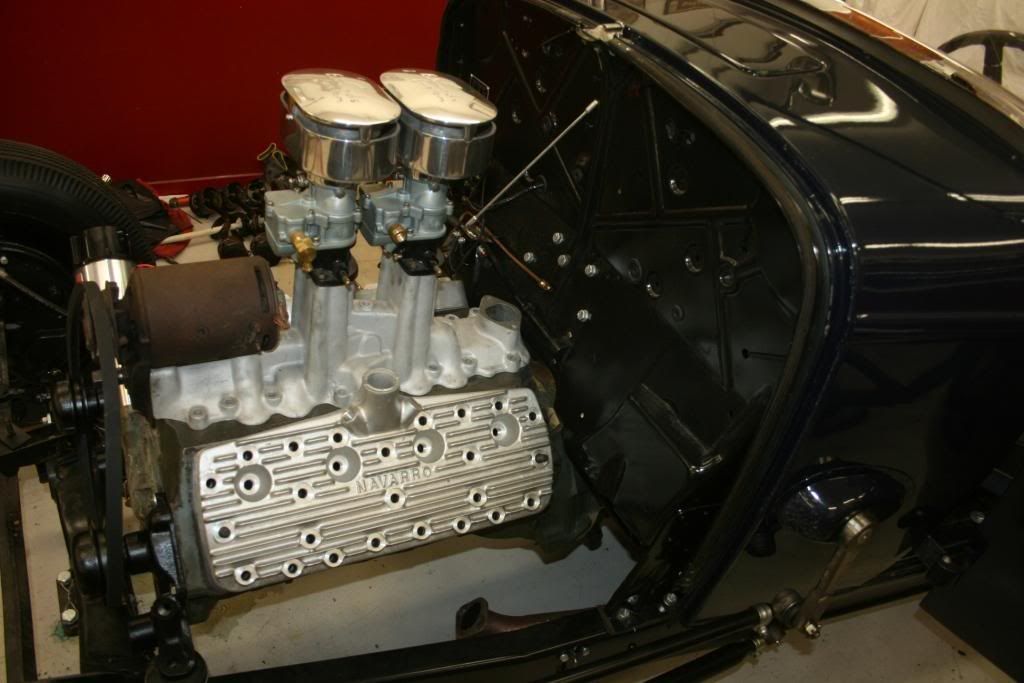

    Finally got some parts! My coupe is used as a garbage shelf...
    Now I can get started on the motor build. New parts are:
    Navarro heads
    Thickstun intake
    Stromberg 97s
    Hunt distrb.
    Bearings
    Gaskets
    Used flywheel and oil pan
    Truck water pumps

    I did a mock up and put it in the roadster to understand the issues with the pulley I want to run. This is because of that the crossmeber is mounted behind the axle and I now want to run 8ba styled distributor. It will be hard to get it working
