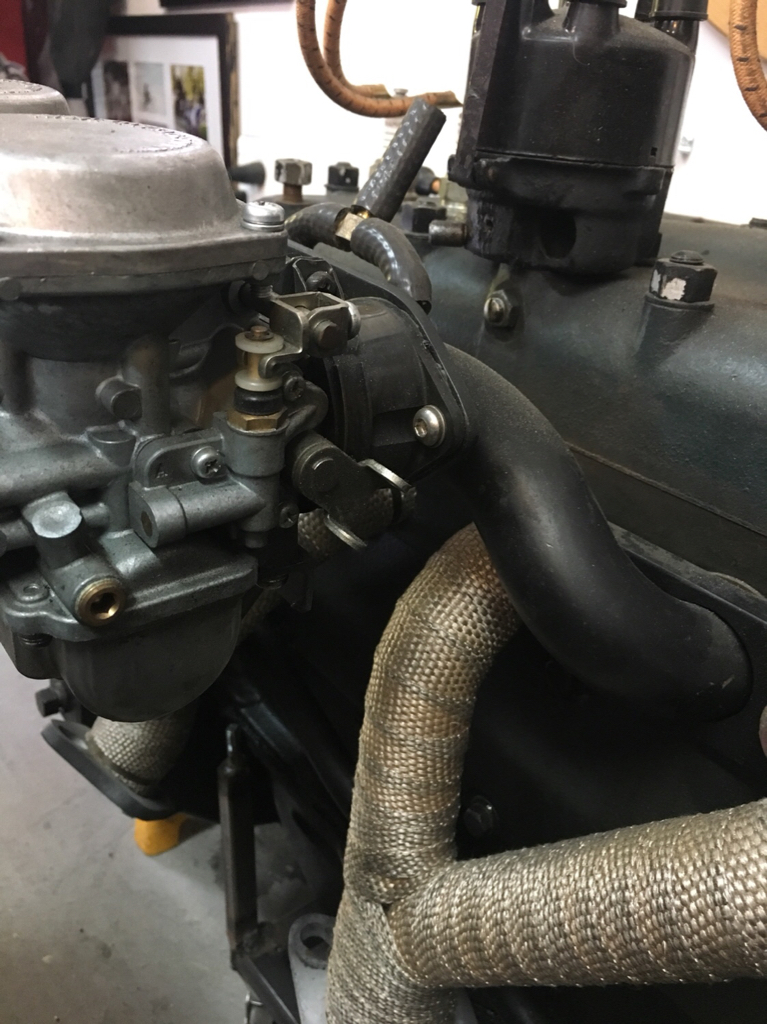

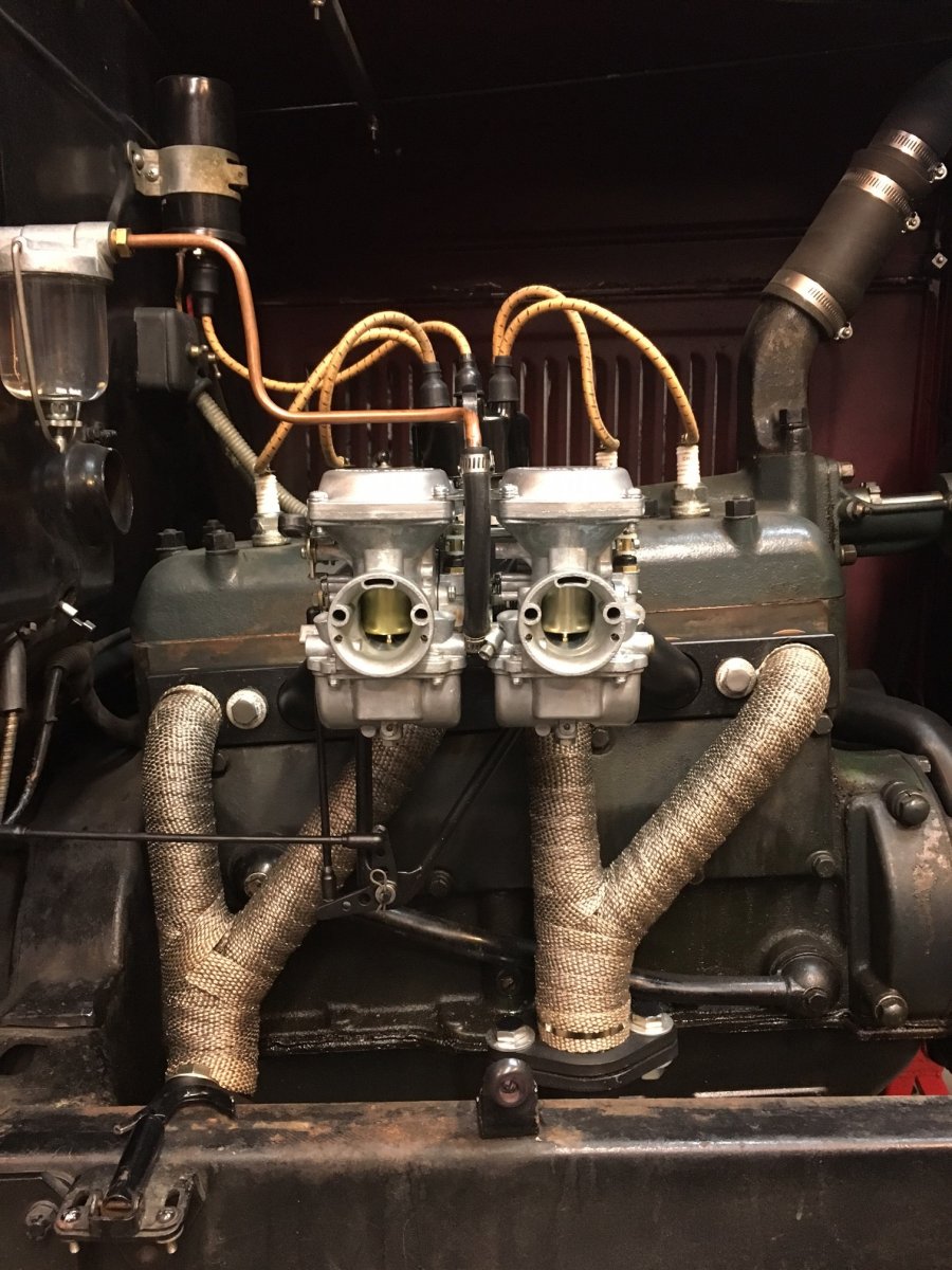

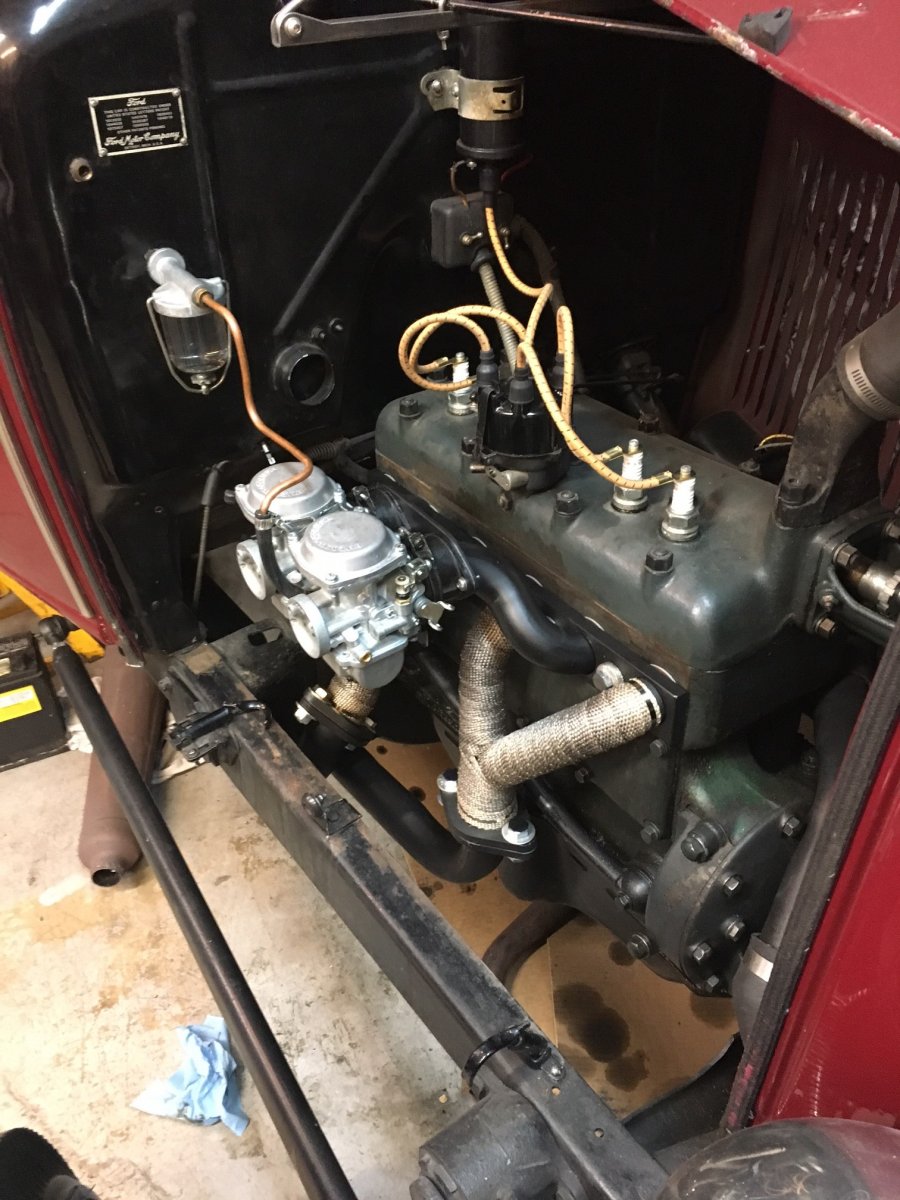

    Here are a few pics I just took for someone else that was also asking about it.[​IMG][​IMG][​IMG][​IMG]
    The engine is no longer in the car.
    I went a different route with the Tudor this last winter. Still banger, just a bit different.
    This drivetrain is now waiting for the start of a Turtle deck T project that I am planning.
    barrnone50 and Dannerr like this.
