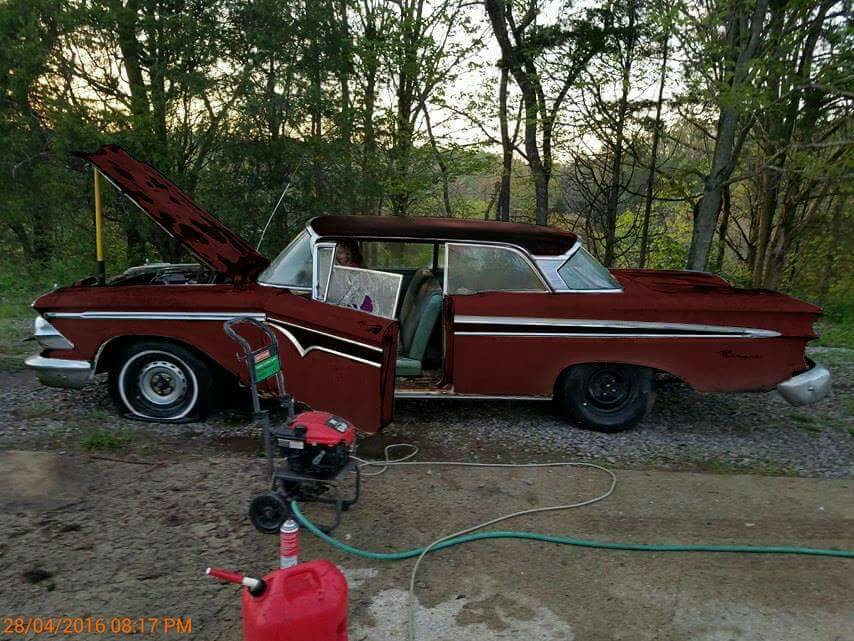

    Found a another product to let the 361 soak in. The crank had the tiniest of movement today. So I will keep soaking it. Even if I do end up pulling. I'll rebuild it later to go back in.

    I added some atf to the cylinders two days ago and pulled the rocker arm assembly to make sure a stick valve wasn't keeping it stuck. Have four stuck valves on the driver side. Gave them a little tap with a block of wood and doused them with pb blaster. Today we put a bore scope camera in the cylinders. Surprisingly they weren't all that bad. Check my stuck valves again and the got a little more movement. Also got about a inch of movement out of the crank also. So I sprayed it down again. Looks like it might be coming back. I have the rockers completely emerged in evapo-rust.

    I get what your saying squirrel. I figured having it freed up would make it easier to rebuild. The father in law seems think she might run again. So I'm inclined to humor him as he is a pretty knowledgeable guy and has had success with such ventures in the past. I get I'm taking a big risk but in the in it may just get replaced or rebuilt.
