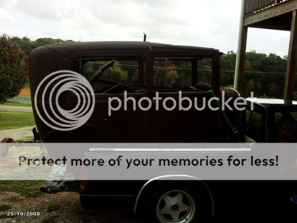

    I've been snowed in here for a couple days so I decided to show what I've been working on for the last year or so. It's a 30 A sedan I picked up in knoxville tn. [​IMG] It was in pretty rough shape when i started. [​IMG]

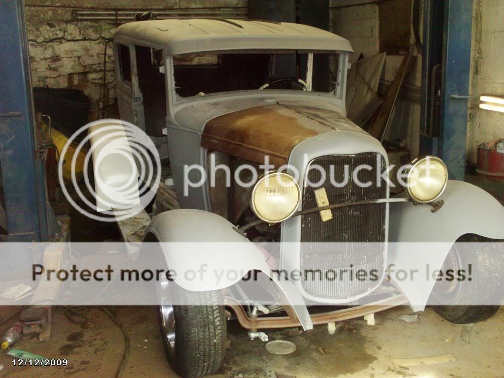

    wich brings it to where I am at now, waiting for the machine shop and the glass shop. Hopefully by the time I get it back from having the glass installed I will have the hemi back and assembled so I can redo the motor mounts. Then i will be able to get the body off and finish dressing up the chassis and paint it. I'm hoping to have this thing on the road by spring [​IMG]
