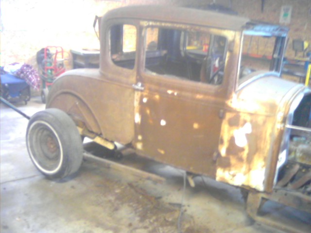

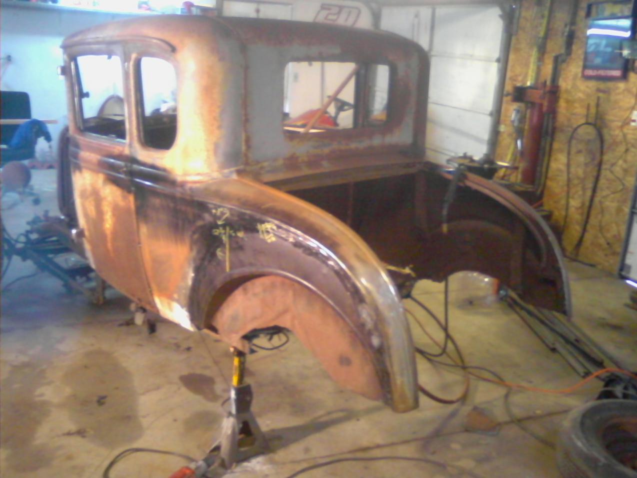

    Hello everyone. I've been around the Hamb for quite some time now but I don't say a whole lot. I've always wanted a model a coupe and got tired of working on race cars every week so I put the race cars up for sale and set out looking for a model A.
    I posted a little while back one of those "what's it worth threads" about a model A I had found locally. I bought the car against my better judgement, and boy is it rougher than I thought. So for those of you that said to wait for a better start I should have listened. Too late to turn back now though. I've got the car home and been ripping and tearing for about a month now and thought I'd show where I am now.
    Where I started

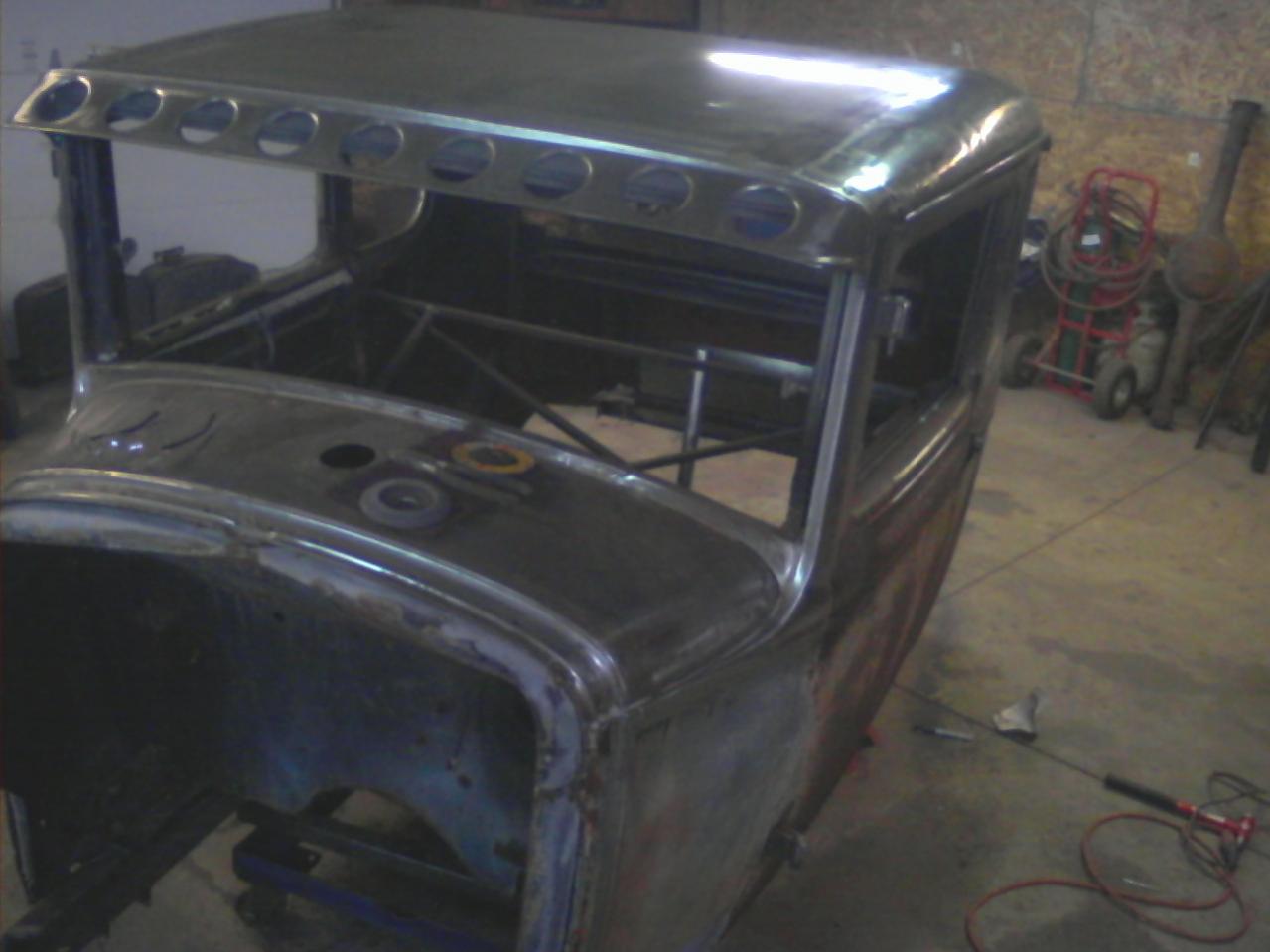

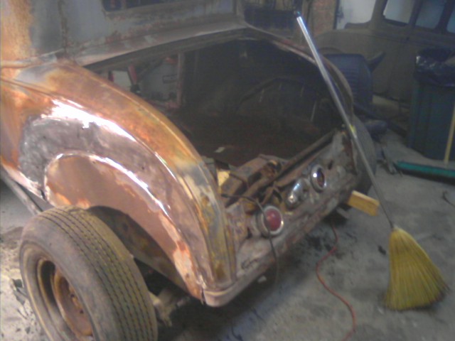

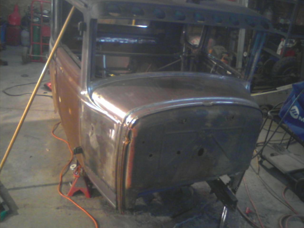

    Where I'm at now I've got the r/h quarter replaced, l/h wheel lip welded in, all patch panels have been ordered, the doors swinging nice, the body has been squared up and braced with tubing, the wood has been replaced with steel, the windshield frame is fit up and swinging, the panel behind the visor is in, the visor is drilled ( I'll do a tech on my home built dimple die soon) and welded on, roof support bows are in and the roof filler is tacked in,the left hand wheel well is welded in, and I'm starting to fit up the deck lid and rear panels now.

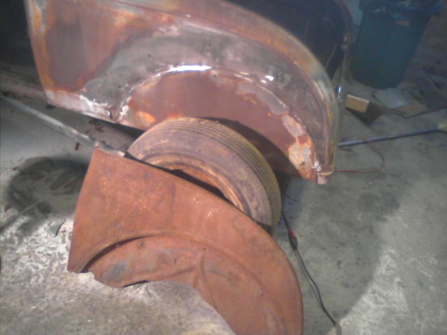

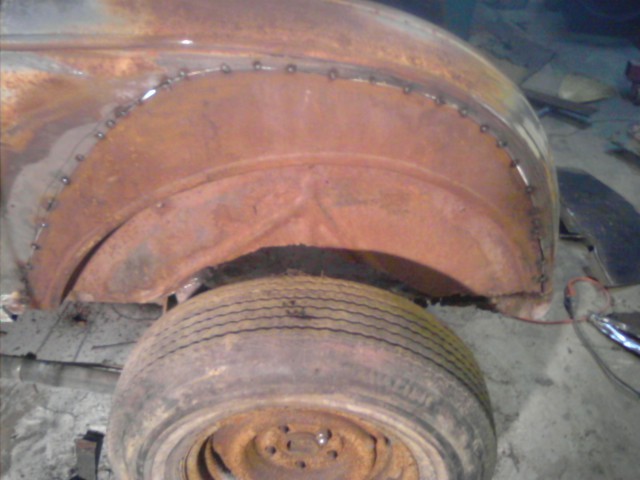

    The car was hit way harder than I had thought the rear end is even bent. The wheel well openings were plated over from body line around the opening straight down with 1/8 steel and welded in one pass warping the hell out of them then fiberglassed in. The frame is rusted and bent, even the rear crossmember is bent.

    Looking good, what sized holes did you drill in your visor?

    2 3/4 inch I made a die to dimple the holed out of a couple of bearing components. I'll post a seperate thread on that tomorrow.

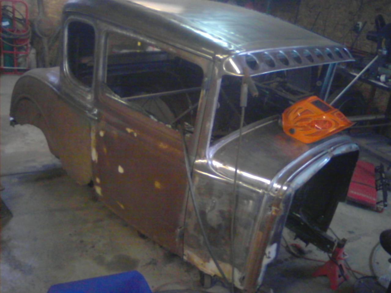

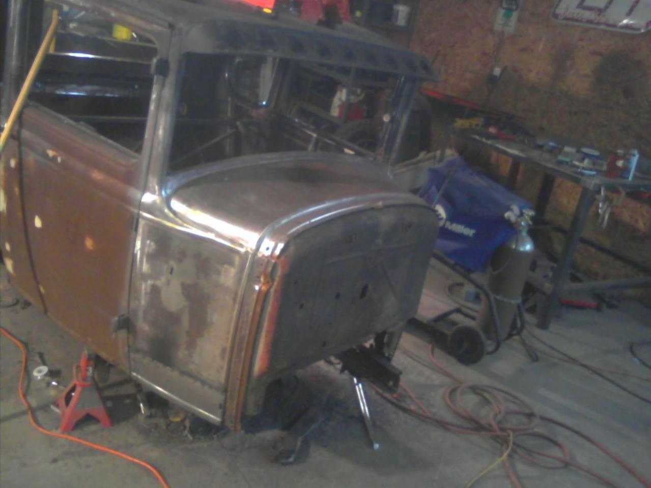

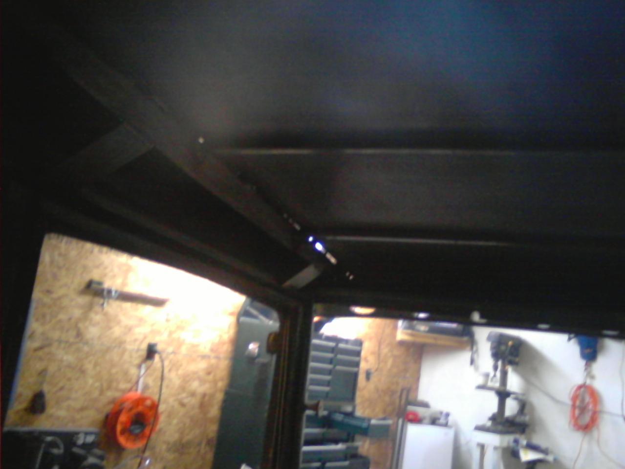

    Had a couple days off this week and was able to spend some time in the garage. Cut the front end off and worked mainly on the roof.

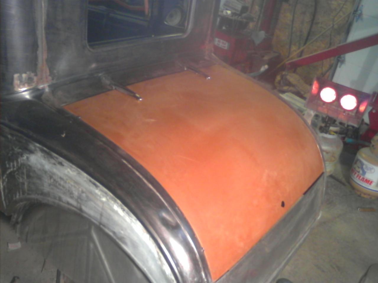

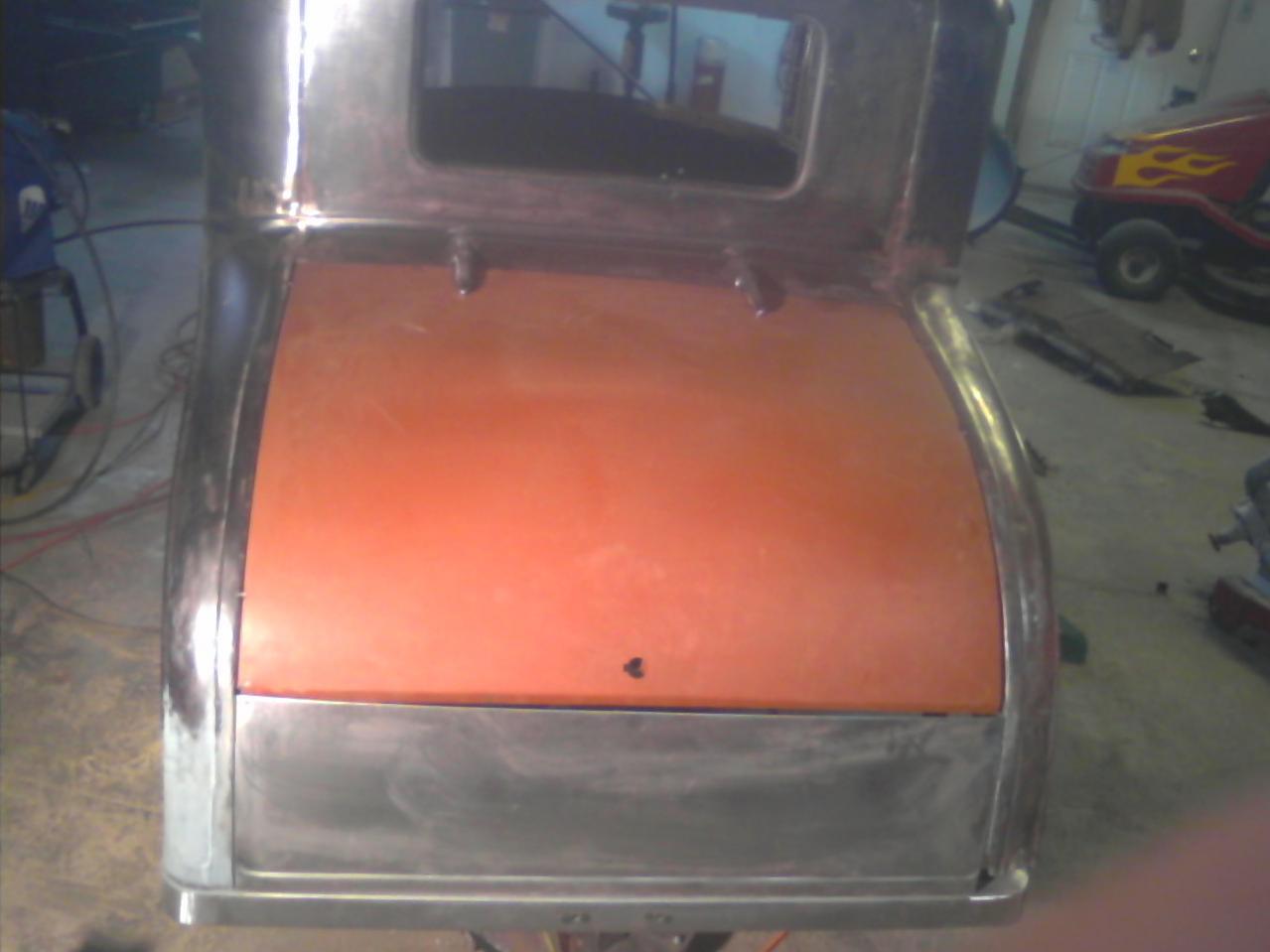

    Made a little more progress over the last couple weeks. It's been pretty cold to be in the shop so I re-modeled the living room. I plan to hit it hard over the next month. Couple of progress pics sorry for the shitty cell phone pics, gotta get a new digital camera.

  14. A Chopped Coupe
    Joined: Mar 2, 2004
    Posts: 1,133
    A Chopped Coupe
    Looking really nice, and love the hinges on the trunk............Great Job!

    Thanks means alot coming from you! Your coupe is absolutly gorgeous to me, probably one of my top 3 in my mind! I'm kinda modeling my build after your coupe, I plan on a color very similar to yours. The hinges are 37 ford. I've been kind of on the fence between them and humpback hinges like Mr Ford used.
