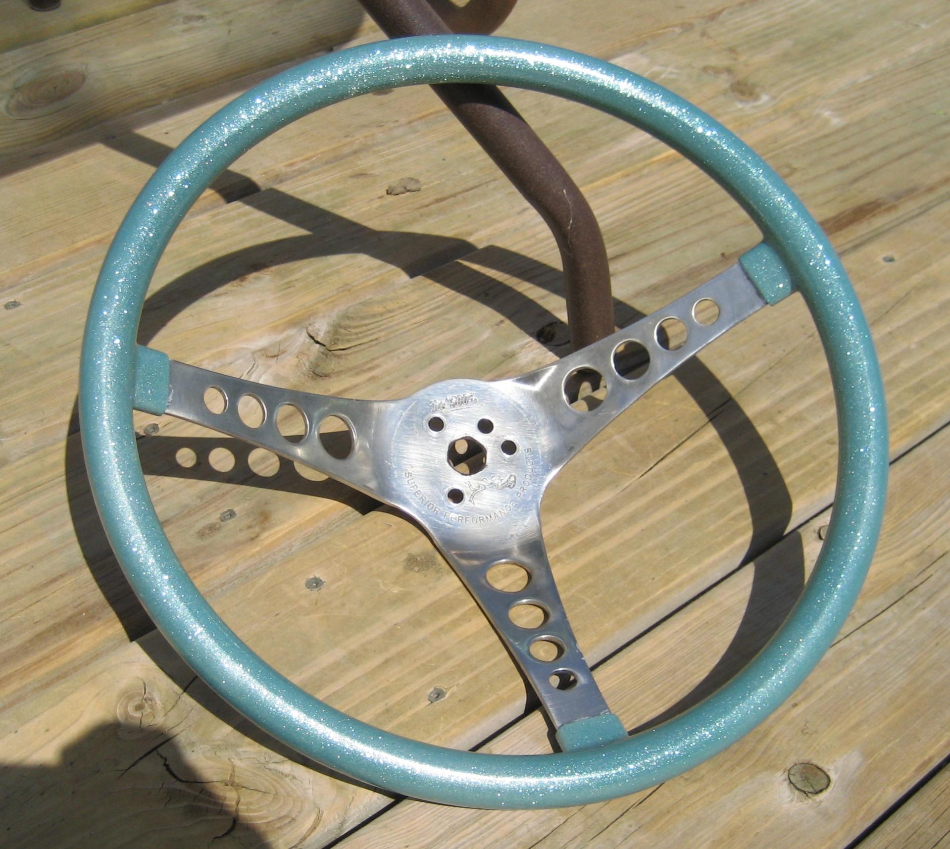

    I recently saw a post about Krylon Glitter Blast paint and thought I would try it out. I bought a black 500 wheel for 5 bucks at a swap meet. The chrome is kinda cheesy but its perfect for experimenting. I've been looking for a turquoise wheel for my turquoise 67 Plymouth wagon for a few years now and thats the hardest color to find let alone a good one.
    I went to Hobby Lobby and as luck would have it the paint was %50 off that week. I got a can of "sparkling water" and a can of the recommended clear coat. I first painted the wheel with Krylon bright silver to bury the black. After a test spray I found the sparkling water didn't have enough turquoise in it to suit me so I then shot the wheel with a coat of early Chrysler turquoise engine paint that I had left over. After that I gave the wheel about 4 coats of glitter paint and then buried it in clear. I used the whole can of clear.
    I'm not sure how well the rattle can clear will hold up but time will tell. Because of the dull chrome I will probably use this as a wall hanger but it turned out very nice and I will be finding another wheel to do for my wagon. The things I learned is take your time, use many light coats and probably use an automotive clear for durability but other than that this stuff looks great for small projects like a steering wheel or helmet, etc.

  4. I tend to think in daily- driver terms, so I dunno how this heavy flake/ lots of clear would hold up in my (semi desert) world. Let the metallic coats 'gas out' between coats for added durability on these 'flake jobs. Be patient. I've had jobs that looked great for 8 weeks, until the drying process moves into 'cracking' the clear coat. Too many coats too quickly laid on.
    Thanks for post, I gotta wheel to restore in near future. I'm thinkin' low- buck faux mother - of- pearl/ body colour combo.

    Thanks a bunch Larry! I know I'm sounding biassed but I was blown away by the results. I'm sure that alot of time in the sun would turn it brown like the originals you find at swap meets but for a cruiser that is not outside all day while your at work it looks like it would be fine.
    And as Eppster said..........Pictures don't do it justice. The flake is really alive !!

    Is it a hard plastic grip, or is it vinyl or rubber? On a hard grip, I could see this holding up, but on a flexible grip, I think it'd go to shit after very few miles. Just curious, looks nice.
  17. straightaxle65
    Joined: Oct 13, 2007
    Posts: 532
    straightaxle65
    Its a hard plastic grip. I cleaned it real good with thinner before I shot it.
