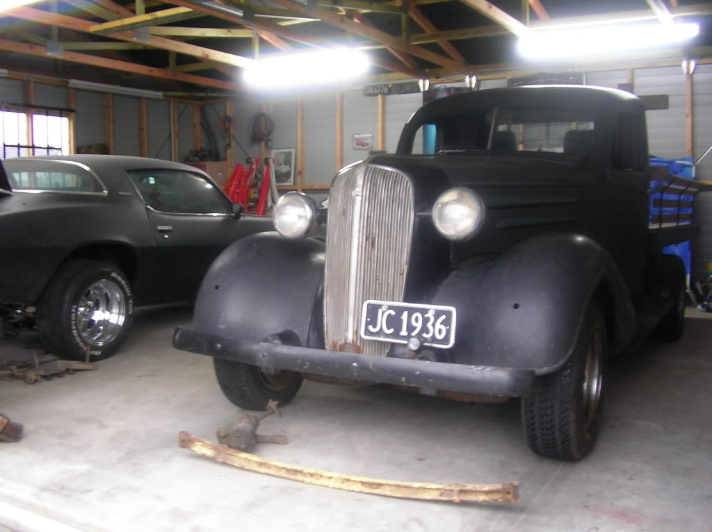

    I like looking at build threads so thought I'd share mine. This actually started a couple of years ago, and progress had been slow, but it's time has come.
    A little background....I owned this pickup about a dozen years ago, sold it, saw it for sale at a show/swapmeet about four years ago and bought it back. It was a bit of a sentimental/impulse buy but before I knew it this ugly duckling was back in my shed. At the time I was playing with another car, so this one waited it's turn. That gave plenty of time to think about build styles, and when a freind suggested a gasser style build, I was sold on it. I've always liked blowers and bigs and littles so it didn't take much selling :D. The pickup is a 1936 Chev, but built on a car platform. I don't know for sure how it started life, but have it's rego history from brand new in '36 in New Zealand and it's regoed as a two seater commercial vehicle. It also has unusual doors, with a beltine that ends in a spear, and no 1/4 windows. Anyway, follow along if you want.....and for any gasser haters, there are plenty of other threads for you to read on this wonderful website.
    The start...
