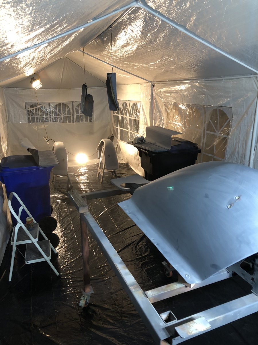

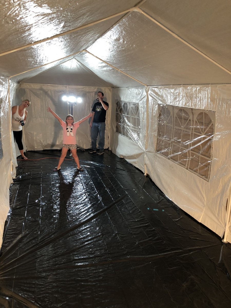

  22. Great job, how did you ventilate that tent?

  24. JohnnyCASHcadillac
    Joined: May 9, 2007
    Posts: 429
    JohnnyCASHcadillac
    from SO CAL-
    I made a box with 2x4’s. Then bought a house furnace filter stapled it to the box. Put that at one end and a fan at the other.
