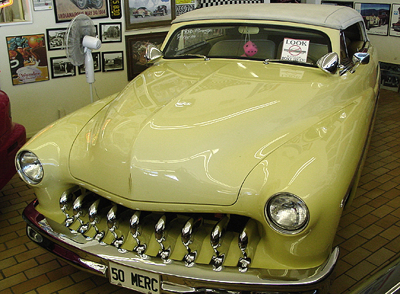

  5. Path howwdy!
    Some grills pics... I know they are hard to find here but who guess...
  6. Thanks for the pics sergia haha :D
