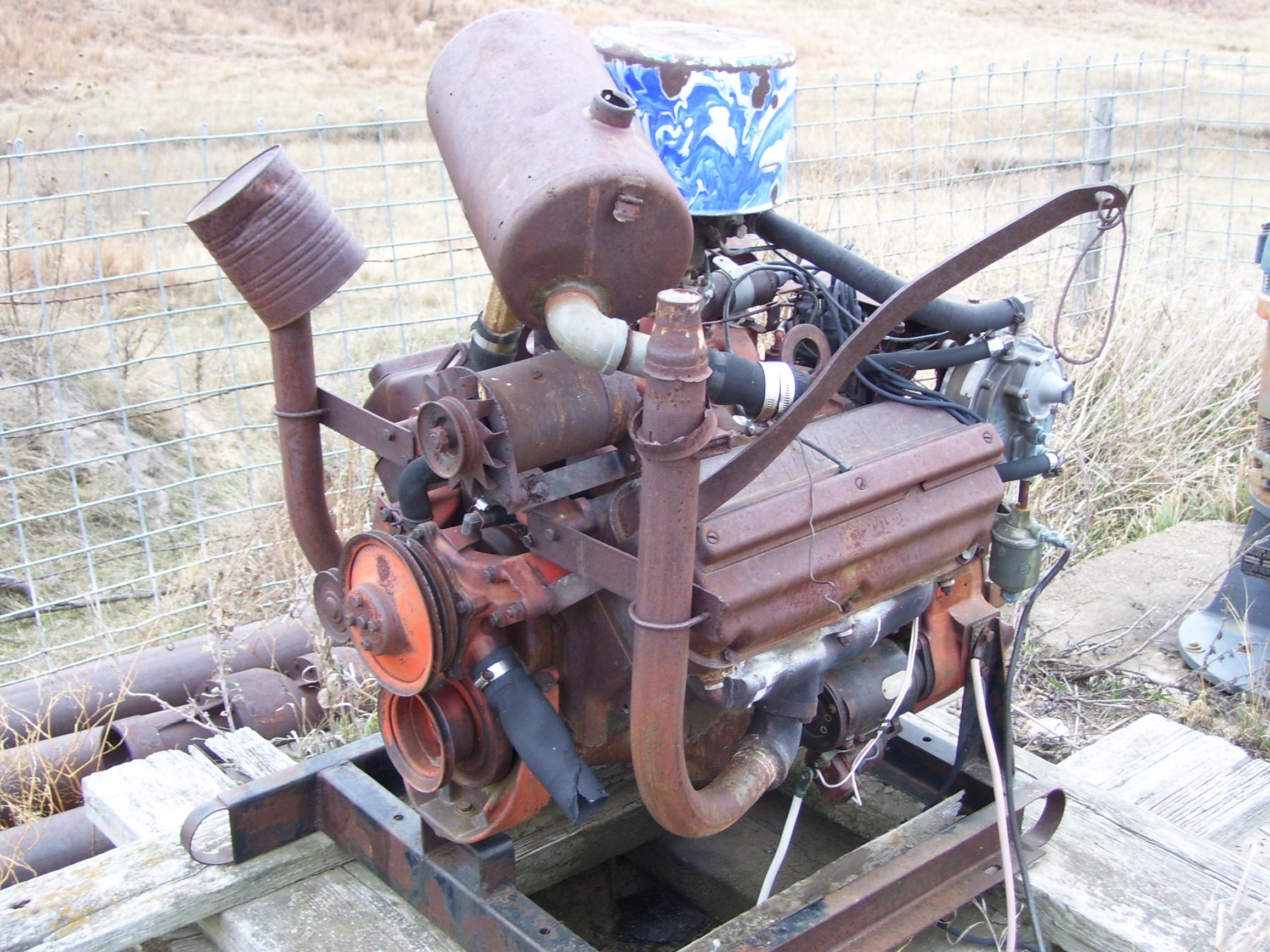

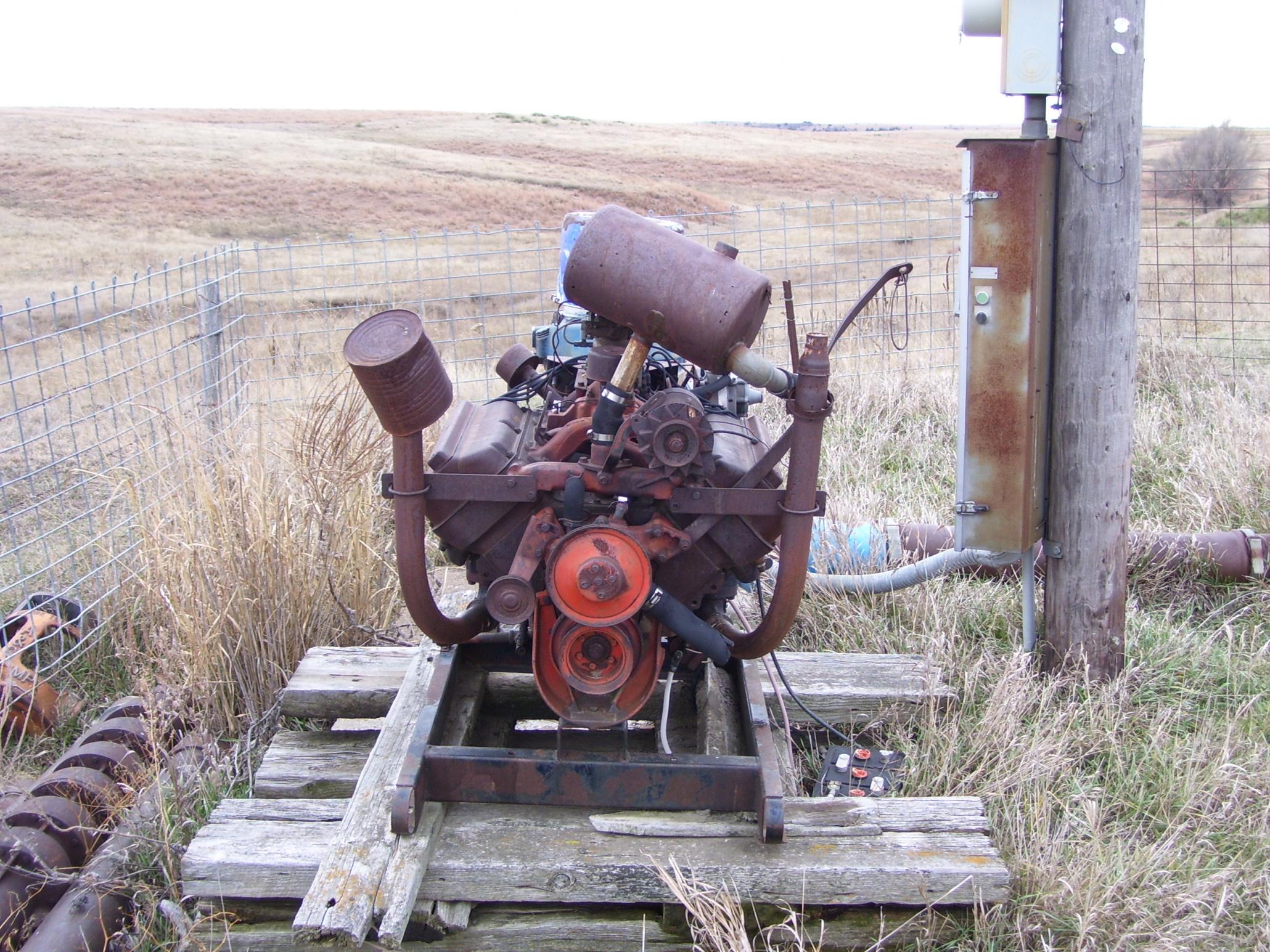

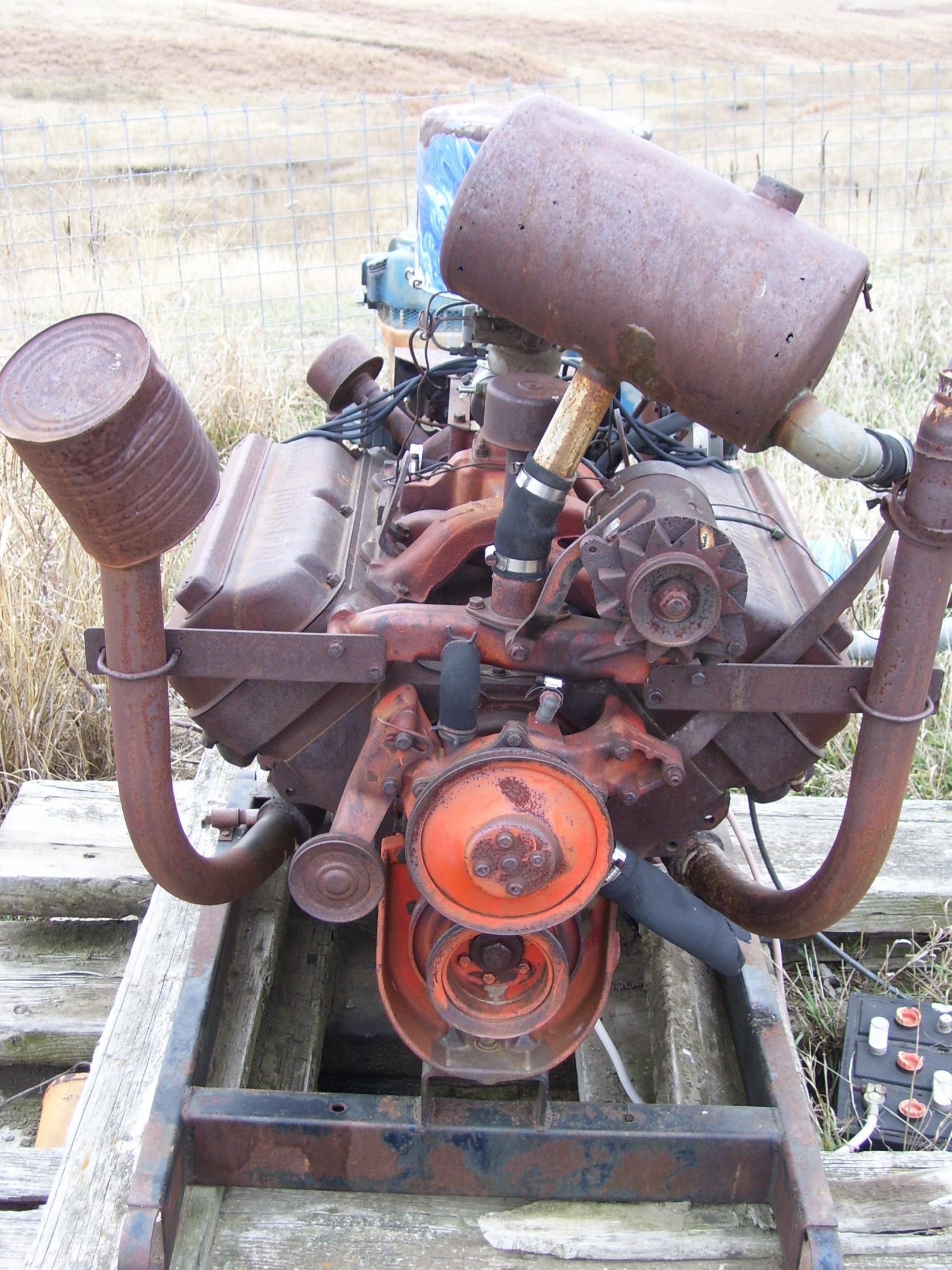

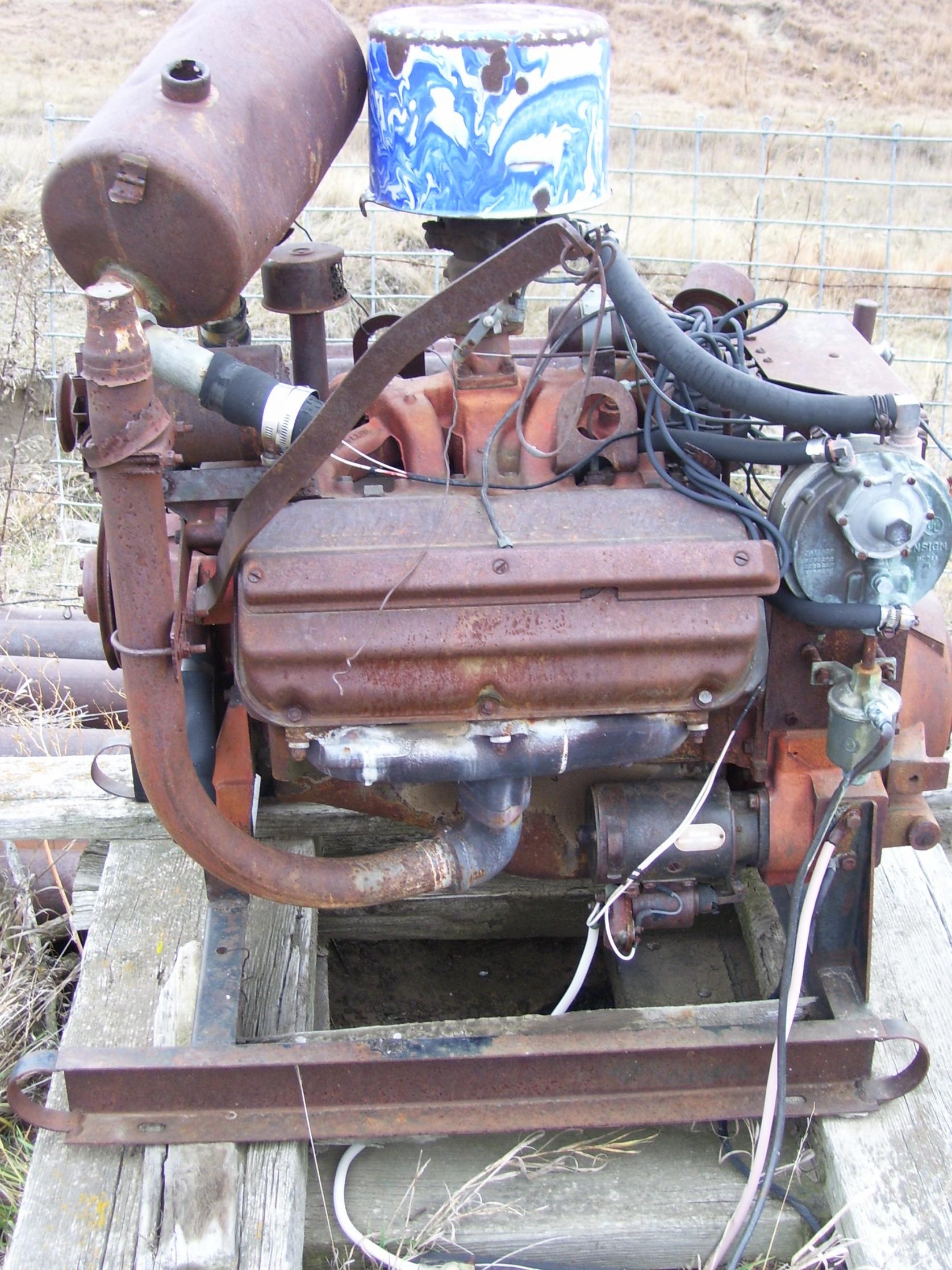

    I need a little help. I have always been a small block guy and dont know all that much about Hemi motors. This past weekend I went home to deer hunt and was driving around my uncle's pasture when I discovered this motor. It is an old irrigation motor and was run on propane. It is complete, including a starter. My uncle says it ran great in 1971 when he quit using it. He gave it to me and is going to load it in my pickup with the skid loader the next time I get back home. He couldnt remember when he bought it, but bought it new. He also remembered changing the oil every week.
    I am assuming I can convert it to gas with a rebuild and it will work fine as a car motor? It is not locked up and I am really excited about it. Should I be? Or am I in for a disappointment? Thanks for any advice on it.

    If it was ran on propane all its life, its likely that its in good shape. I can't tell from the photos youve posted, but it looks like it might be a 331 with the longer bellhousing. Check the Hemi Tech here and let us know the serial numbers are once you get it home and in your garage.

    Looks like a 392 crossover and water pump on that mill. What are the stamped numbers on the block just in front of the valley pan cover? (behind the water crossover) Definitely has the "auto" type later heads on it:D. Nice score regardless

    Good catch on the water pump. The exhaust manifold is also a 392 piece...hhmmmm...;)
    Too much junk on the back to see much but it cannot have an extended block if the 392 wp bolts on as the front patterns are different.
    Allow me to clarify 'cannot'...NEVER say never with MotherMopar.:D

    Rocker covers say Industrial on them, might have yourself a solid lifter motor there. If you want, let me know where it is and I'll swing by on my way to South Dakota next week and check it out for you.

    I don't think anyone has reported solid cam in one, despite all of them having the bumps.

    Thanks for all the info and the links to the tech pages. I am headed back out tomorrow to hunt some more and will get the numbers off of it. In the 3rd photo I posted I can see the metal ID tag still on the motor so hopefully I will have all I need right there.
    I also talked to my uncle on the phone and he kept referring to the engine as 'that ol' 56A'. When I asked why he called it that he said that was what it was called when he bought it. When looking at the tech stuff an IND56A would be a 354 if I am looking at that right?

    The IND56A that he is referring to is not a casting number, it is the ID number stamped into the ID pad on the front rail ahead of the valley cover, and readable with the intake on the motor. Unless the propane motors had a different intake that blocked the view, but from the pictures it certainly appears that the stamped ID number should be visible.
