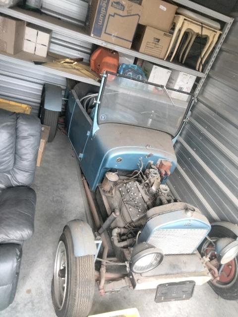

    Very new to old Fords, i'll be having some questions for sure. I need to positively ID the brakes and many other things so I can start working on it. This was sitting since 19 68 ? ( I'm in NW Washington State )

    I see a V8 Sixty engine, the front axle looks to be ‘46-‘48
    and I expect the brakes are ‘46 and up too, the brake adjustment on those is different than the earlier Ford hydraulics. Not sure looking at the photo but is that body fiberglass? Not that there’s anything wrong with that, just curious.

    It looks like it might be glass, but I can't tell for sure. V8-60. Late hyd brakes. Nice car!

    The PO 'thinks' it's a modified 47 or 49 frame.... I'll be posting more pics, and bugging him and ypou guys for more info so I get the right parts. He also says its an 'air cooled 60' which makes no sense. I think the fan went missing and he got very lucky it did not blow up... It does have shielding around the engine and aluminum intake and heads. I did some reading and the shields are from a one year only engine. I have a short parts list but there is always more. It was a Canadian Ford, the radiator says made in Canada, and he brought it to the US years ago. It looks to be all steel. I hate those fenders. What looks good on there?

    I'm no V8-60 expert he might mean it's a tin side 60 which is one year only IIRC.
    Edit: 1937 only

    It’s a 26-27 touring with the portion behind the front seat removed. If that’s a 49-ish frame it must be the rails from a truck, and they were highly modified. Engine is a 60 horse, not air cooled, and from what I can see it has finned heads and something weird going on with the lower water outlets. If they are coming out the sides of the block it was probably an engine built for a sprint car.

    '26-'27 T Touring front half. More photos will help ID the exact year.

    I know I need wheel cylinders, hoses and need to ID the master cyl, it is from some other make and says BRK for one resevoir and Clutch for the other one. Probably needs water pumps. The trucks had more impellers, yes? Will those work on an early 60 ? I assume those carbs are 92's and probably need kits.
    I don't have a good pic of the water outlets, but it looks like they come from the front of the block.

    60 water pumps are a whole different animal.

  19. Brakes are from '39 to '48 (wheels are '40-'48 bolt pattern). Post a picture of the 6 o'clock position of the backing plates and you will get a response as to pre or post war. DON'T step on the brakes. If the cylinders are rusty you will jam them on and make it difficult to remove the drums. If the rear axle get the proper puller for the drums, it is easy to cause a lot of expensive damage without the correct puller.

    Spend some time on here looking at what makes this place tick. This place loves old hot rod finds exactly like the car you found. Don't rush to make any changes. Some crudeness is ok..its part of the charm and is indicative of when it was built. That car has been that way for an awfully long time...60+ years perhaps? It looks fairly well built..has a lot of cool touches. I just don't want you to make an irreversible change that you regret later. Probably has a set of Ansen swing pedals. Master cylinder is 1960-63 Chevy truck..

    Those front fenders are made from 36 Ford spare tire covers, cut in half. A very classic way to make small fenders back in the day.

    The water pumps for 60’s were kinda year specific. Built from 37 through 40, you will need to know what you have before you buy fresh pumps.
