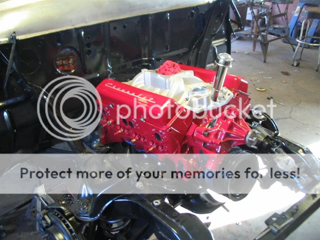

    Lord Purple
    Re that painted engine pic. I don't wanna be a smart-a**, but are you sure you want to run that shiny timing cover? They always seem to leak, I put a thread up on here a couple of years back as I had one and everyone advised me to stick to the steel factory part.
    Just a suggestion, absolutely everything else you've done is 110% if not more.
    L.P.

    Motor and tranny are in.
    It always feels good to get to this part.

    The engine in car and it looks verry good

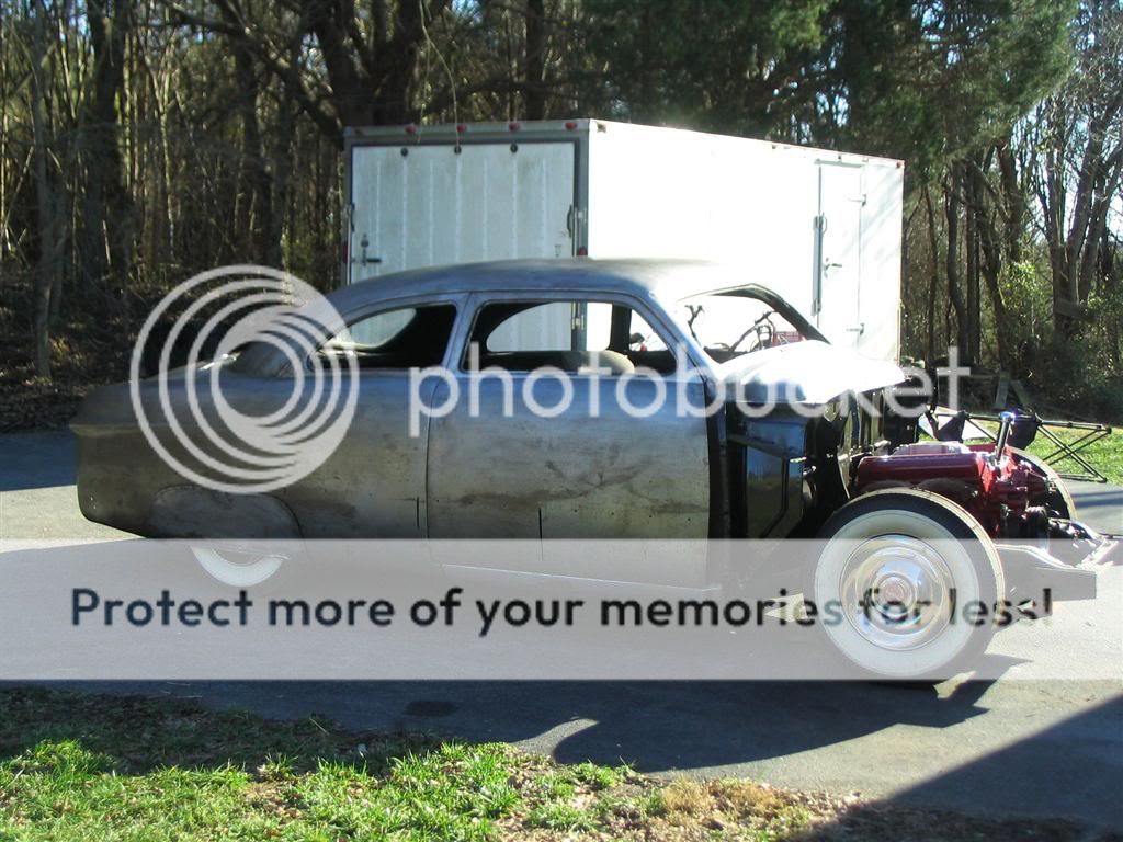

    I wanted to see how the car would sit, now that I had the motor and tranny in, and installed the dropped spindles/springs.
    So I rolled it outside to take a look.
  17. the-rodster
    Joined: Jul 2, 2003
    Posts: 6,674
    the-rodster
    I'm really pleased with the stance.
    It's not as low as some shoeboxes, but it should come down another inch or so when the front sheetmetal and bumpers are installed.
    Currently, I have 3 inches of travel at the rear, stock bumpers on the stock frame.
    I might go lower, I dunno.
    Next up, brake lines, gas lines, shifter linkage, etc.........
