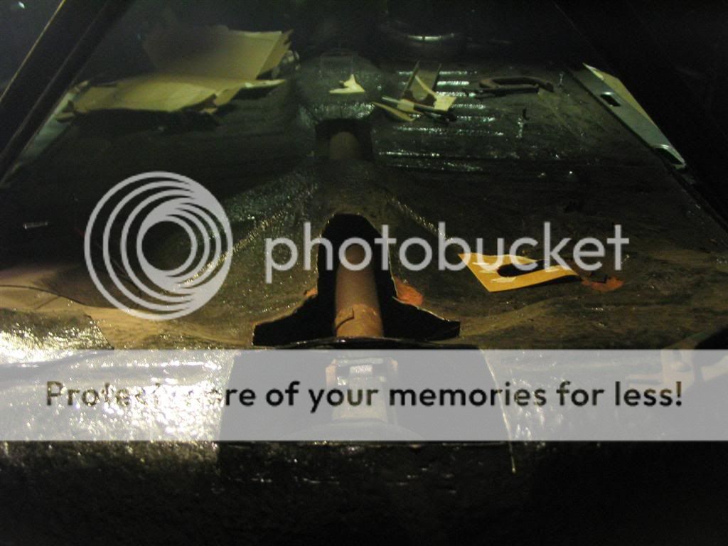

    I've been trying to tell myself that I wont' have to raise the driveshaft tunnel.
    But, after installing the driveshaft, and doing some measuring, I came to realize that half an inch of clearance, was just not enough.
  18. the-rodster
    Joined: Jul 2, 2003
    Posts: 6,664
    the-rodster
    It hurts my feelings to cut up nice floors......

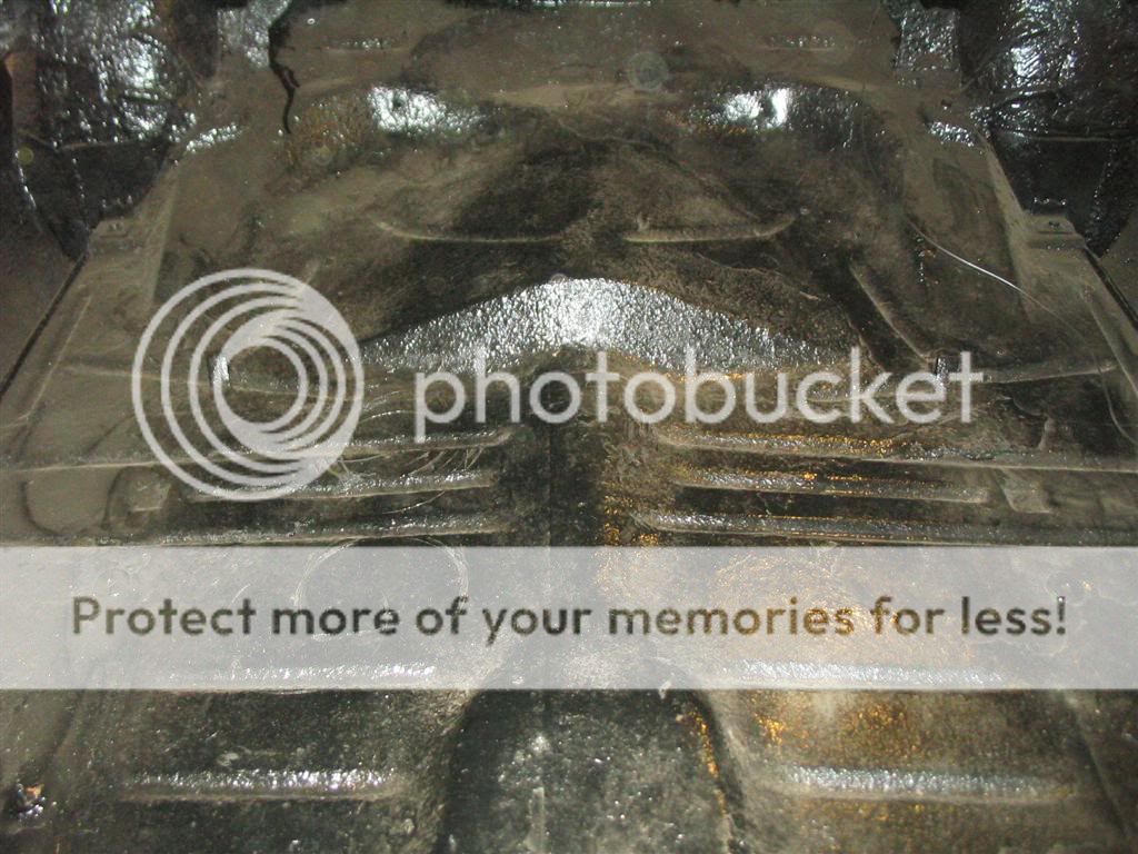

  20. the-rodster
    Joined: Jul 2, 2003
    Posts: 6,664
    the-rodster

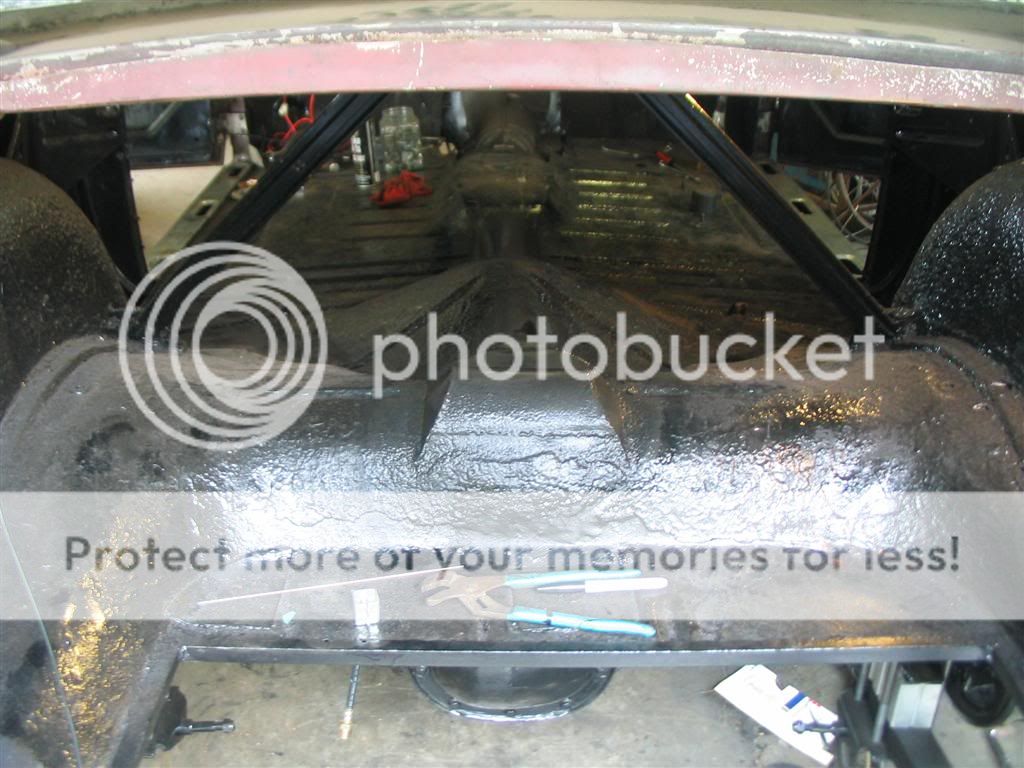

    I started at the back, and started fabbing a new tunnel, and bump over the rear.

    The crossmember under the seat also needed to be thinned out.

  23. the-rodster
    Joined: Jul 2, 2003
    Posts: 6,664
    the-rodster
    The bottom of the rear seat needed some modifications to clear the new tunnel.
  24. daddio211
    Joined: Aug 26, 2008
    Posts: 5,998
    daddio211
    My wife sees an evil face in this picture.... With gills! LMAO
  25. the-rodster
    Joined: Jul 2, 2003
    Posts: 6,664
    the-rodster
    Tell her to put the bong down.
