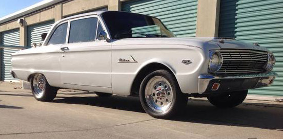

    I got rid of the 64 Falcon Wagon and picked up this 1962 Falcon Coupe. It is a nice driver, but it just looks like everybody else's car to me , so I have decided to make it into a Gasser. I am going to go my own way as far as interpretation of what a 60's style gasser would look like today, so some folks might not be too happy with my version, but that is what is nice about our hobby, everybody can do what they like and if it makes them happy, screw everybody else.
    I have already used several tips from the different build's on this site to get myself started, I bought the 4" dropped axle from Speedway, 48" wide with the springs, steering and Wilwood disk brake kit. I also picked up a tunnelram with rebuilt carbs on Ebay for my 289 motor. I am going with Summitt racing Pulsar wheels, look allot like Ansen Slot mags and Mickey thompson SR tires front and back, the slicks will have to come later.
    Everything has been shipped and should be here by the end of the week, then me and my chassis guy will get started, I hope. I'll try to post pics when I can to let you guys help guide me if I go too far out there, but It might end up just going my way no matter what. So, I hope you will enjoy "ANOTHER" Gasser build as much as I will.
    I've included what my car looks like now, the parts that I have and a "rough" photo-shop version of what I'm thinking, but I have already strayed from the whitewall slicks, I just don't have it in my budget right now to do those.

    I like the before pics A LOT more, very cool car as is. Throw a hot SBF and a 4-gear in it and leave it. Even the weld wheels look good.
    Tunnel rams and white wall slicks are two completely different eras that should never collide...pick a year and stay true to it. None of this all inclusive 'modern gasser' BS. Just my .02.

    #1 - thats a great looking hot rod now - use the tunnel ram if you must but don't butcher the car - sometimes less is more
