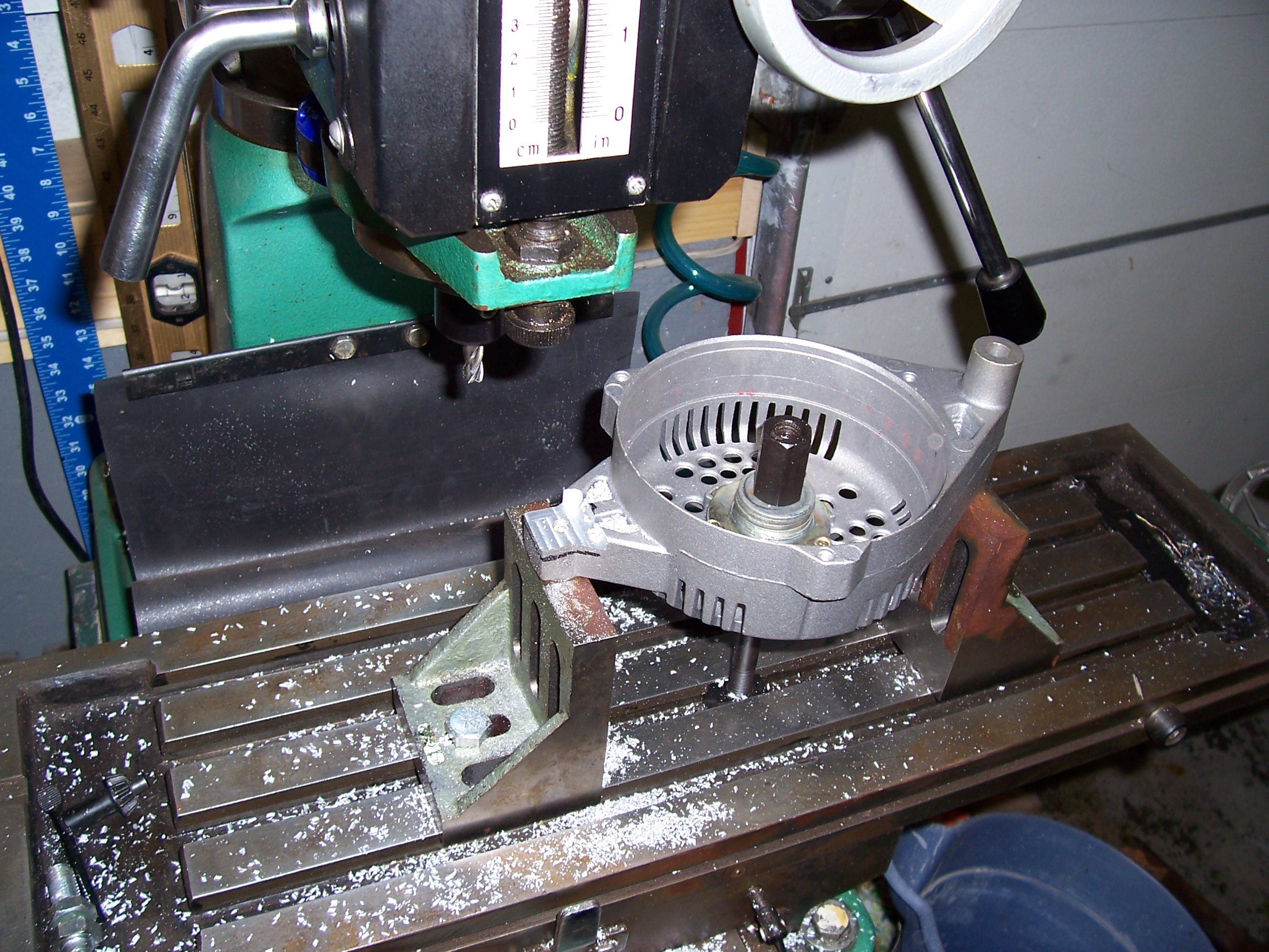

    I'm using the factory 1990 serpentine drive, and wanted to use a newer 3g alternator (Ford 1 wire). The best fitting one I could find (96-ish F150 130amp) still needed the ear trimmed to get it to fit. A little more paint and here it is.
    Distributor is a Pertronix, valve covers are vintage Cal-Customs.

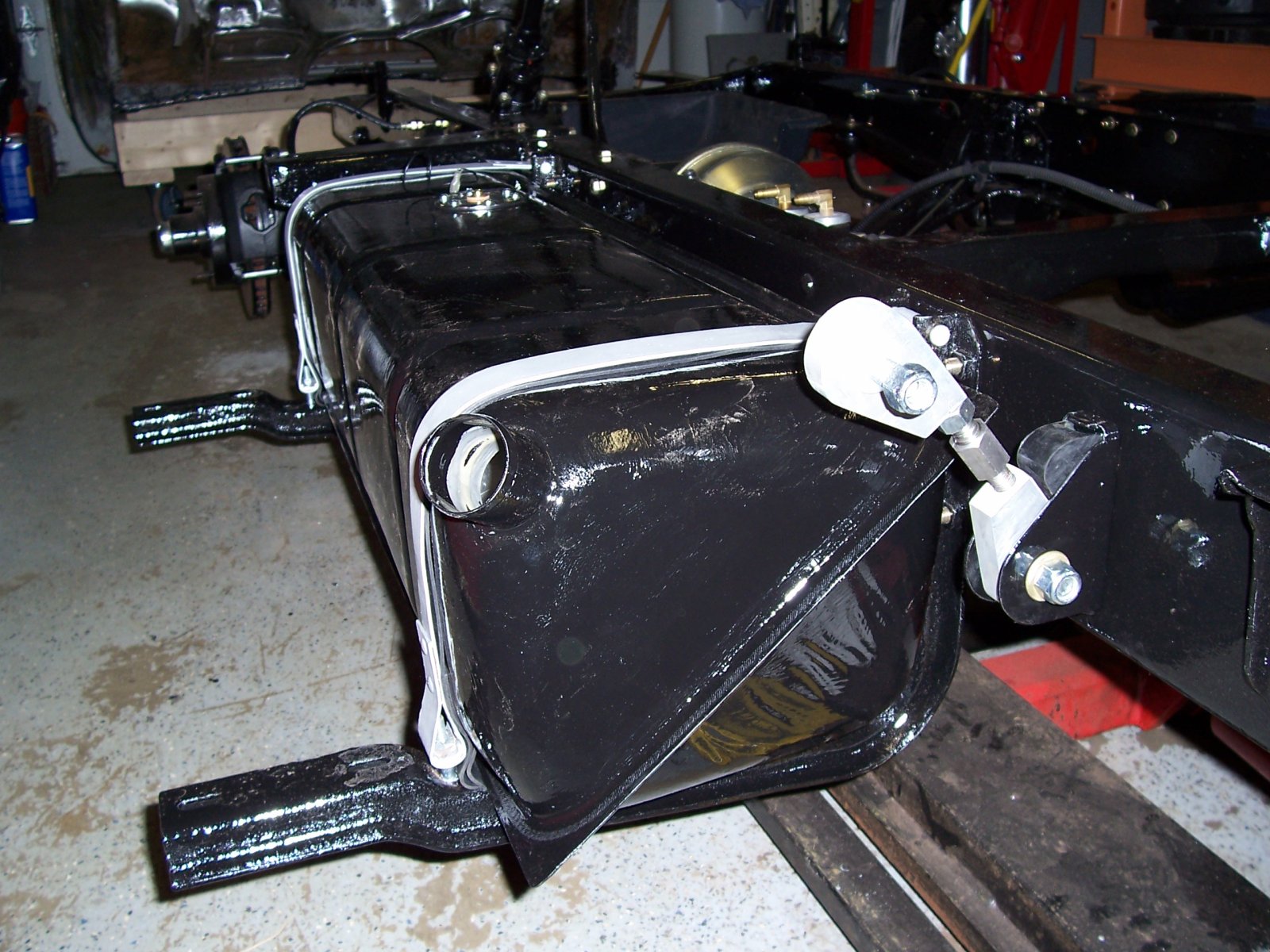

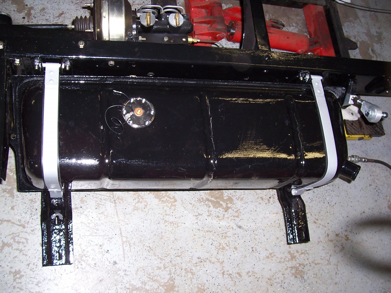

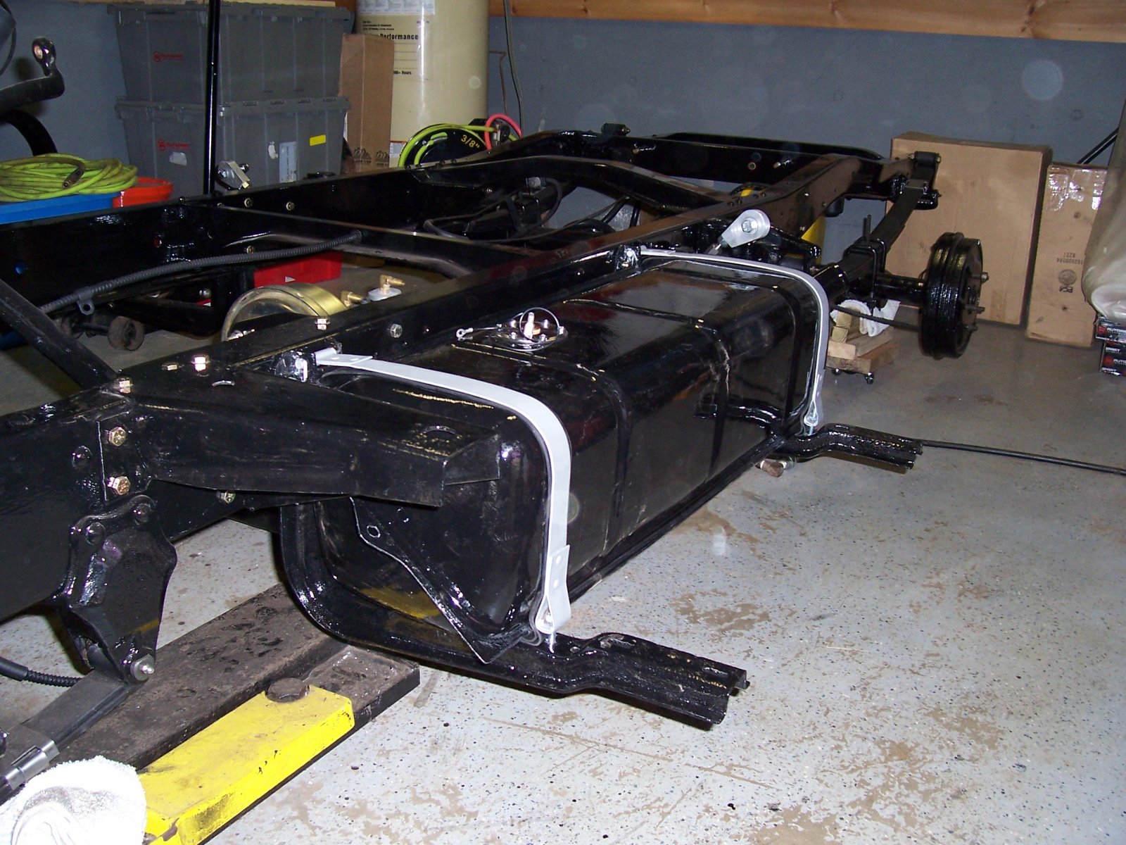

    Got the new gas tank in, and temporarily mounted to cab.

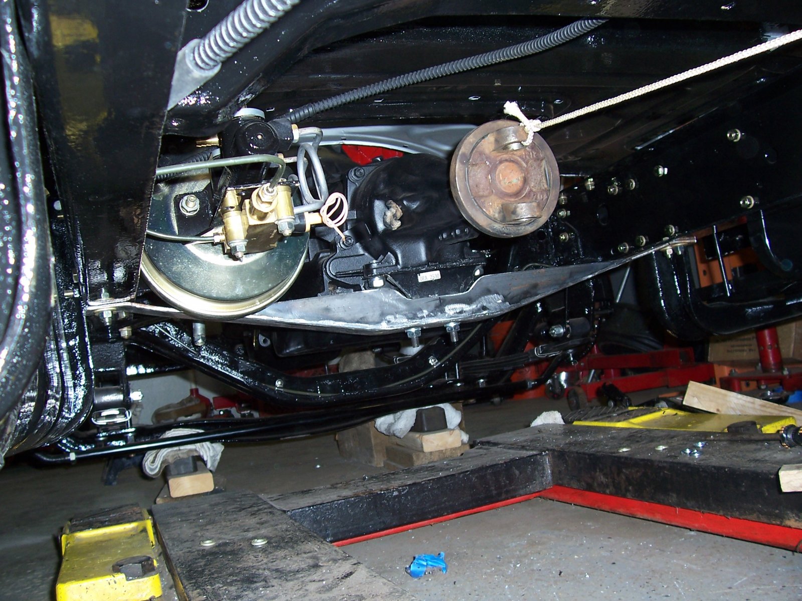

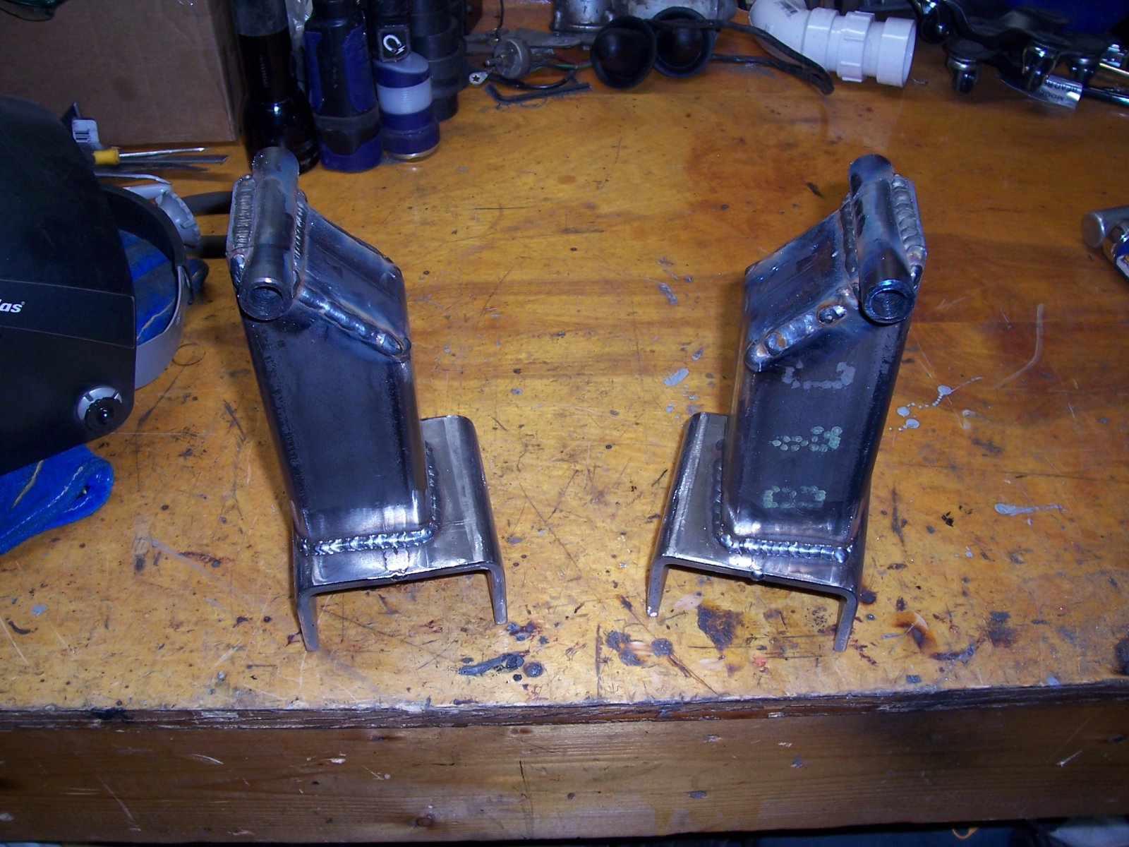

    I made a trans mount based off the ones you see in most of the catalogs. Probably should have just bought one but I already had the steel and didn't want to wait for UPS to start my engine mounts.
  17. windsurf88
    Joined: Jan 24, 2012
    Posts: 107
    windsurf88
    Finished up the transmission mount. Test fit it, a little paint, and its in.

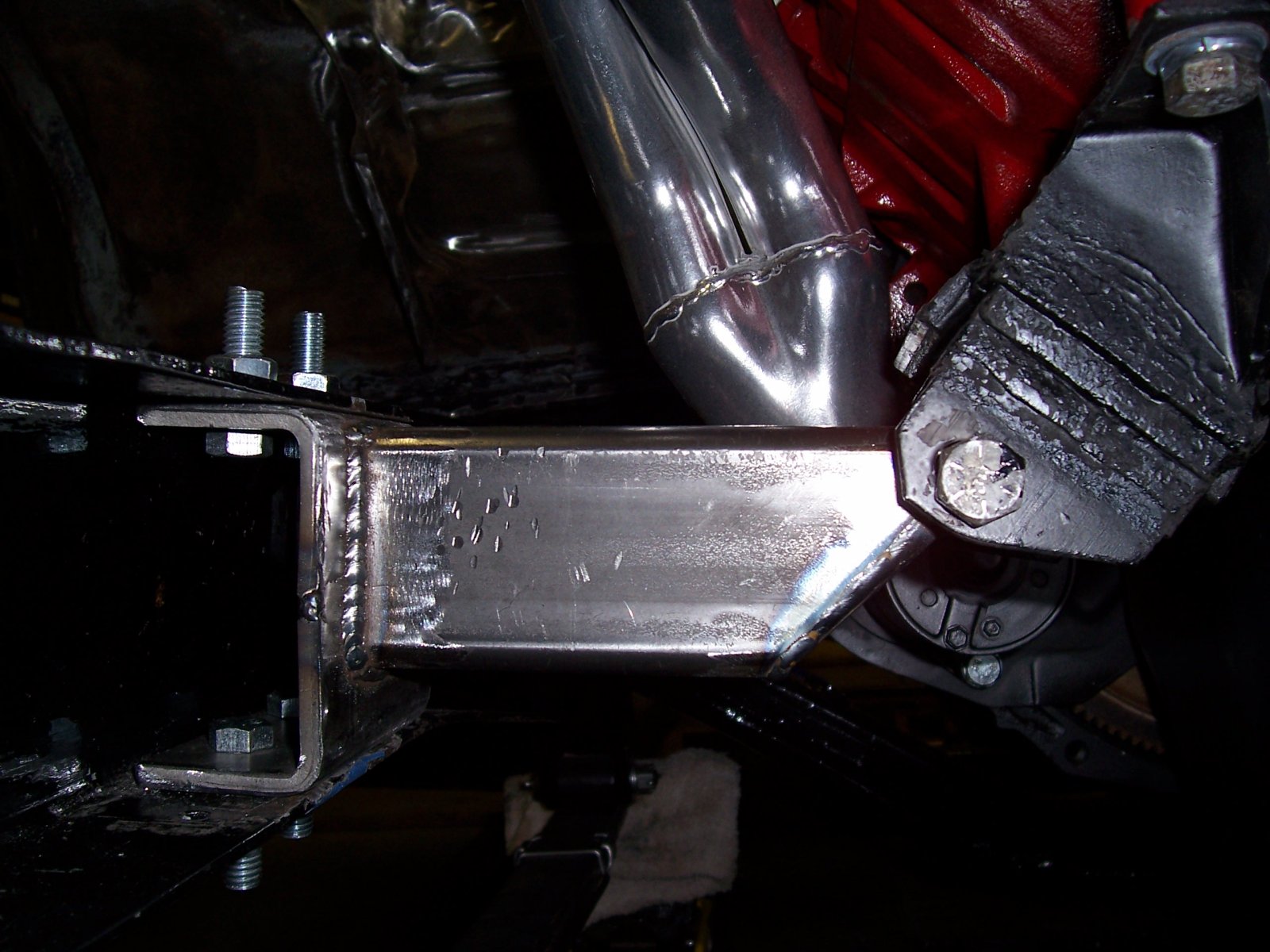

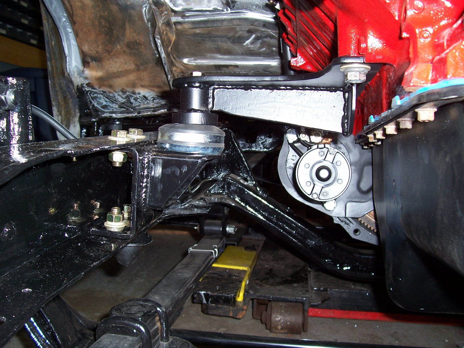

    Here is my first attempt at engine mounts. After installing I found that the pivot between the stock style mount and my long frame arm allowed the frame to twist in a little at the top.
  19. windsurf88
    Posts: 107
    windsurf88

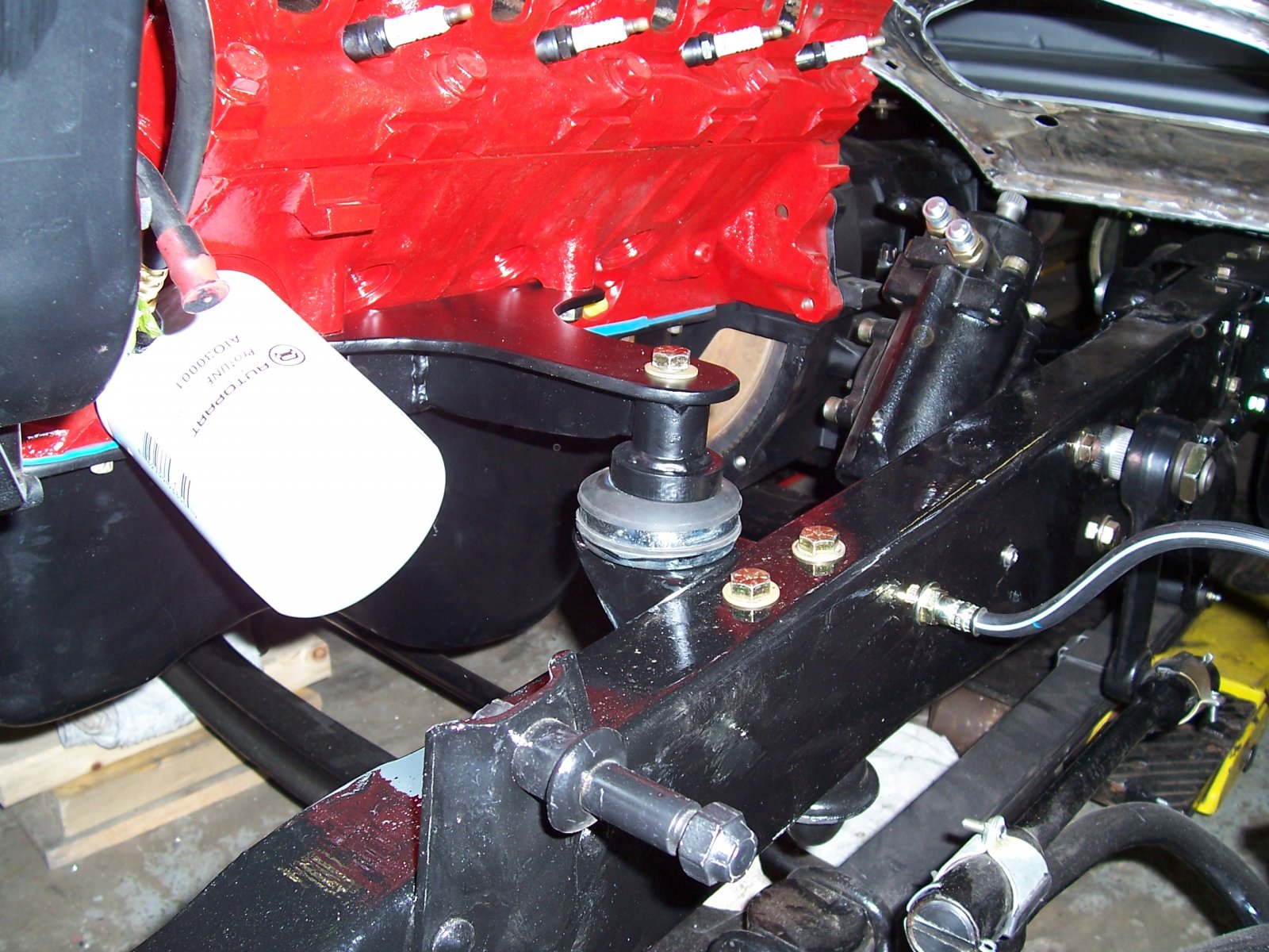

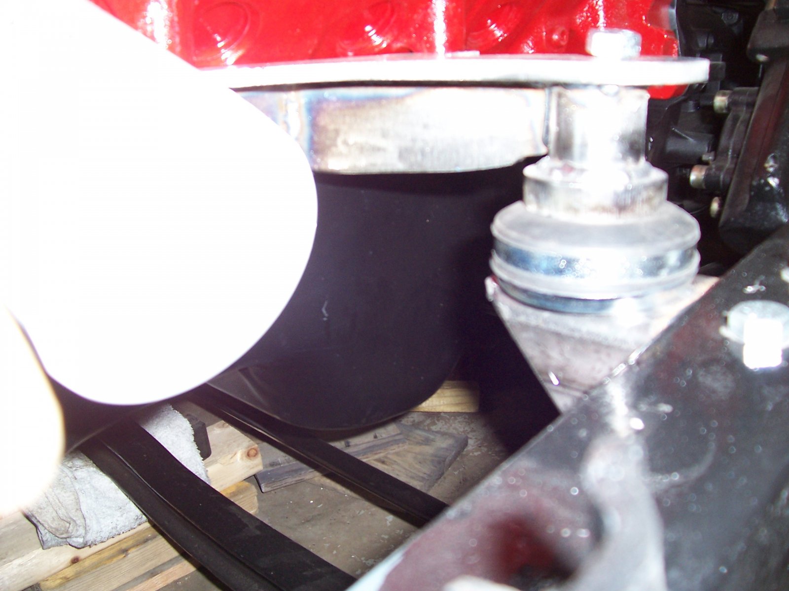

    I decided to try some flat head style mounts and made mounting brackets that stick out from the engine instead of the frame, I cut back my first arms to work as perches for the mount. This set up puts the weight of the engine is on top of the frame.
  20. windsurf88
    Posts: 107
    windsurf88
    Painted them up and my engine is officially mounted in the frame

    Great work on those mounts' position. Excellent gusseting underneath, I also see you left the stock F100 center crossmember in.
    Some 'experts' saw mine was still in there, and enlightened me with "You didn't have to leave that member in there..." I laughed, and said, "Take yours out, then..."
    I moved my engine back and the steel lower flywheel cover is still easy to get in and out.
    As Gene Boul suggested, I also have a 9" rear, out of a '60 pickup. 3.00 ratio, one legged...Nice, as the saddles lined right up with my rear springs.

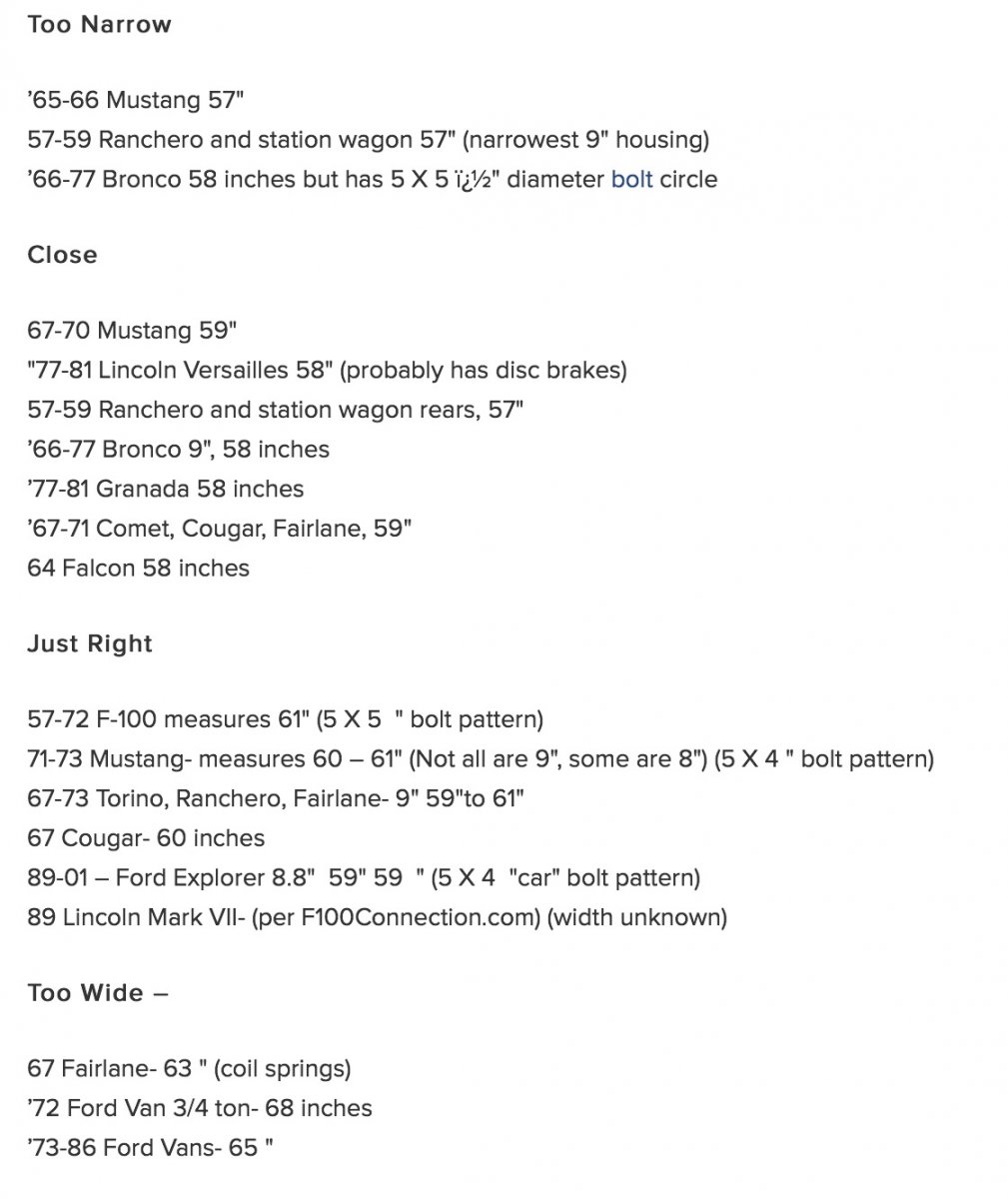

  27. Bader2
    Joined: May 19, 2014
    Posts: 1,143
    Bader2
    In 73 they get 4" wider,57-72 is 61.25"

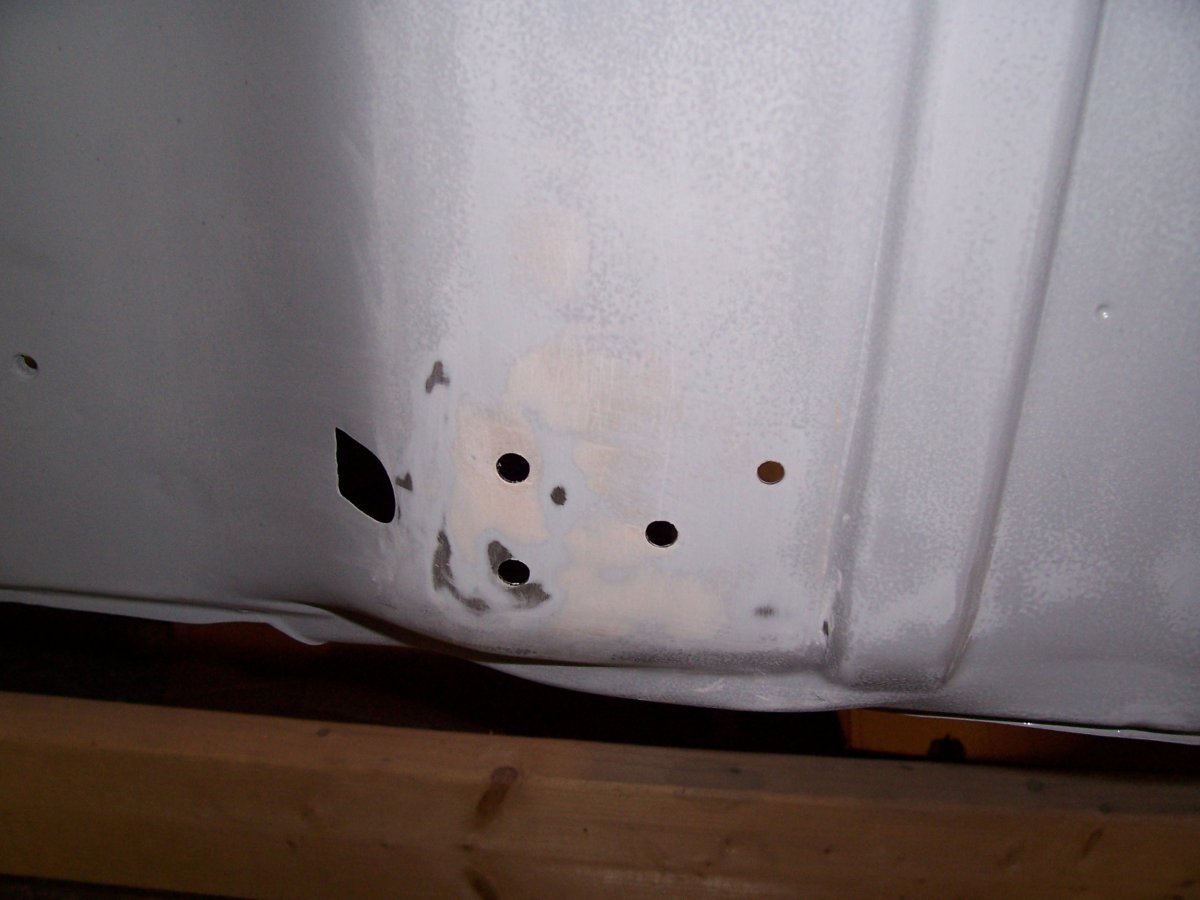

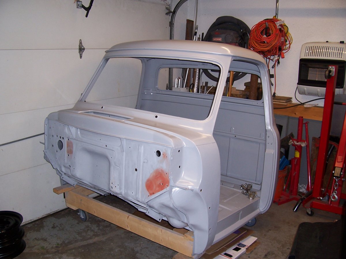

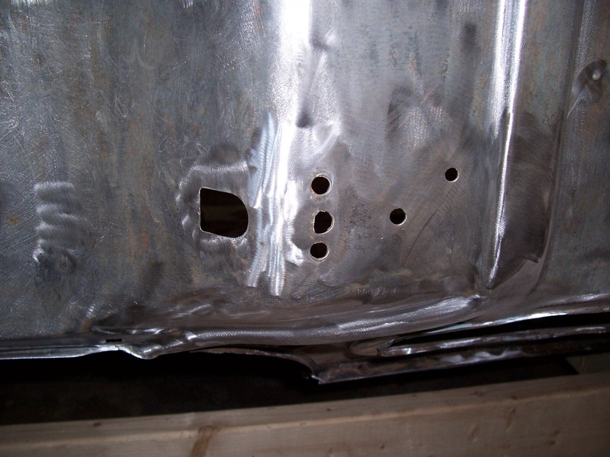

    Most of the time I've spent on the truck over the last 6 months has been hammering dents out of the cab and fixing all the extra holes people put in the firewall over the years. I also replaced all the factory Ford knock-outs for options that I would not be using (vacuum wipers and such)to keep it factory looking. Not much for photos on that, but its in epoxy primer now and I'm back to working on it more consistently.
