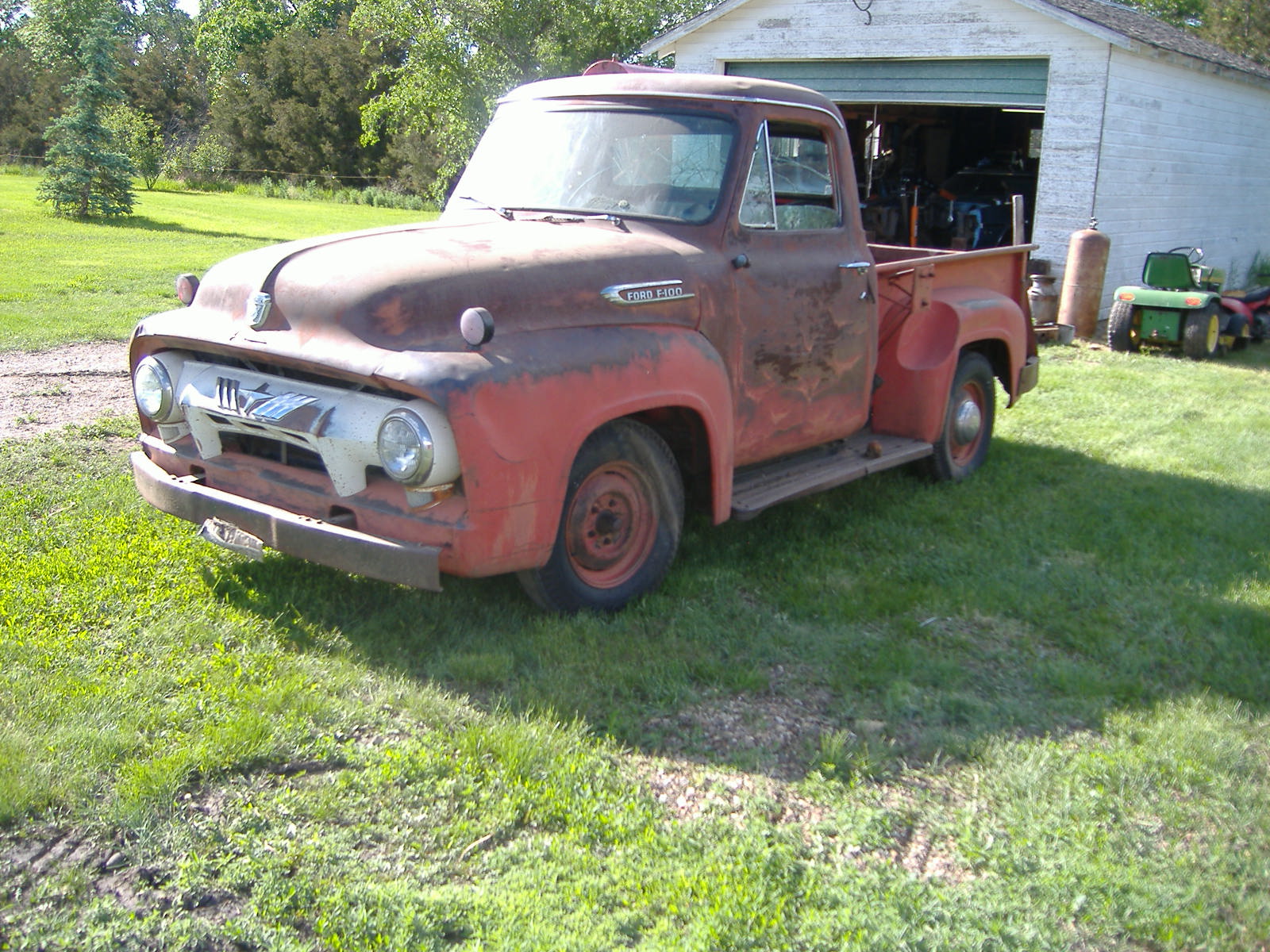

    Back story: I've wanted to build a mid fifty's F100 for many years, and finally bought one. Its a 54 F100 that spent most of its life as a farm truck, it has some rust, lots of dents, but I don't believe it's ever been taken apart or messed with at all.
    Direction: At this point I have disassembled most of it and done some work so I'll add a bunch of pics at first. This won't be a quick build, but I will do the best I can with updates.

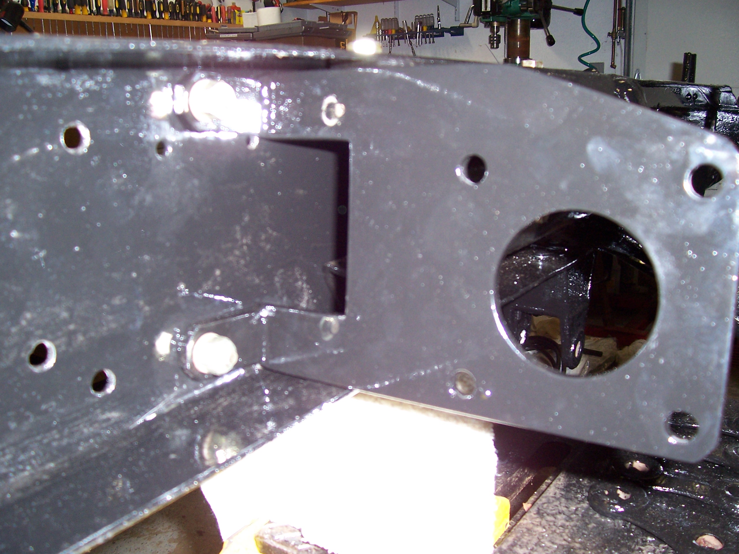

    100_1275.JPG I was able to pick up a 3" dropped axle with disc brake kit pretty cheap on C/L.

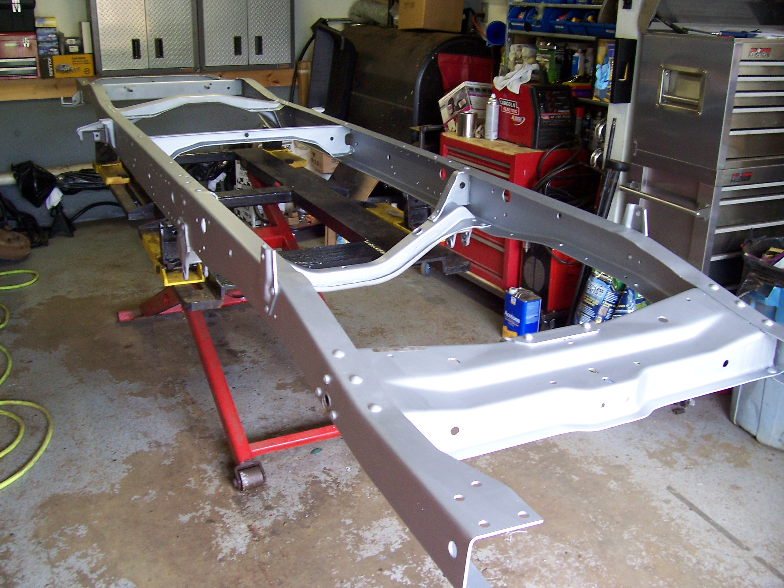

    100_1426.JPG After stripping the frame and fixing all the small cracks, tears, and over sized expanded holes I painted it with a product I picked up at a swap meet in CT 2 coats of silver and 2 coats of black. The guy that sold it to me said I would be impressed with how it would smooth out the texture of the frame, and I am.

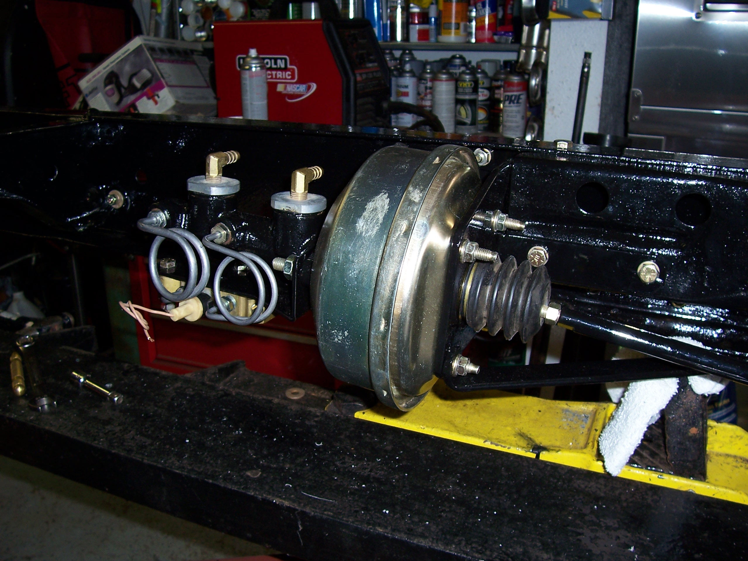

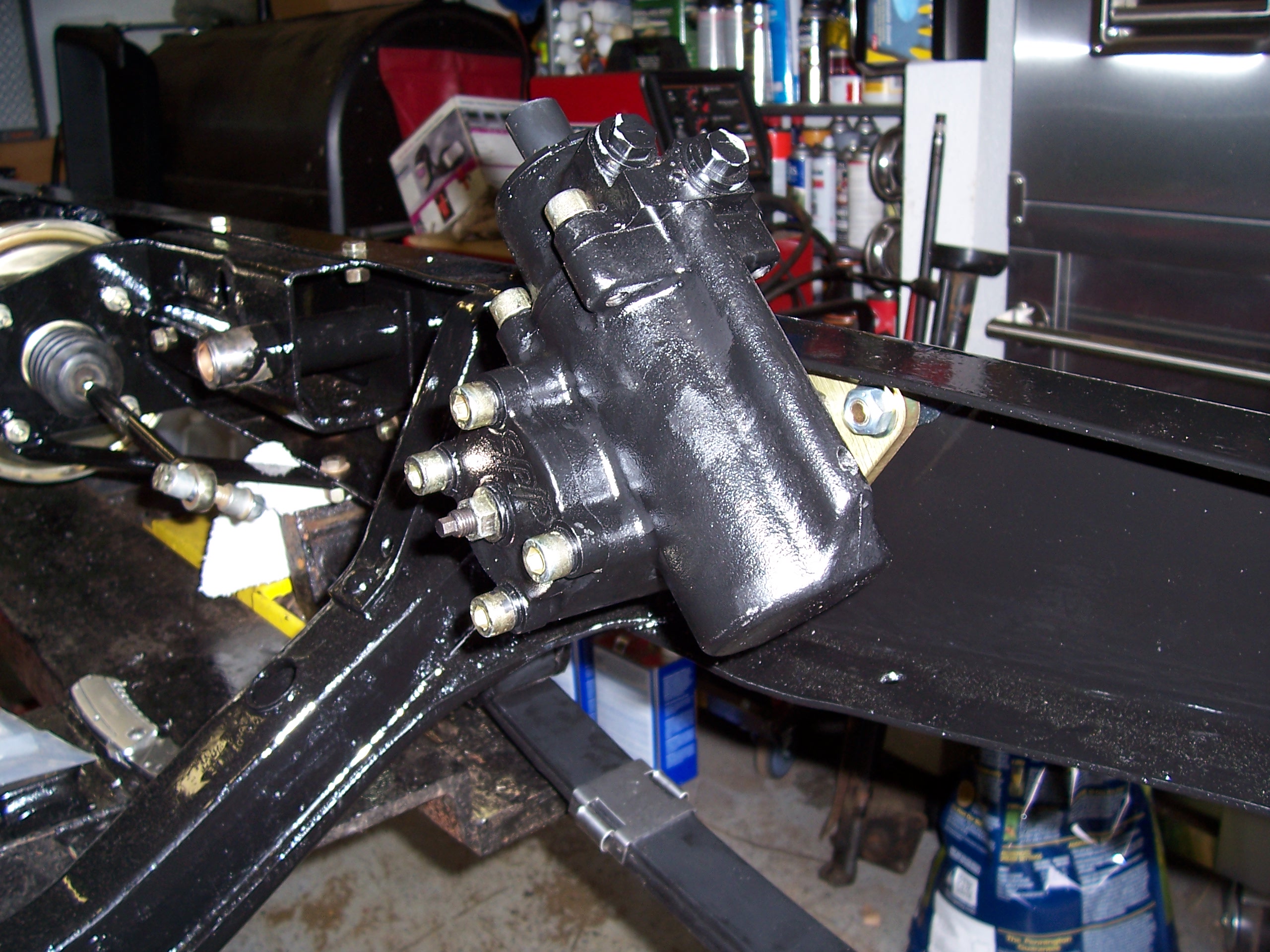

    I want power brakes and steering so I picked up an under mount power master setup that a guy used mocking up his frame then he went a different route. The power steering box is from Mid50 via CPP. All went in very easy. 100_1447.JPG 100_1450.JPG 100_1451.JPG 100_1452.JPG 100_1453.JPG

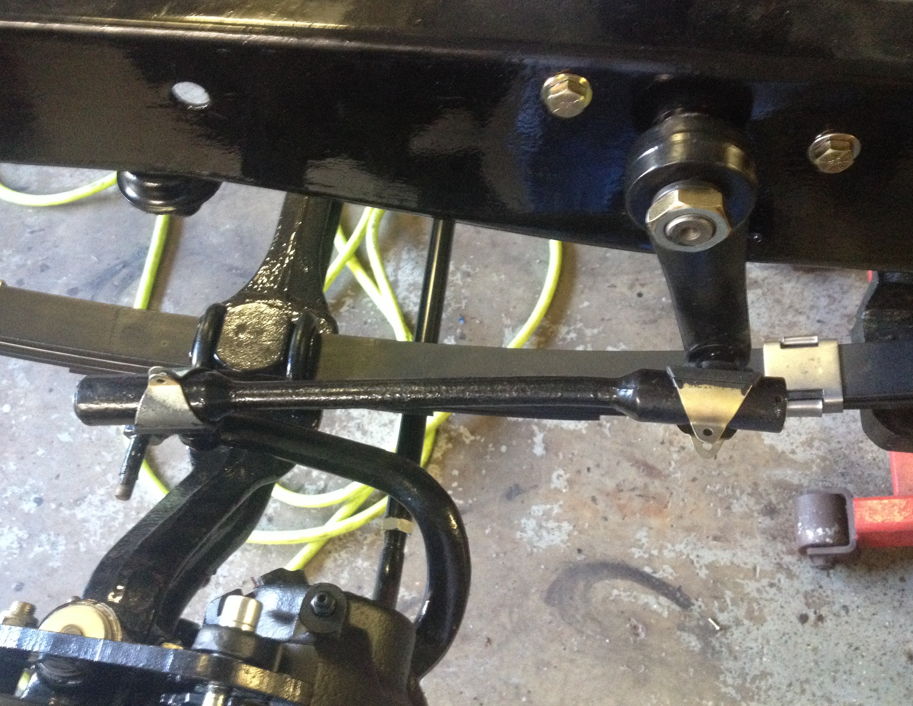

    I cleaned up the springs, removed every other leaf (as per mid50's catalog), put in leaf liners, 2 inch drop shackles in the rear, new bushings, and pins all around. The rear end is the original Dana 44 new bearings and seals.
    100_1454.JPG 100_1455.JPG 100_1456.JPG 100_1457.JPG 100_1458.JPG and this is as far as I've gotten as of today.

    Saturday I got the steering and brakes installed on the frame. ( drop tie rods from Speedway)

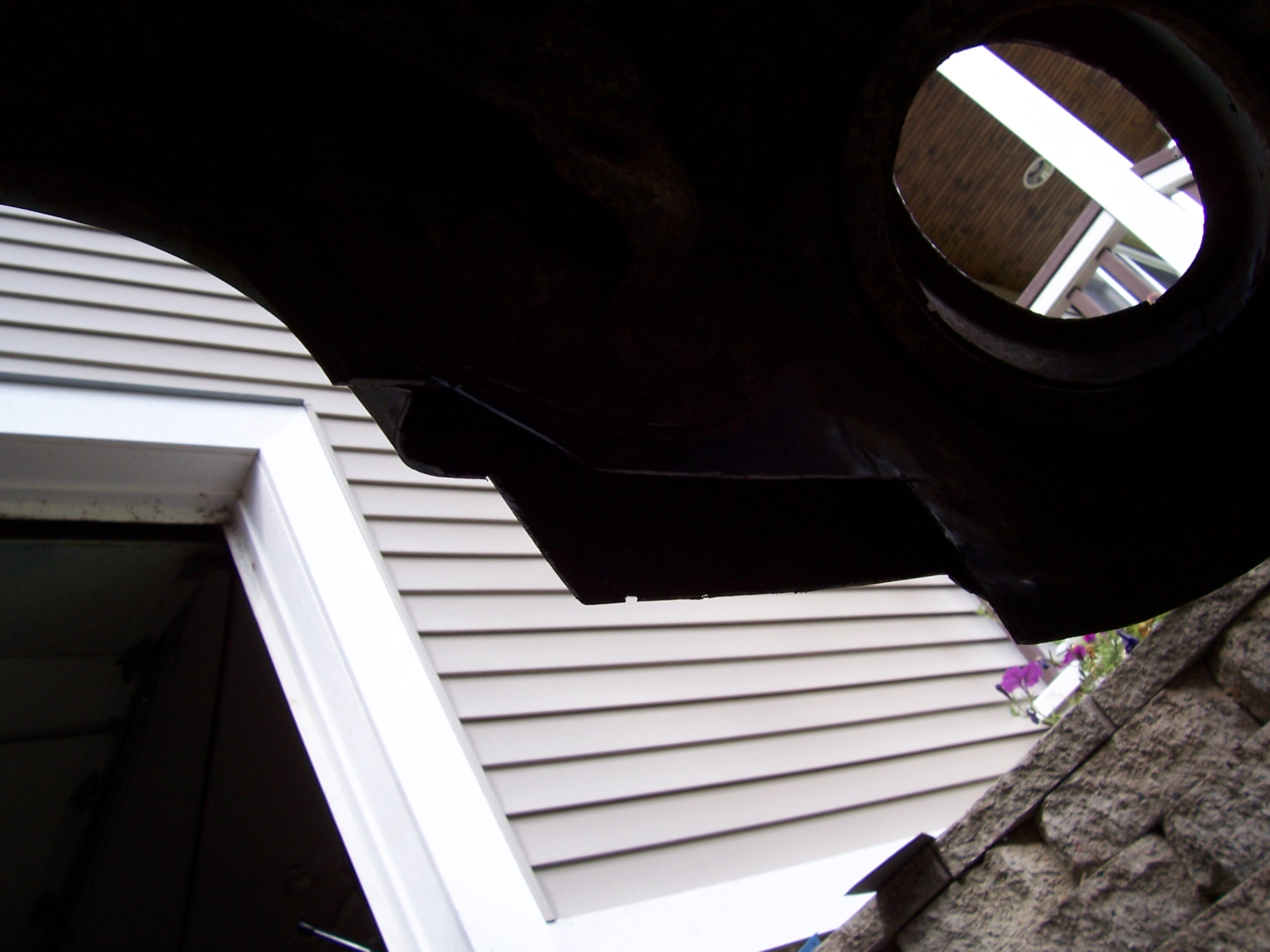

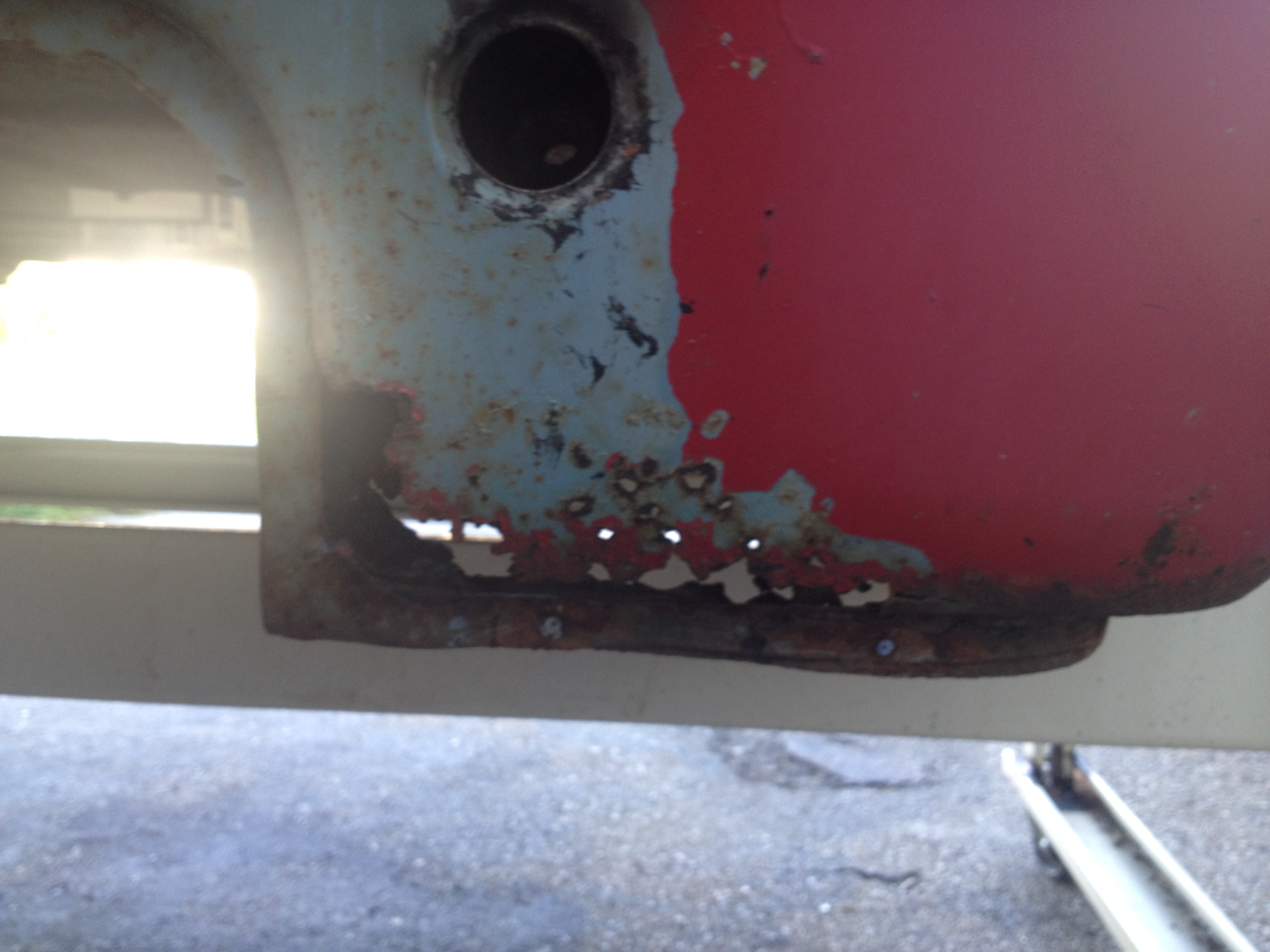

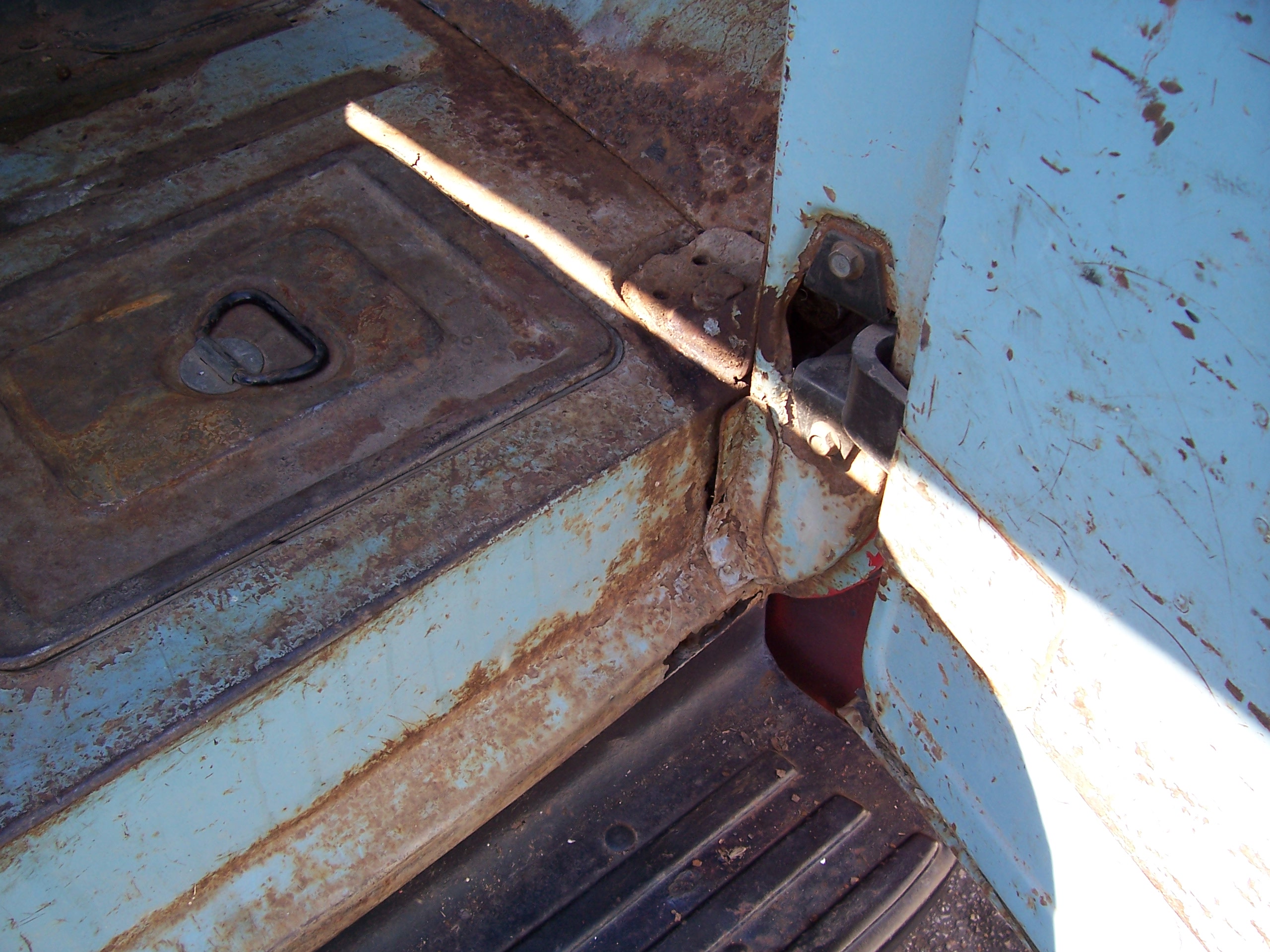

    I decided to get some work done on the rear cab corners this weekend.
  15. windsurf88
    Joined: Jan 24, 2012
    Posts: 107
    windsurf88

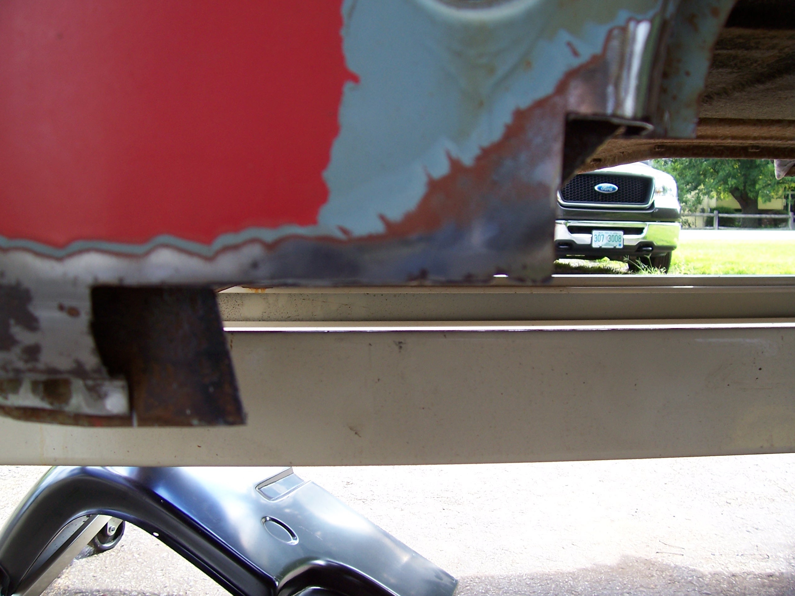

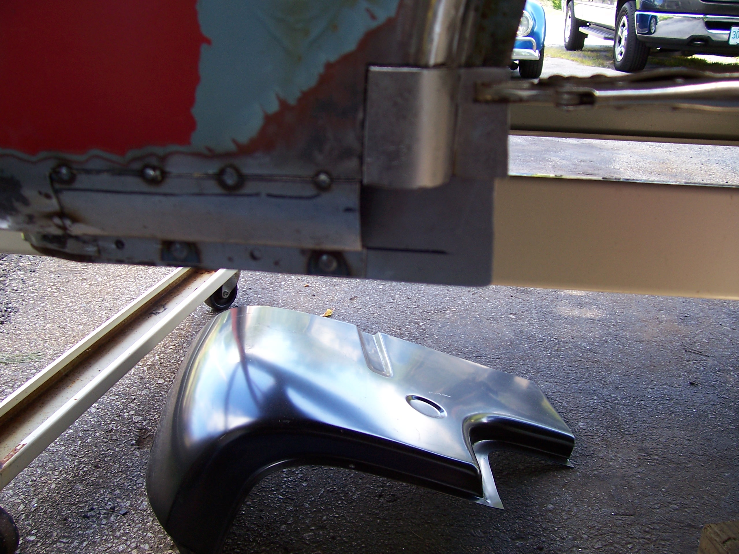

    I cut out the rot, and found the repair panels I bought are quite a bit off from the originals.
    The corner is square, and the lower edge sticks out an 1" vs the 1/2" of the original.
    I think if you where to use the whole panel it may work out but I planed to only use a section of it to keep as much of the original steel as possible.

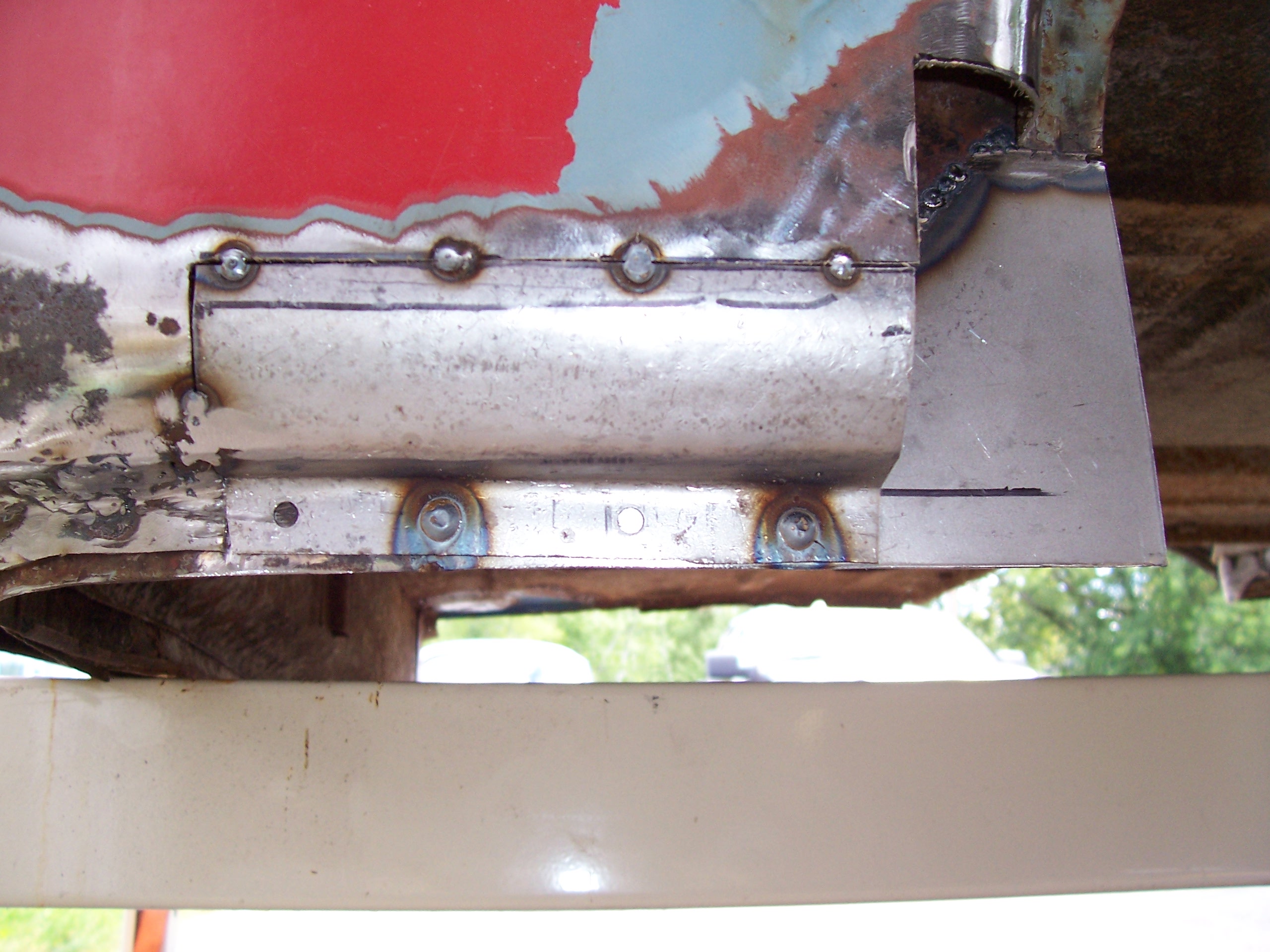

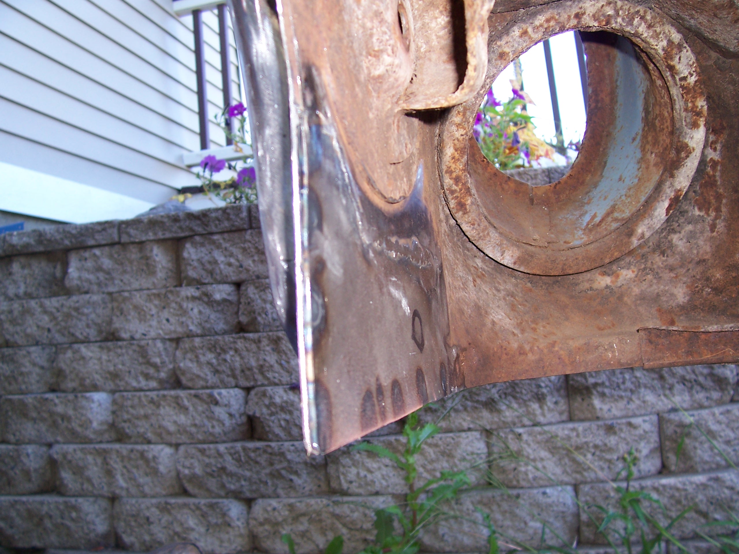

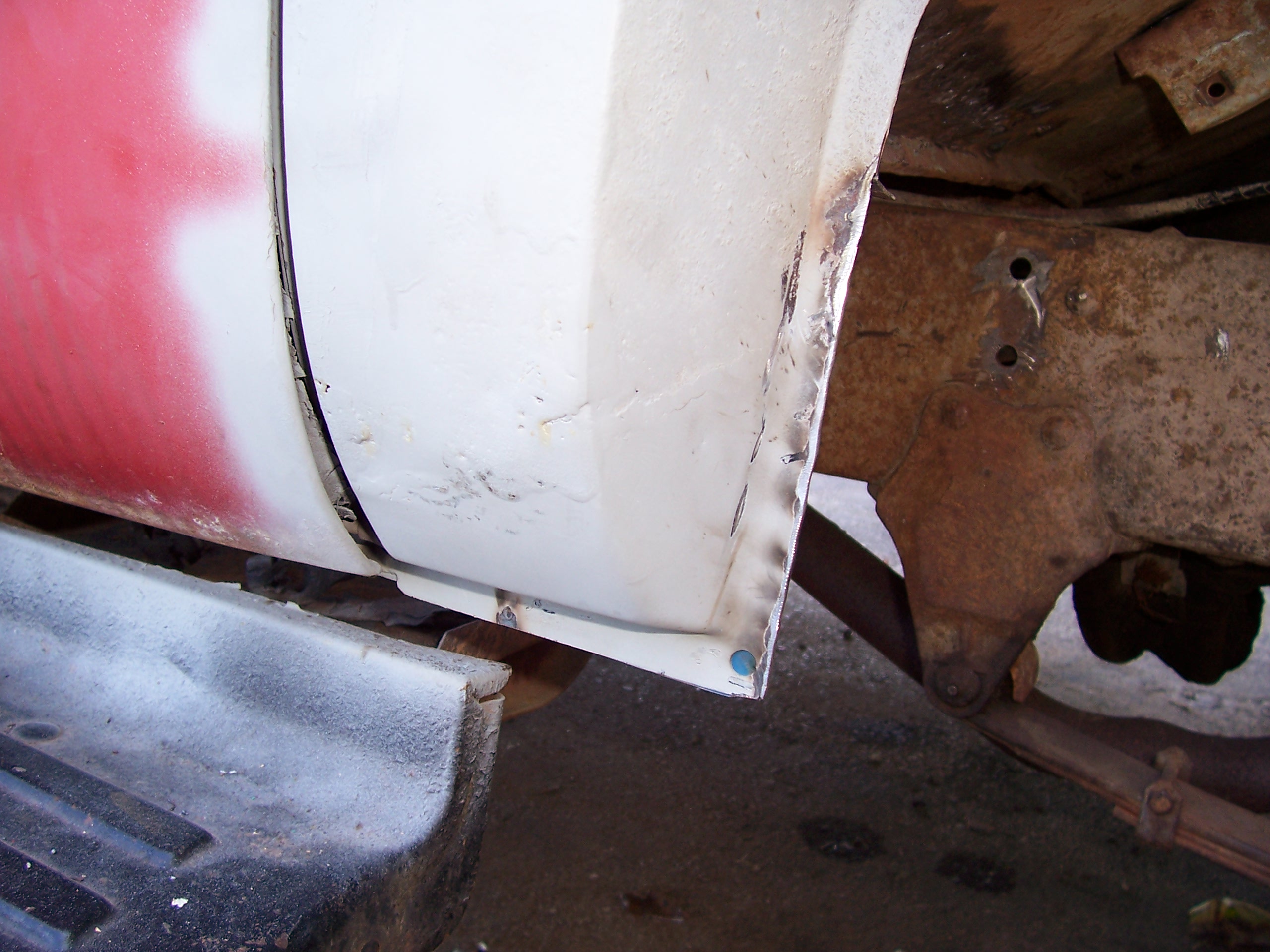

    After looking at it for a while I decided to try to make the corner...
    I think it came out pretty good, might need a little filler here and there.
    100_1478.JPG 100_1479.JPG 100_1480.JPG 100_1482.JPG 100_1483.JPG 100_1485.JPG 100_1487.JPG 100_1488.JPG
  18. windsurf88
    Posts: 107
    windsurf88
    Same thing on the right side. More rust on this side, but took half the time once I figured it out.

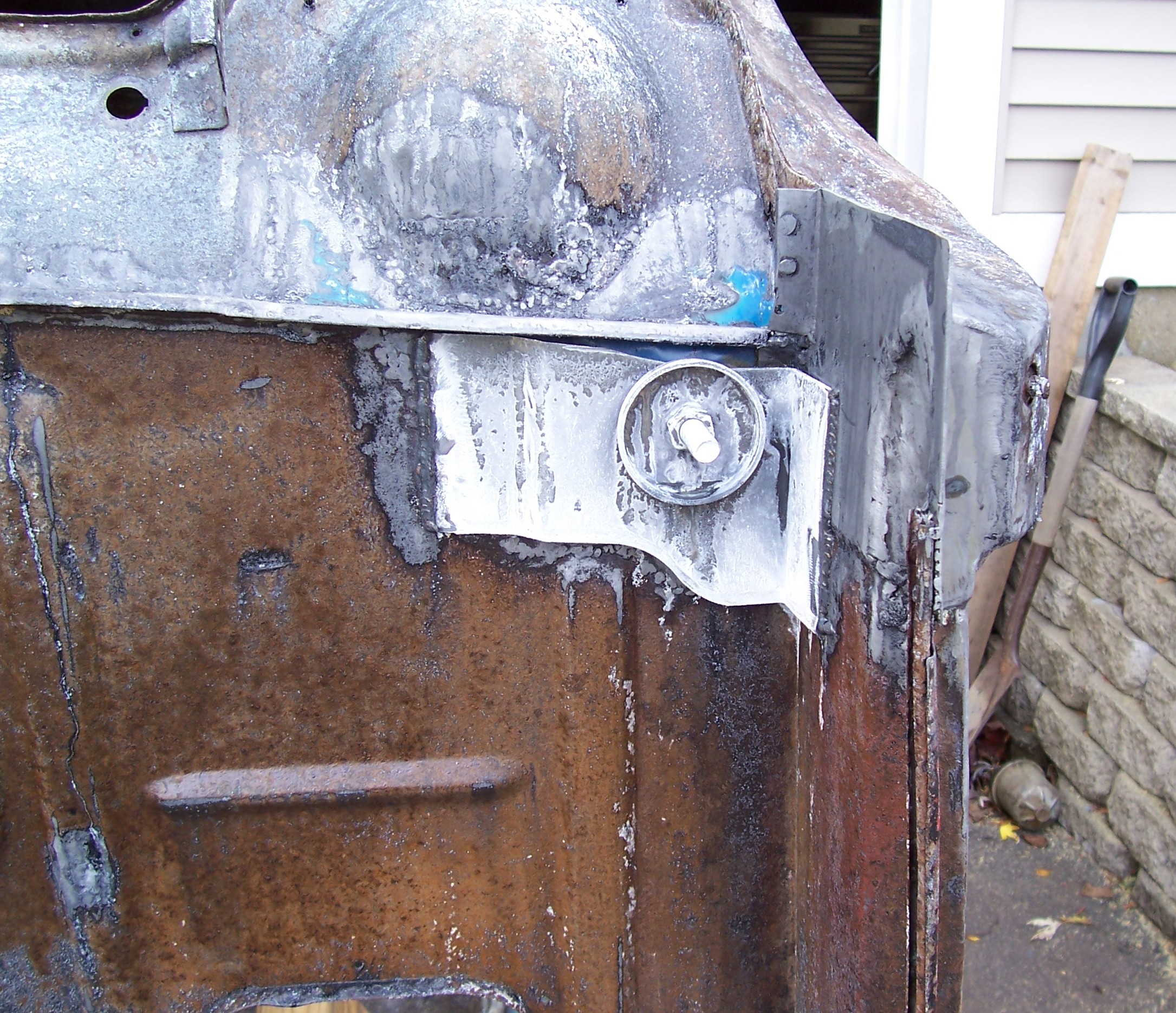

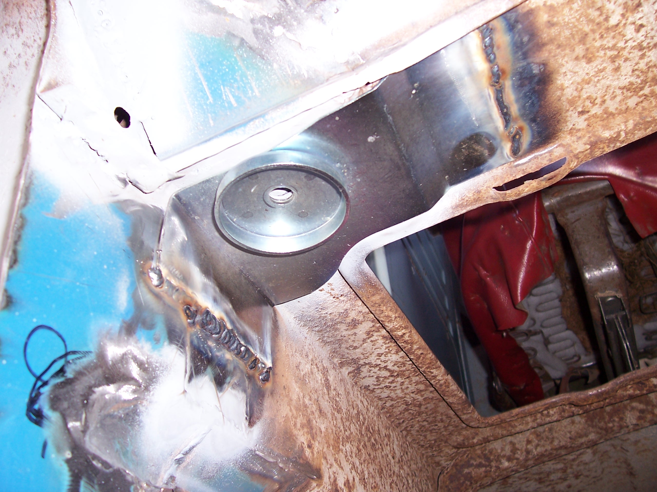

    I finished up my last cab corner (I had started this one before I pulled the cab). This side needed the inner cab support.

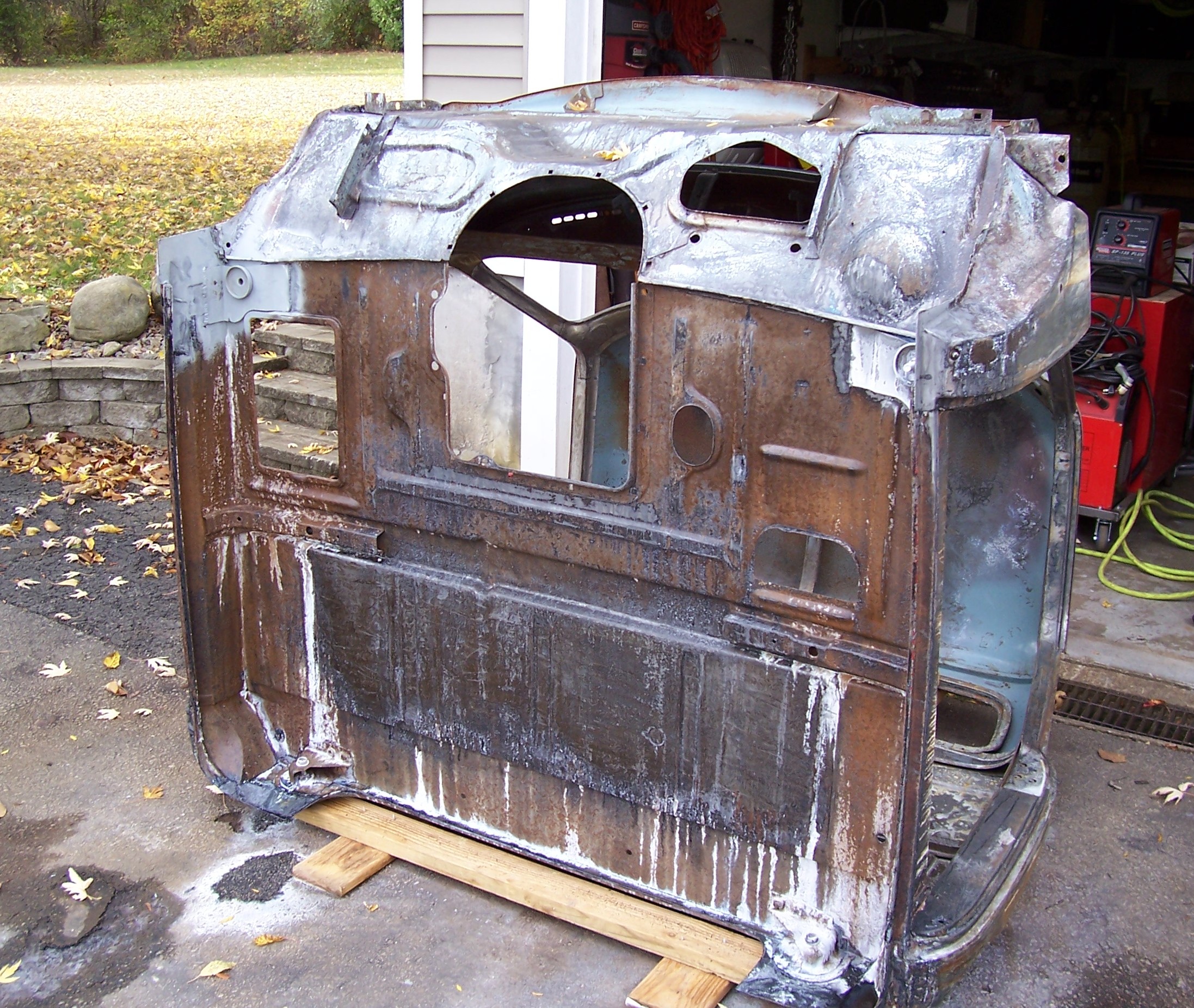

  23. windsurf88
    Posts: 107
    windsurf88
    I cleaned up the bottom of the cab and painted it with the same silver and black paint as I used on the frame bottom.jpg 100_1512.JPG 100_1513.JPG 100_1514.JPG
