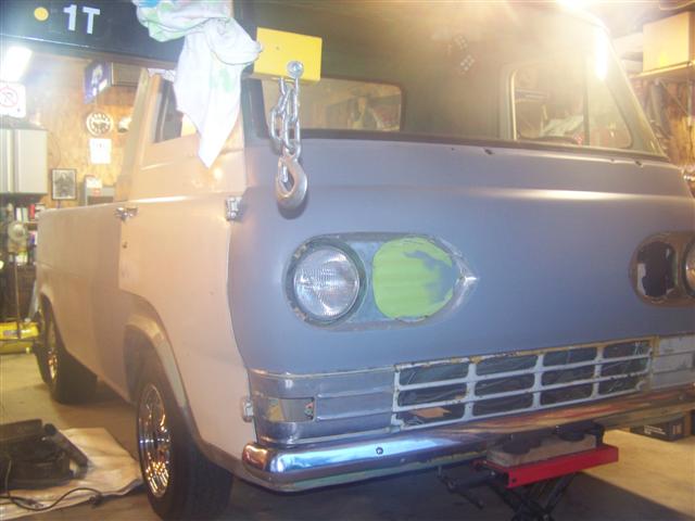

  1. Thought I would drop a few progress pictures to those that might be interested. Around these parts its hard to find E100's so you have to take what you can find. The tailgate is a 03 Dodge 1500 gate that I shorten and sectioned, lots of work to get that fitted with the fab'd up roll pan but I am making progress. At the end is a youtube link if you want to hear it.

  12. Thanks guys. The tailgate has sucked up alot of hrs. Basically I ended up cutting about 6-7" inches off each end and then sectioned the inner construction back in. Had to radius it to the box side panels and also to the rear pan that was fab'd up as well.

  14. A few update pics of the tailgate. Lots of hours back there!

  24. Thanks guys. I have a lot more of the mud work completed now and am working underneath cleaning and getting all the linkages finalized. Will try and grab some update pictures later today.
    kgdb
  25. A few updates.
    Have the brakes all done, did a front disc set up, real cool and works great. Mustang tank is in and changed that over to a rear fill through the roll pan. Decided on a 69 Camaro rear bumper for the front, I think it looks like it belongs there. Lots more to do. Here are a few pics:
