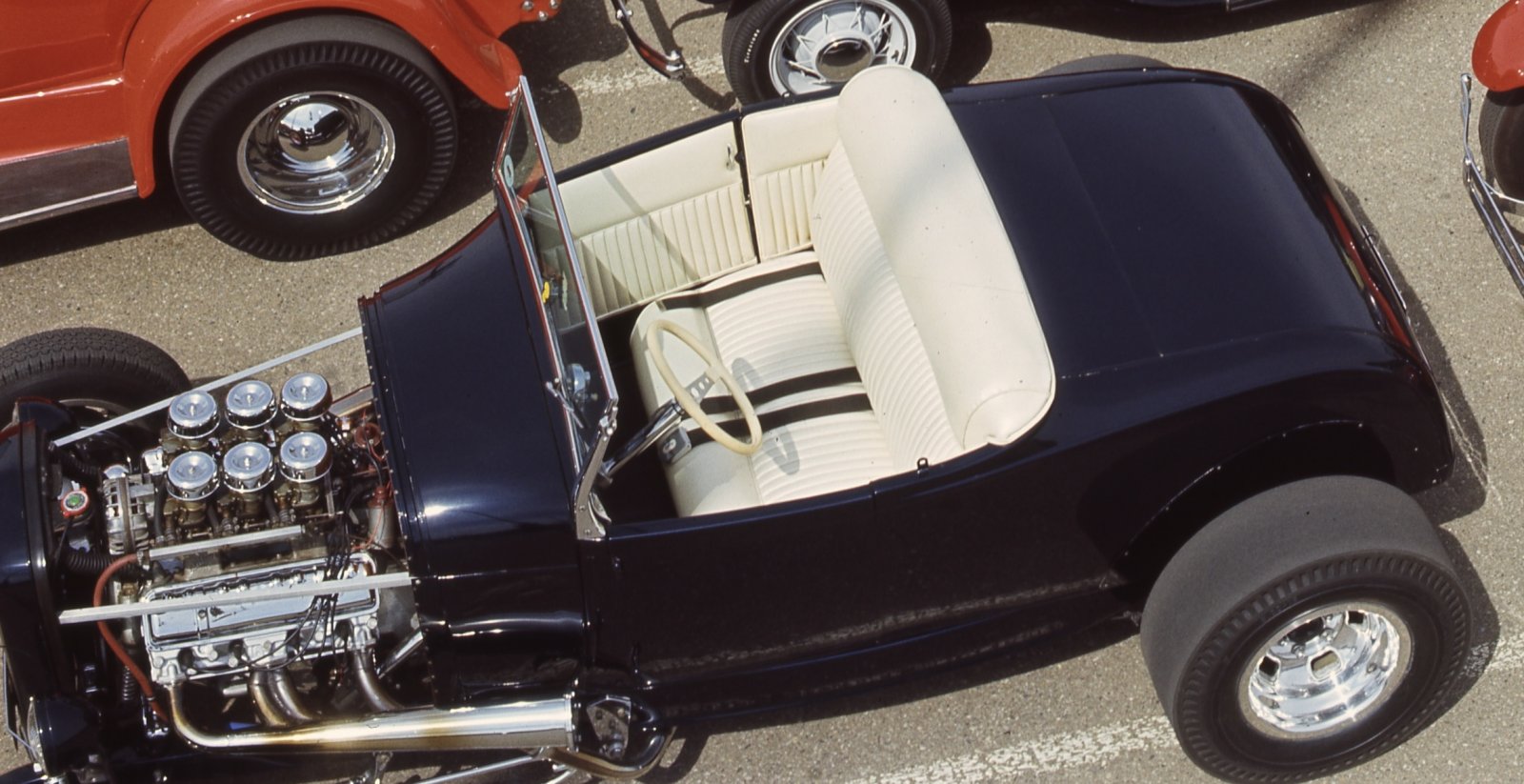

    The Sam Conrad Roadster: Growing up near LAX there were many hot rods running around. One that showed up in my neighborhood regularly was a dark blue ‘29 on ‘32 rails with a thumpin’ Olds motor. It belonged to L. A. Roadsters member Sam Conrad. In the early to mid ‘60s I was 13-15 years old and still on a bicycle. That didn’t stop me from making the rounds of the local hot rod hot spots, including C&O Hydros and Jack Seiburh’s Westchester Auto Body. Anytime Sam’s roadster was in the neighborhood I rode over and just devoured it in my mind. The metallic blue paint, the sparkling white interior, Halibrands at all four corners and of course, the Hugh Tucker built Olds engine with 6-2s and chrome headers. As I got older, I promised myself that I would build one just like it. Mine is NOT the Sam Conrad roadster, neither is it an exact clone, it is a tribute, built to honor the taste and skills of the creator of the original. Many cars and distractions later I decided it would be my last full build, meant to stay with me through retirement to the end. I’ve been collecting parts for it for a long time. Some idea of where this is going….
    In color….

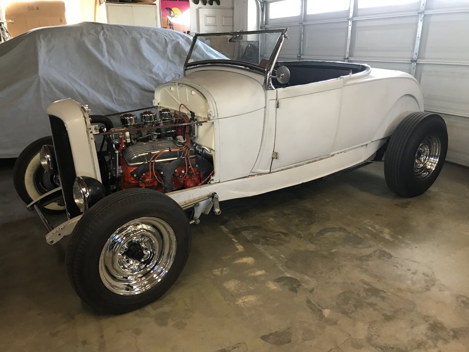

    The Velzy Roadster as I got it….

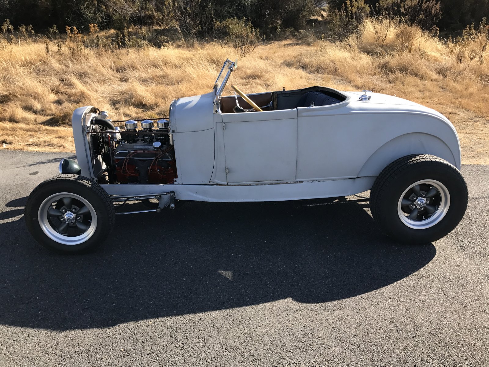

    And as I drove it for a while…. Just a few changes to make it mine.

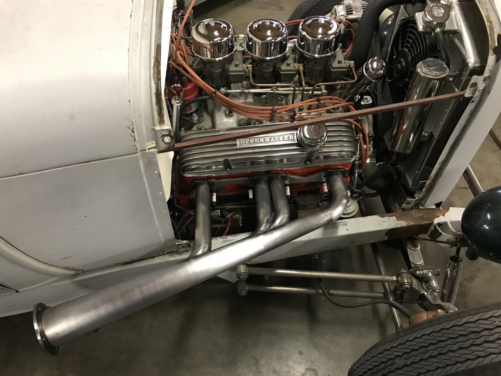

    I’m a header guy, so of course, new exhaust….

    I can’t take credit. I was in a big hurry so I used a Speedway kit. I actually started out just to doll it up just a bit for summer and fix some irritating bugs. A scuff and shoot color change, a bigger small block for a little more zip and new exhaust. But you know how that goes….

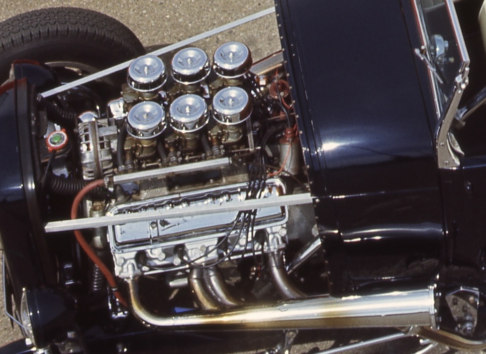

    Here's Sam's old LAR #3

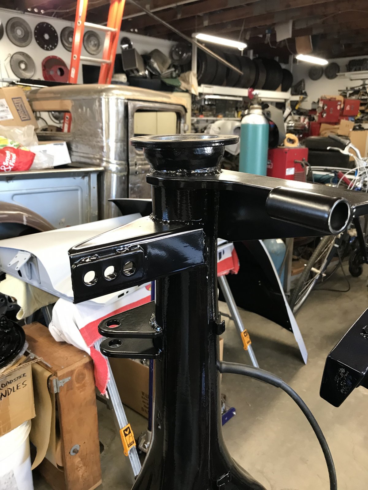

    Here's a few disassembly photos. This frame is a tank. The X is 2x2 heavy wall tube with plate welded on the sides. Nicely done. arc welded and ground. Sam's car was basic '32 rails, boxed with a couple added crossmembers, no X. I wasn't about to try to cut all that out, I like the stiffness and the extra weight is low and will help the ride quality. So the Velzy part will remain. It looked like a '70s biker built the frame, everything was molded with copious amounts of Bondo. So I just checked it for straightness and moved on.
    Note the rear 4 bar. The bottom bars hang way down there and show way too much. Sam's car had ladder bars that went all the way up to the bellhousing. That couldn't happen on this frame. Another concession to practicality. That's why the car will be a "tribute" and not a clone.
    The last photo is the pedal assembly after I cut it apart and (mostly) straightened everything out. The M/C was leaking because the old rod pushed sideways on it.

    The roadster is getting a '56 Olds, B&M Hydro, and an Olds rear end. Sam had a bigger Olds in his car but I wasn't able to get ahold of a good 371 to build. I acquired a big stash of Olds stuff in a labor trade when I had my shop, a complete engine, blocks cranks, heads, etc. The Hydro came on the back of a 401 Buick I bought. I also bought the rear Halibrands years ago from Don Waldron. The wheels had been polished before so I couldn't resist putting a little shine on them.
    So, the first step was to get the proper rear tires and figure out how wide the rear end needed to be.
    New Radir slicks..... oh yeah.
    I didn't want to tuck them in too close, too late model looking, but some old hotrods looked a little gangly with narrow tires too far out. It's a fine line, but an important one.
    With the correct measurements in hand, I narrowed the '60 Olds housing.
    And made some new 4 bar brackets the old fashioned way, cutting torch, grinders and the drill press.
  27. bchctybob
    Joined: Sep 18, 2011
    Posts: 5,245
    bchctybob
    I made up a pair of quarter elliptic springs for the rear just like Sam's car. Unfortunately, with the X in this frame I couldn't use them. Oops.
    So I cleaned up the '40 spring and made some spring hangers. (current photo, couldn't find the early ones) That's my '33 pickup in the background and those gray things are Morris Minor woody parts waiting for me to paint them.
