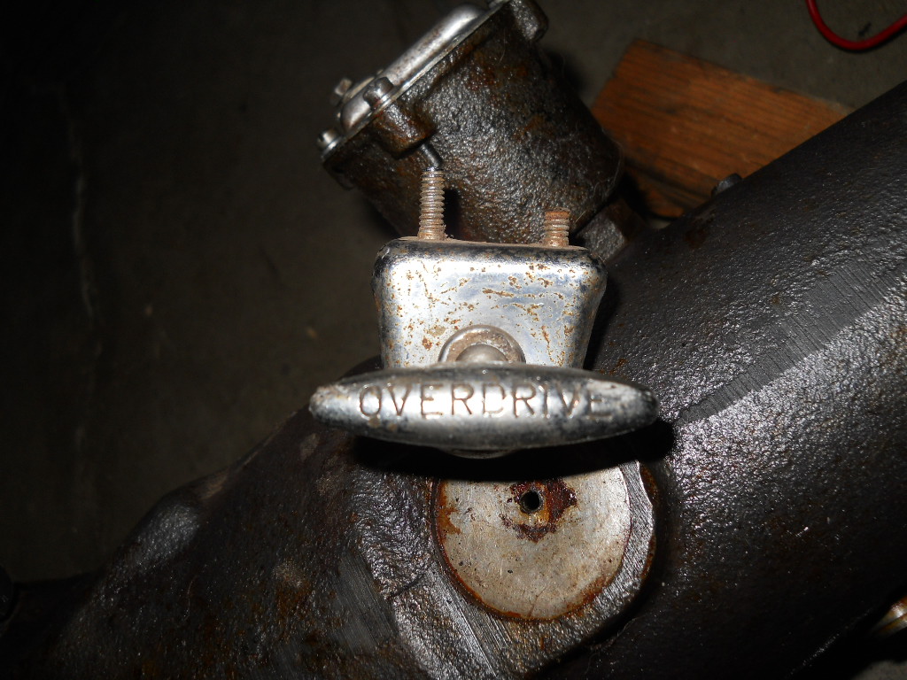

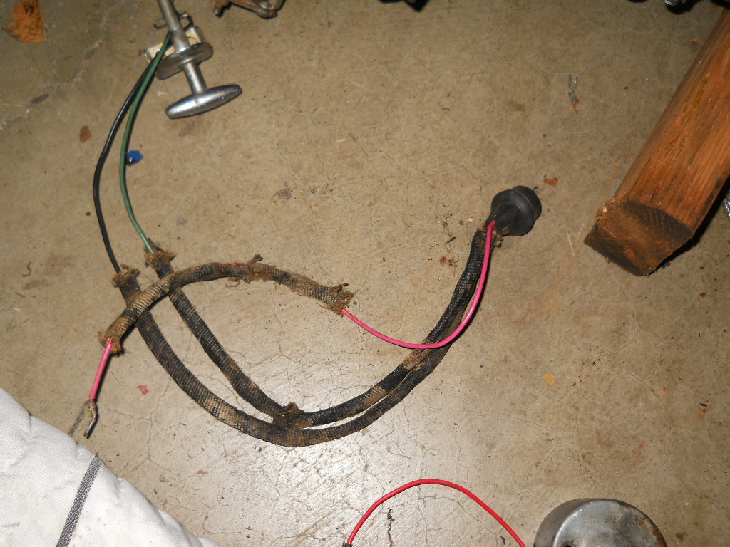

    Now for the question. I bought a 3 speed with a borg-warner r10 and i dont have all the parts to do a factory install. My question is if I have the overdrive lockout cable in and a toggle switch, how do i wire it and what is the proper procedure to get it to shift into overdrive? Thanks for looking and thanks for any help.

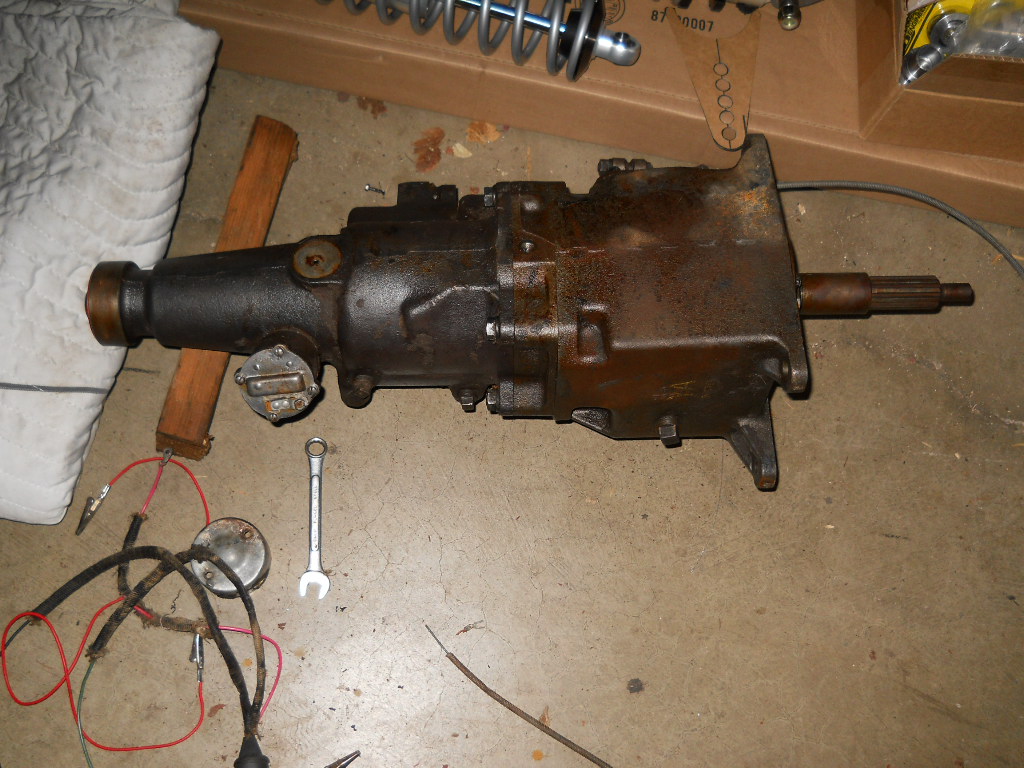

    Just wanted to share some recent pictures. I also wanted to ask about using transmission fluid in an r-10 overdrive since its a planetary gear? Im going to pull the engine to get the crank turned and the overdrive is going in when the engine goes in, just wanna make sure i dont ruin it. If funds allow im going to put a cam in with some light head work and an intake and carb. thanks for looking

    I have run a '62 3sp+od for the last 12 years in a dd/only vehicle. You need to inspect the od before you just put it in, that solenoid looks suspect (where's the top?). You can check the solenoid by hooking up jumper cables, if good it will push that pin out a half to 3/4".

    I have since snipped the zip ties. I took the cap of the solenoid to clean up the contacts and test it, it does work, I've also cleaned and tested the governor. Thanks for the insight and suggestions.

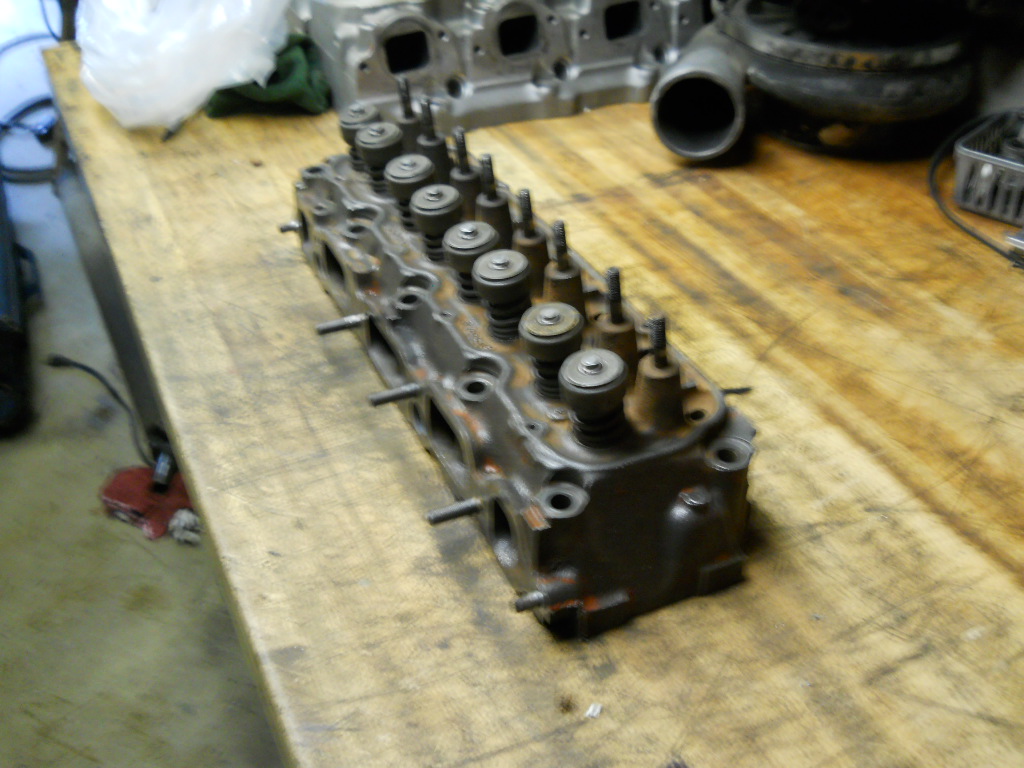

    I got my crank, rods and head back from the machine shop today, just waiting for the cam now. cant wait to see how it runs when its back together.:D

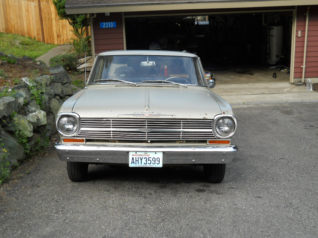

    Not to split hairs, but isn't that an Acadian? The Canadian version of the Chevy II's?
    Something about the grill looks different....

    its not an acadian, the original owner bought it out of oak harbor, wa. the grill does look kind of strange though, always looked like it was missing something.

    Im working on the car again, I put some nos factory sized bias plys on it. still need help with the overdrive, I havent gotten it to shift to overdrive. Ive tried the cable in and out and have a direct switch to the solenoid and havent noticed a shift or freewheeling and can shift into reverse with the cable in or out. Any ideas?

    I dont want a floor shift, but am tempted. I did some more testing this morning. I jacked up the rear end and had spun the drive shaft in these combos, cable out solenoid off, cable out solenoid on, cable in solenoid off and cable in solenoid on. The latter made my driveshaft lock up so I took it for a test spin cable in switching the solenoid on while driving and no shift, i tried clutch, clutch shift to neutral and clutch shift to no avail. so i stopped in neutral cable in solenoid on and rolled the car, the driveshaft locked so i got in and put it in first and it wouldnt move just slowed the engine down. Any ideas what im working with? would like to get it working today as i have to drive a 110 mile one way trip this weekend for work and would like to use overdrive. any help will be greatly appreciated.
