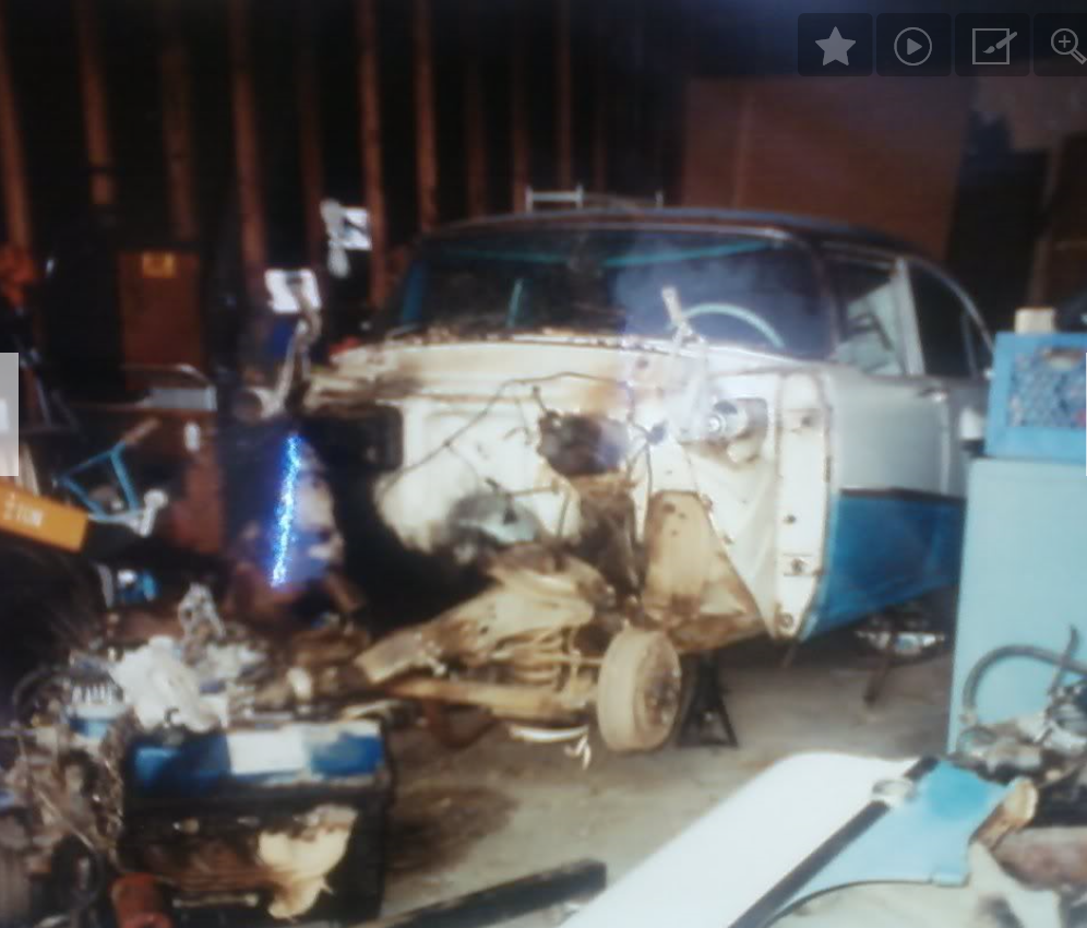

    So I hope this is correct place to share and ask questions on my dads 1956 Mercury Monterey project.
    Dad had the car for a long time and I remember riding around in it as a kid. Here I am on the hood (Ignore the date... This is a digital picture of an actual photo):
    The car had the transmission go out so dad pulled it and dropped it off at a transmission shop. Dad passed away in 1999 while transmission was out getting fixed and the car sat...
    I got older and decided I wanted my dads car so I tried finding a transmission without much luck. My buddy rolled his F150 and I bought it for $500 and planned on putting the 351 Cleveland and trans in this to get it going. Long story short I could not get the motor to sit between the frame so I sold it all for $700 and made a couple hundred.

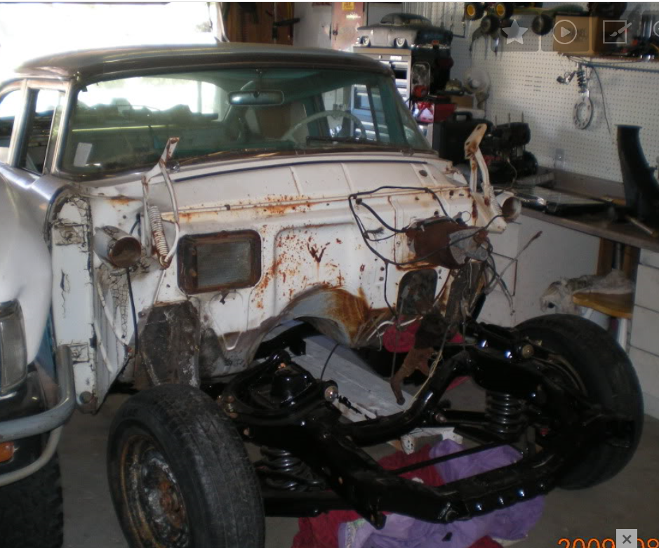

    Since we had pulled the whole front end off to try the motor I thought... Hey it is only 8 more bolts to pull the whole body. That's where I screwed up.
    Sanded and painted the frame. Installed new suspension bushings and had the front springs powder coated by a friend at Eibach.
    Picked up the body from my Moms house and brought it home to work on:
    Started faking my way through rust repair. I know enough to get myself into trouble and that's about it:

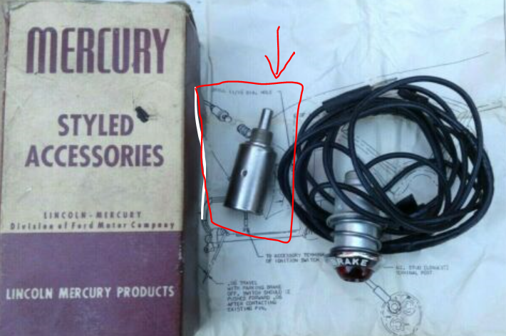

    Question #1 for anyone that knows:
    Anyone know where I can find this switch? It attaches to the parking brake and it turns on a dash light when the parking brake is on. I found the entire kit on ebay for $350 but this car already has it... I just need a new pressure switch. I have tried searching google and using as many different words as I can to describe the emergency brake pressure switch:
    https://www.ebay.com/itm/NOS-1954-1...E-SIGNAL-WARNING-LIGHT-Original-/324008890917
  12. That's just a pushbutton switch, you could substitute a dome light switch or brake light switch for it, just find one more-or-less the same size...

    Sounds good. A dome light switch sounds like the correct option. It needs to turn on when open and off when the button is pushed. I will start looking around. Thank you

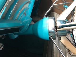

    The car runs now but unfortunately while idling the car drops into reverse. It looks like the linkage from column to the Automatic transmission is correct. Does anyone know if there is something in the column that would need to be rebuilt in order to have it click/stay in park?
    Factory column with a C4 Automatic transmission.
    Here is the column in question. I have tried searching this site, google and you tube without much luck.
  15. jimmy six
    Joined: Mar 21, 2006
    Posts: 6,359
    jimmy six
    You need to take off the steering wheel and move up the turn signal system. Carefully push the wires from under the dash in so you can pull the turn stuff up towards you to look at the parts that go into notches. The 56 Ford is exposed and the Merc is covered. As you move the lever toward the steering wheel it moves a pin(wrong word) out of the notch and allow you to select a gear. You do pull the shift arm to you to move it don't you? Most don't do a good job of it and round the notches.
    I had to make the arm on the bottom of the steering column 1" longer by making a extension with the same rubber grommet to get mine to work and I still don't trust it. I park mine in neutral with the e brake on ALWAYS-EVERYTIME..
    I also need to go in where you need to go and "square up " the notches and possibly make a slider over clip on the Park spot to assure it stays there. A point to ponder .... ..... .... These have always been a POS and Ford paid out a lot in later years when cars idling fell out of Park and went into Reverse. Ask an old cop he'll tell you. Good luck.

    Somebody possibly added a start in park switch to your arm on the column. Fords in 56 started only in neutral Mercs may have been different. You may need to take the fine thread adjuster on the top of the linkage going to the trans from the column and lengthen it a turn or so.
    You need to know that there were only 5 spots on your indicator and you now have 6 in your transmission. Was PRNDL. Now PRND21. Lengthening the rod may change your indicator. I also have a true 3 speed not a C4 and made changes to my indicator. A lot easier for me than you. Good luck. This is what happens when vehicles are updated. It’s the little mechanical things that need to be done and figured out and hopefully not paying anyone to do it. E9159275-0AE4-4142-AD28-605DF06C3FFE.jpeg

    Here is what I found with pictures incase someone in the future needs to know how these come apart:
    1) Pull spring clipped center cover of steering wheel off
    2) pull nut holding steering wheel on
    3) Use puller to pull the steering wheel (Do not place puller jaw at the 10 o clock position or you will hit the horn button and crack your plastic cover- ask me how I know)
    4) Pull 2 Phillips screws out of plastic cover and remove cover
    5) unthread blinker lever
    6) slide blinker mechanism towards you off of the switch and out of the hole on the left (the blinker lever holds it in so must be removed first). Be aware there may be springs or bushings on the blinker switch on the right.
    7) remove 2 Philips screws holding blinker electrical switch and move to side
    8) Use pic tool to pop the top cover off the steering column collar. It is held on with a spring clip
    9) Remove the 2 philips screw from under the cover to remove shifter light and shifter selector backing.
    10) Loosen the 2 nuts you see in pic in step 6 (do not remove fully). This will loosen the chrome ring allowing you to remove from column
    11) you now see your shifter lever and the collar is loose:
