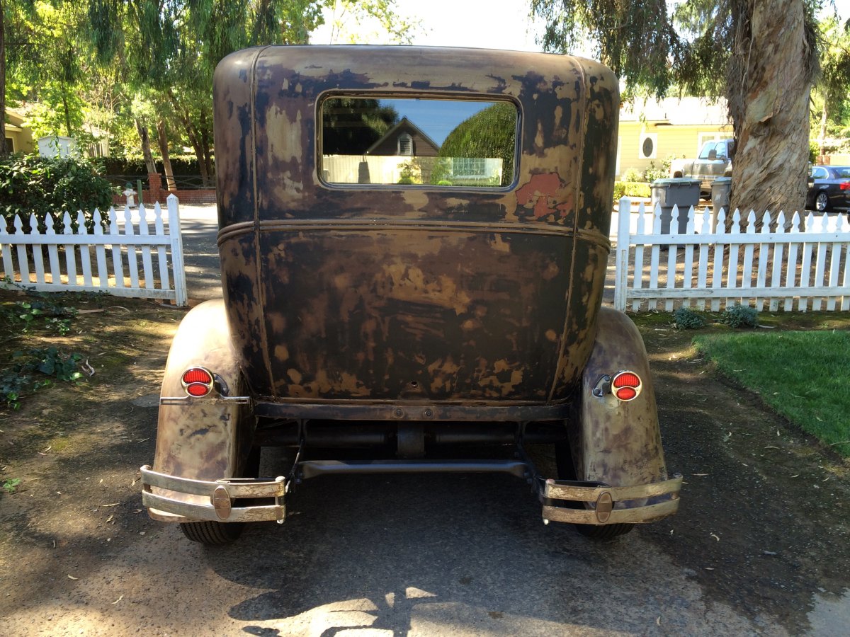

    Hi Guys
    I brought my 1929 model a into my shop to lower it a bit because I have '35 wire wheels on it. Based on some other threads on the Ford Barn I have it down to the level I want now. The only problem I have is it sags on the drivers side. It always has except that now with the car sitting lower it's much more noticeable. At the front wheel its 1-1/4 inches lower than the passenger side measuring from the floor to the center of the fender edge. In the rear its about 3/8 inch lower on the drivers side. Right now I don't have the shocks on it. I suspect the frame is tweaked some amount. Is there any way the get this car leveled out some? Will Shocks level it out some. Or, is there anything else anyone has tried that has work to level out their car?
    Thanks

  12. Ron Brown
    Joined: Jul 6, 2015
    Posts: 1,614
    Ron Brown
    IMG_0510.JPG My sedan sits slightly lower on passenger side but sits level with driver. I just left mine. but may try to even things up with shims....just for ducks.
  13. Harold's Speed
    Joined: Jan 6, 2016
    Posts: 46
    Harold's Speed
    Thanks for the reply. I measured from the edge of the fender to the ground

  23. Harold's Speed
    Joined: Jan 6, 2016
    Posts: 46
    Harold's Speed
    Roadsir
    I have been doing the same so far. But now I have the front so low that the tire will rub in turns on the left. May have to raise it back up a bit
