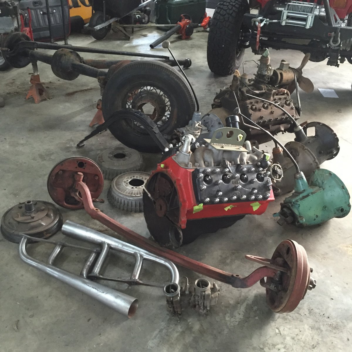

    Also got a few new goodies in the mail, looks like ill be redoing my rear. Have to tear it down and remove the pinion gear To have it machined. And order up a few sets of change gears. Ill try to do a pretty detailed build on the quick change. Its a new rodsville unit from Hot Rod Works. Good guys to deal with
    Temp gauge ive been hunting for a while
    .still need to find a fuel gauge

    man that's one heck of a score for a parts find! Did you get all that or is that the guys place that you're buying what you need from?
    lodaddyo likes this.

    That picture was from my shop. I bought it all
