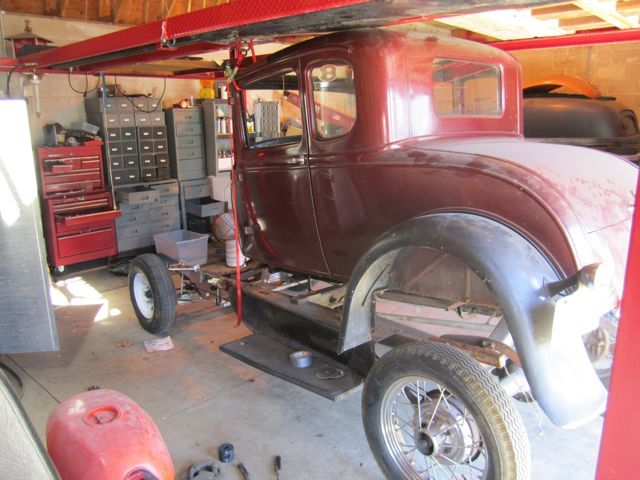

    Next the body comes off. Just two of us so we run it under the lift and "lift" it off.

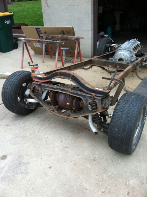

    jimbousman
    Yup, IFS and now for the next reset. 300 motor, Mustang II IFS now what goes in the rear. I start catalog shopping for all the hardware for the rear. At first I though buggy springs then coil over then another deal falls in my lap. How about IRS to match the IFS. So the next thing I know a '73 SJ rear end finds it's way into my trailer and.....

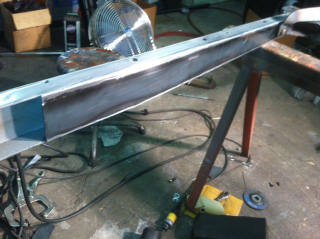

  14. jimbousman
    Joined: Jul 24, 2008
    Posts: 549
    jimbousman
    By now the more traditional guys are probably yelling nasties at their computer but remember this is a driver. I hoping for long hauls in my A so bear with me through the rest of this...

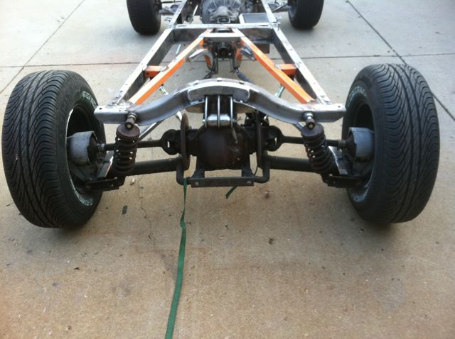

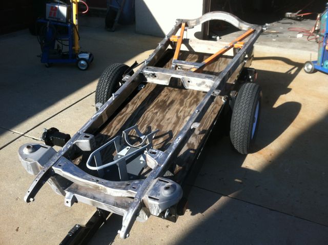

  15. jimbousman
    Posts: 549
    jimbousman
    So here's the frame so far including shipping it off to powder coat.
  16. bluestang67
    Joined: Feb 7, 2007
    Posts: 589
    bluestang67
    I like it , will be a great driver with no flip over worries .

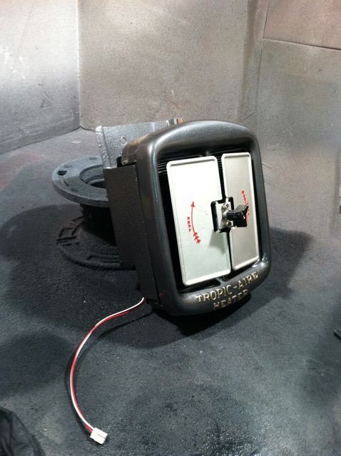

  17. jimbousman
    Posts: 549
    jimbousman
    Yup, me to. I started rear traditional. Some may say I went south from there while it may not be traditional, it's still in the spirit of "build what ya got hot rodding".
    So here is some of the rest of the stuff including the heater, brake/clutch sub assembly, firewall rims, and engine do dads.

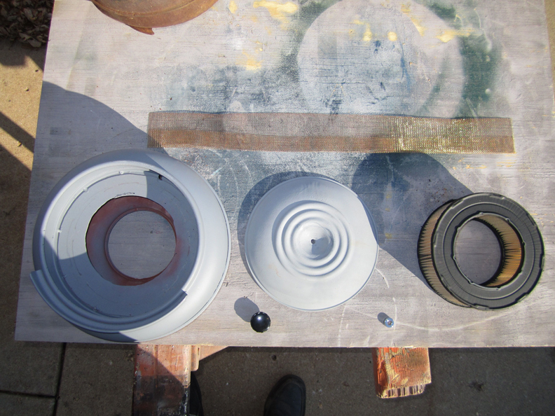

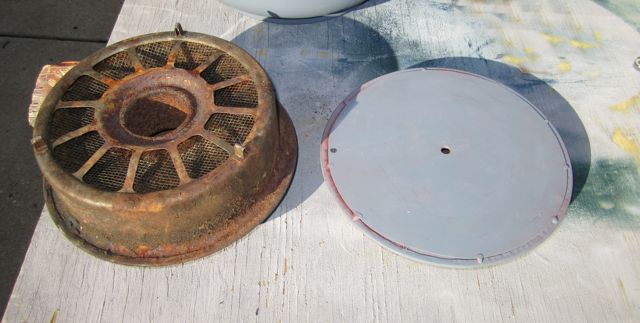

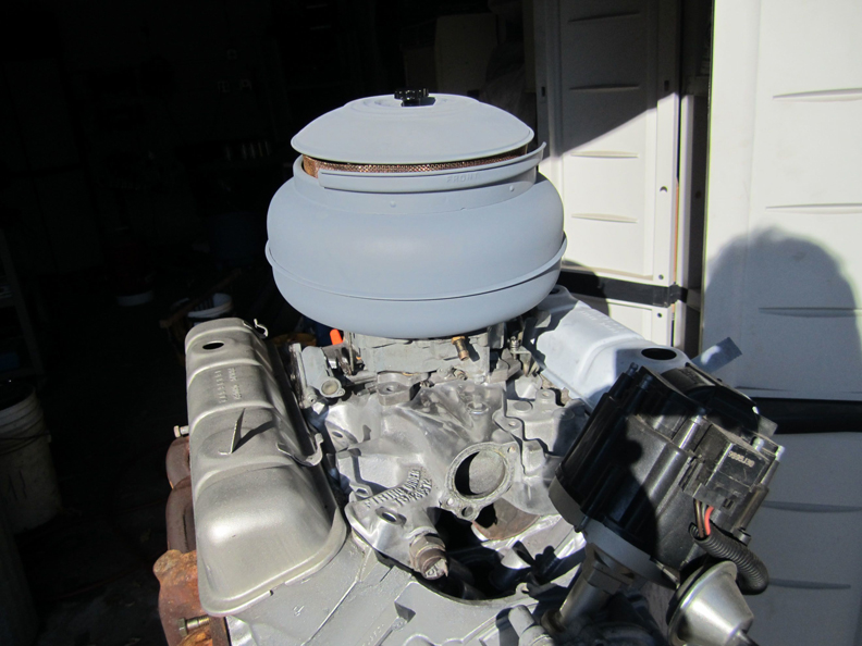

    Aluminum V8 would be a 215 correct?
    You're lucky to find a bellhousing. They are $450 used.
    I'm interested in seeing how you did the air cleaner.
  22. oddcraig
    Joined: Aug 14, 2011
    Posts: 87
    oddcraig
    Looking good so far cant wait to see it develop further
  23. jimbousman
    Posts: 549
    jimbousman
    Yes, it's a 215 with a modified 300 crank, Kenny bell cam, Rover cast headers, running a stock Quad Four for now. I bought the bellhousing from D&D.
    Here are a few more details on the air cleaner. It was an old pumpkin style old bath. Ford I think. I gutted it and welded in a baseplate for the bottom of the paper filter. I cut down the bottom of the lid and welded in a flat plate to fit on top of the filter. I cut the bottom and grafted the bottom from an old Buick Q4 carb air cleaner base. I extended the threaded rod to screw the whole thing together. I sourced a Toyota filter that fit the top then fold a roll of brass screening to add a little sparkle and cover up the paper filter. When all done I powder coated it along with the valve covers.

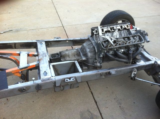

  27. jimbousman
    Posts: 549
    jimbousman
    Yup, we've got chuck holes here the size of Geo Metros. Here's a photo of the engine tucked back into the fire wall after fabbing the recess with the radiator in place. The nice part about the whole deal is the stock toe boards still fit in the original place so no foot room is lost.
