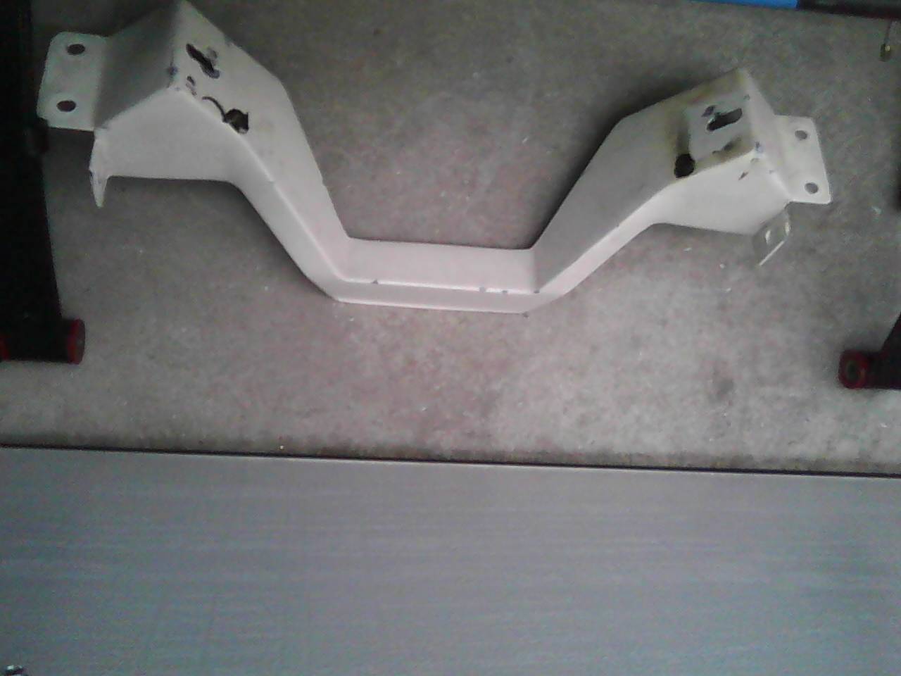

    What kind of cross member is that?
  6. 63FalconFutura
    Joined: Feb 18, 2010
    Posts: 308
    63FalconFutura
    from Socal

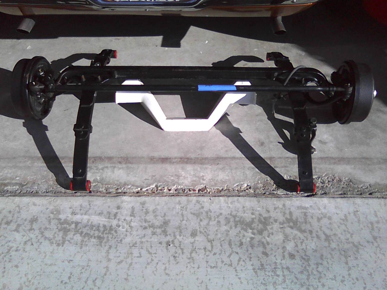

    i got it from pomona swap meet with the straight axle.. the guy said it was a custom made and he had it porcelainized

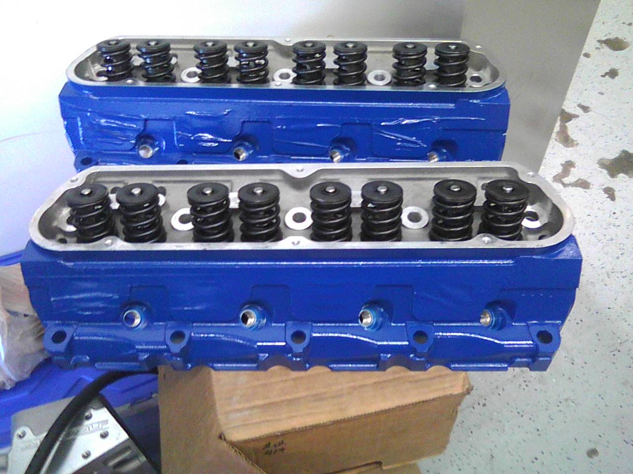

    well i got my new aluminum heads today and started working on those

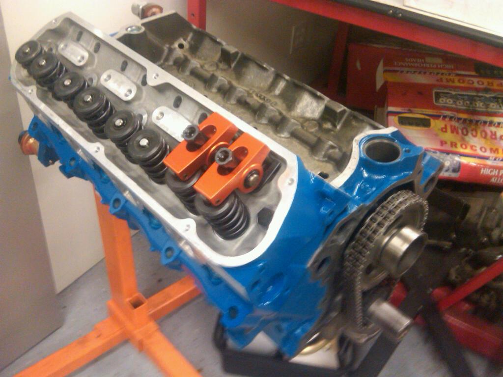

    finished porting the new aluminum heads today flow 260 cfm but they have a bigger combustion chamber than the old iron ones (47cc) so we are at 8:1 comp and hp will be down a bit but it will sound beefy with the big cam and low compression... the engine should be finished soon. Ordering axles and bearings, the car is to be mini tubbed in about 2 weeks, getting caltracs bars (gunna get powder coated white) and springs. Well there is a bit of an update for u guys making progress
