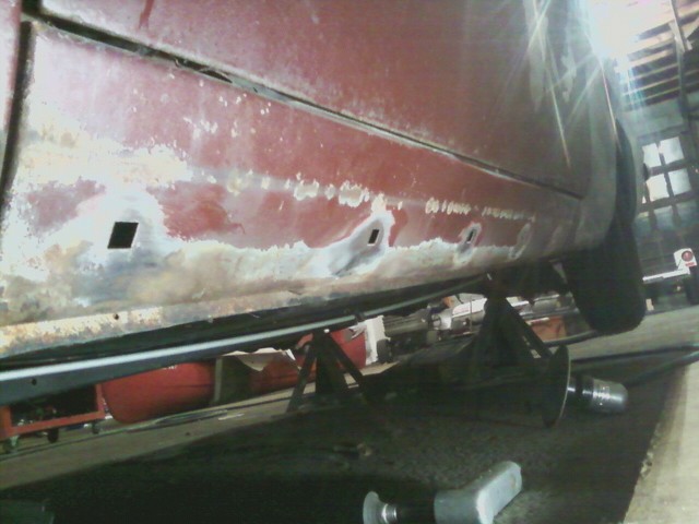

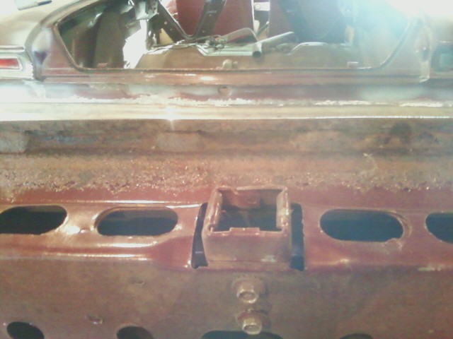

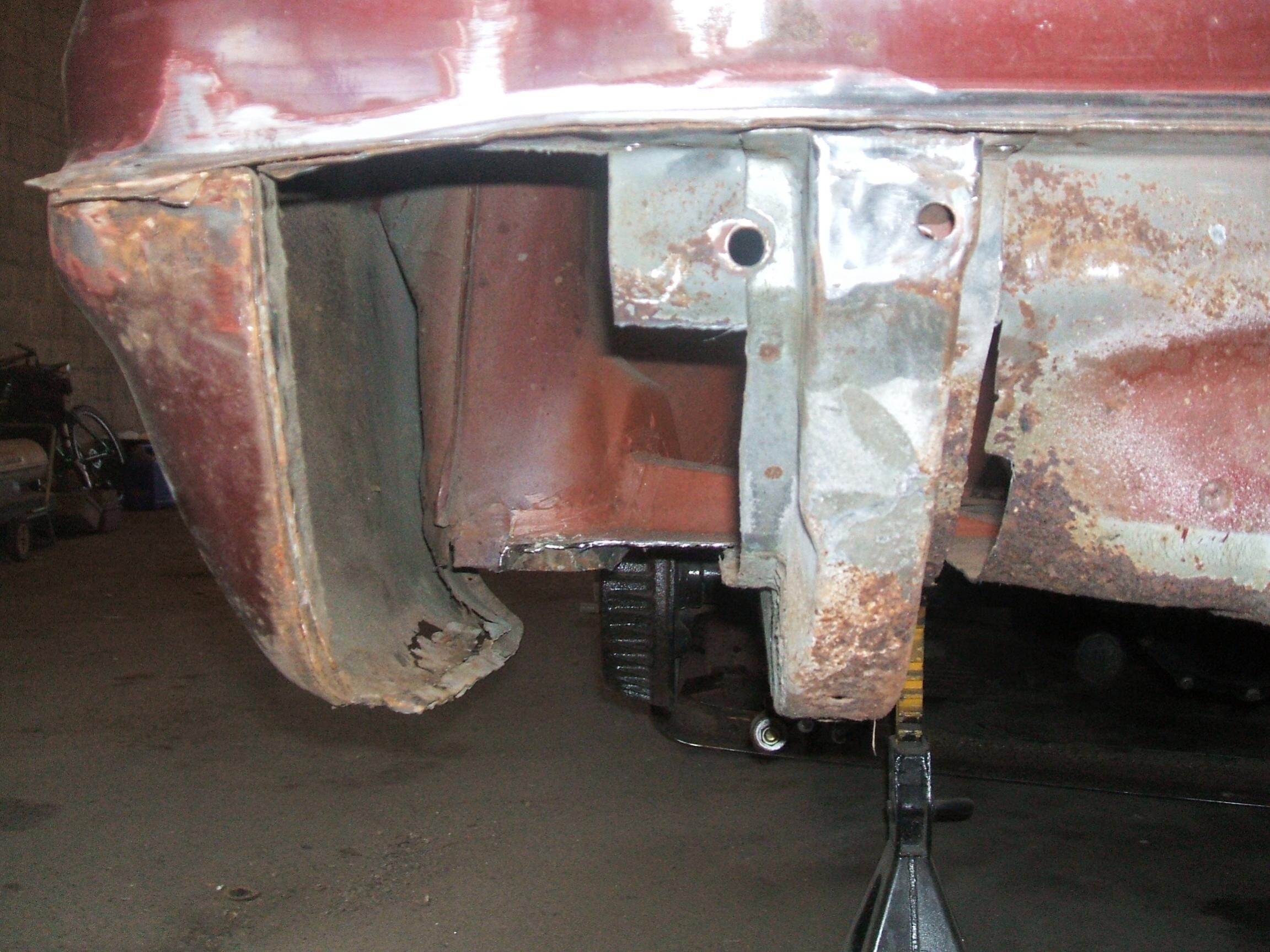

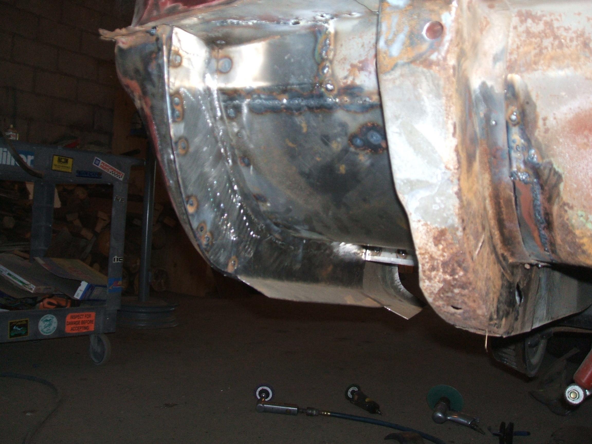

    Here is my buick I am working on, Hoping to have it road worthy next spring. I just finished the metal work in roll pan and quarter panels. I am looking to make it it a mild custom. I made my own roll pan with a recessed license plate and moved the bumperettes in the center. I have removed some of the trim pieces on it as well. I think I want to keep the paint scheme the same burgundy and white maybe with lace in roof. I want the lace to be subtle though. I did lower the car a couple inches but I would like to go a few more. I am thinking of just painting the stock wheels black and putting on bullet lugs and center caps.. Whitewalls maybe? Looking for input, let me know what you think.
  2. haroldsrodshop
    Joined: Apr 11, 2010
    Posts: 31
    haroldsrodshop
    Here is some pics.

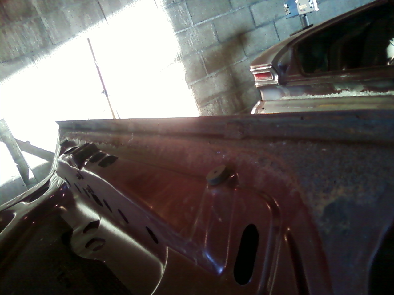

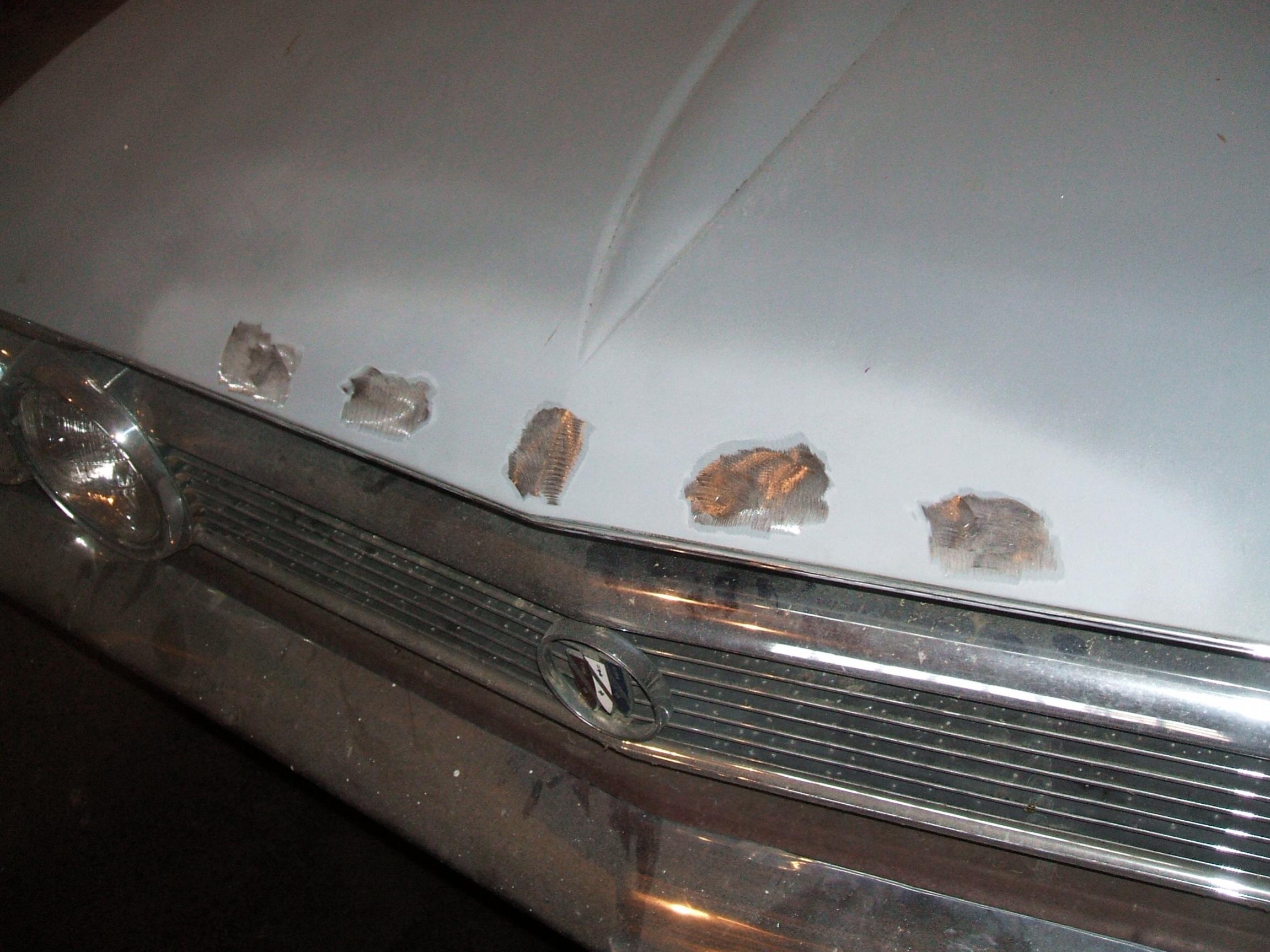

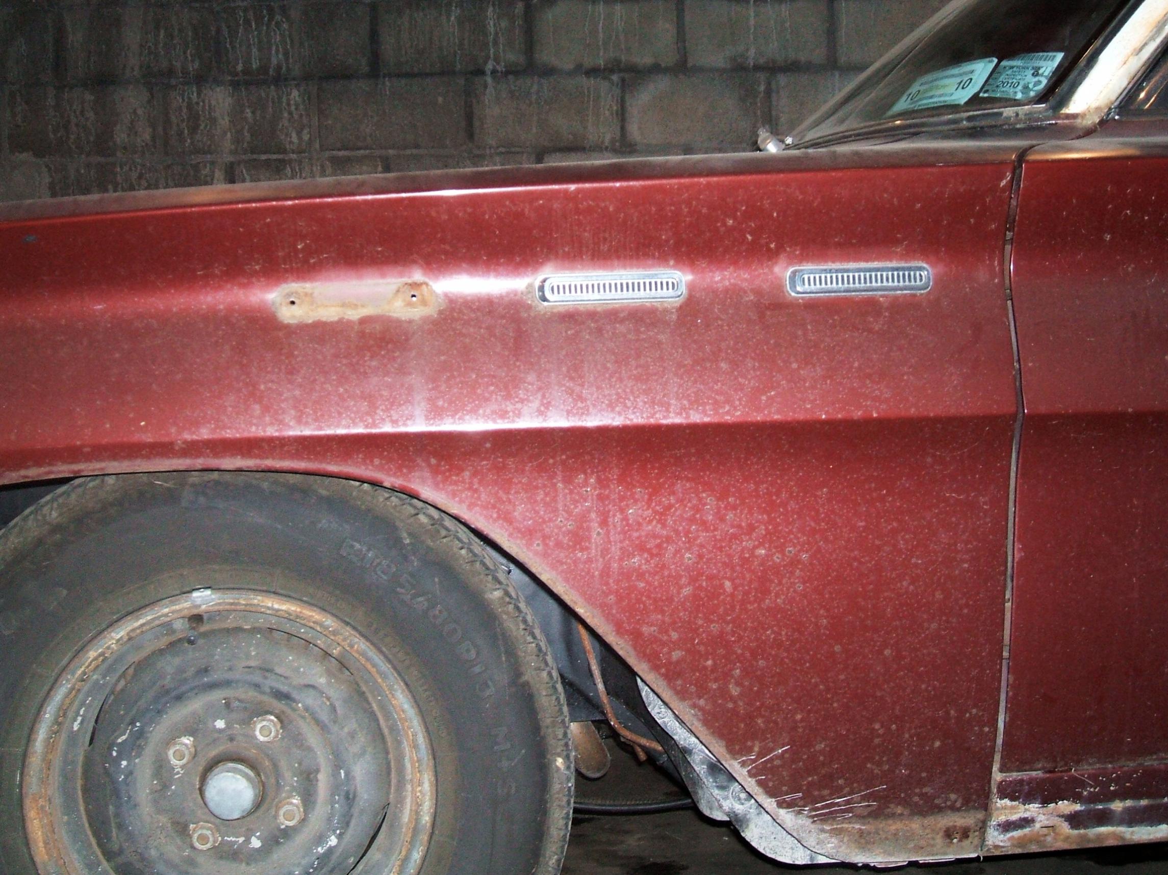

    I am removing some of the chrome trim and all of the emblems on my car. Got rid of trunk trim, long taillight extensions on the Quarter panel , rocker trim, wheelwell trim, and the lettering on the hood and deck lid. Going to something different with the portholes in the fenders too, got some ideas just havnt settled on anything yet.
    I am considering getting rid of the drip rails, just because they are really big. I know this has been done. I am wondering though, will I have leaking issues if I do? I plan on driving the car alot and dont want water issues. I can always just make them a little smaller too... or just leave them alone. What do you all think?
    I am also looking for a source for the short tail light extensions that came on the 62 specials. Anyone know where I can find some?

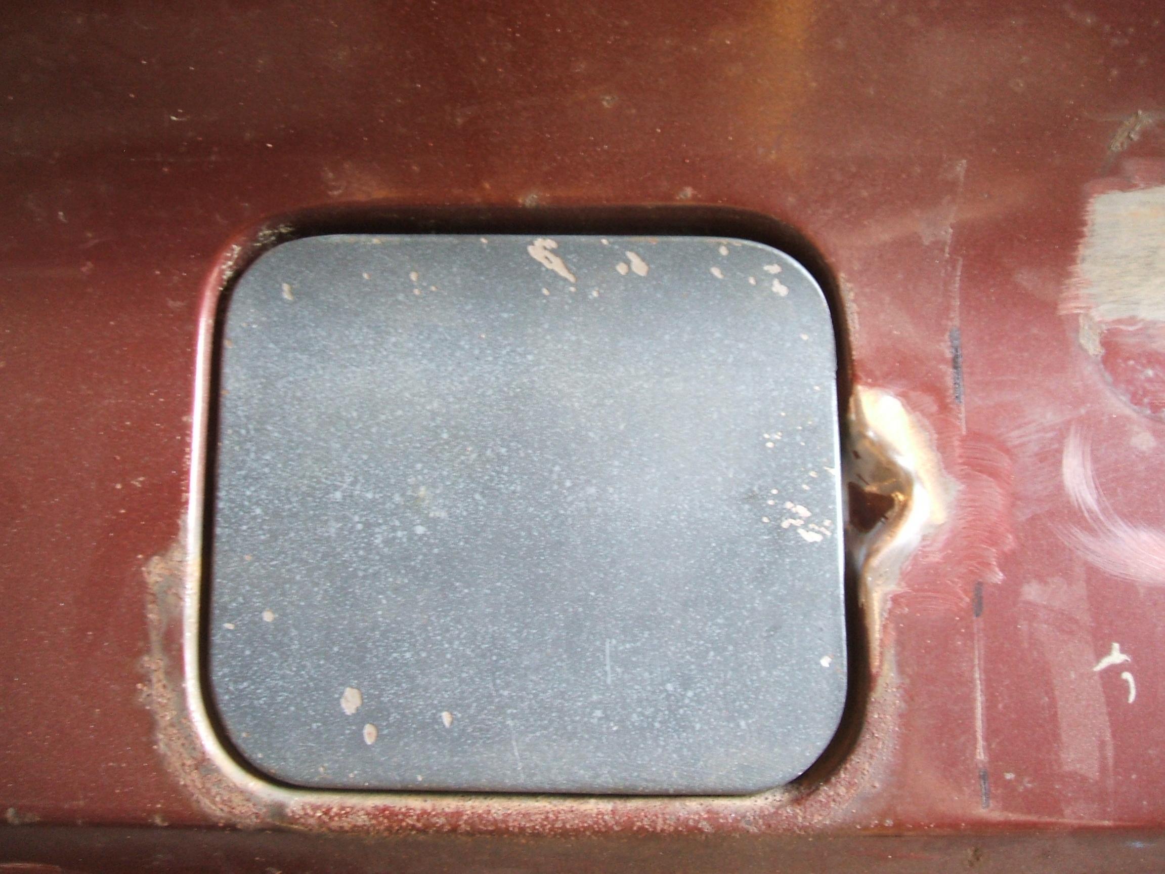

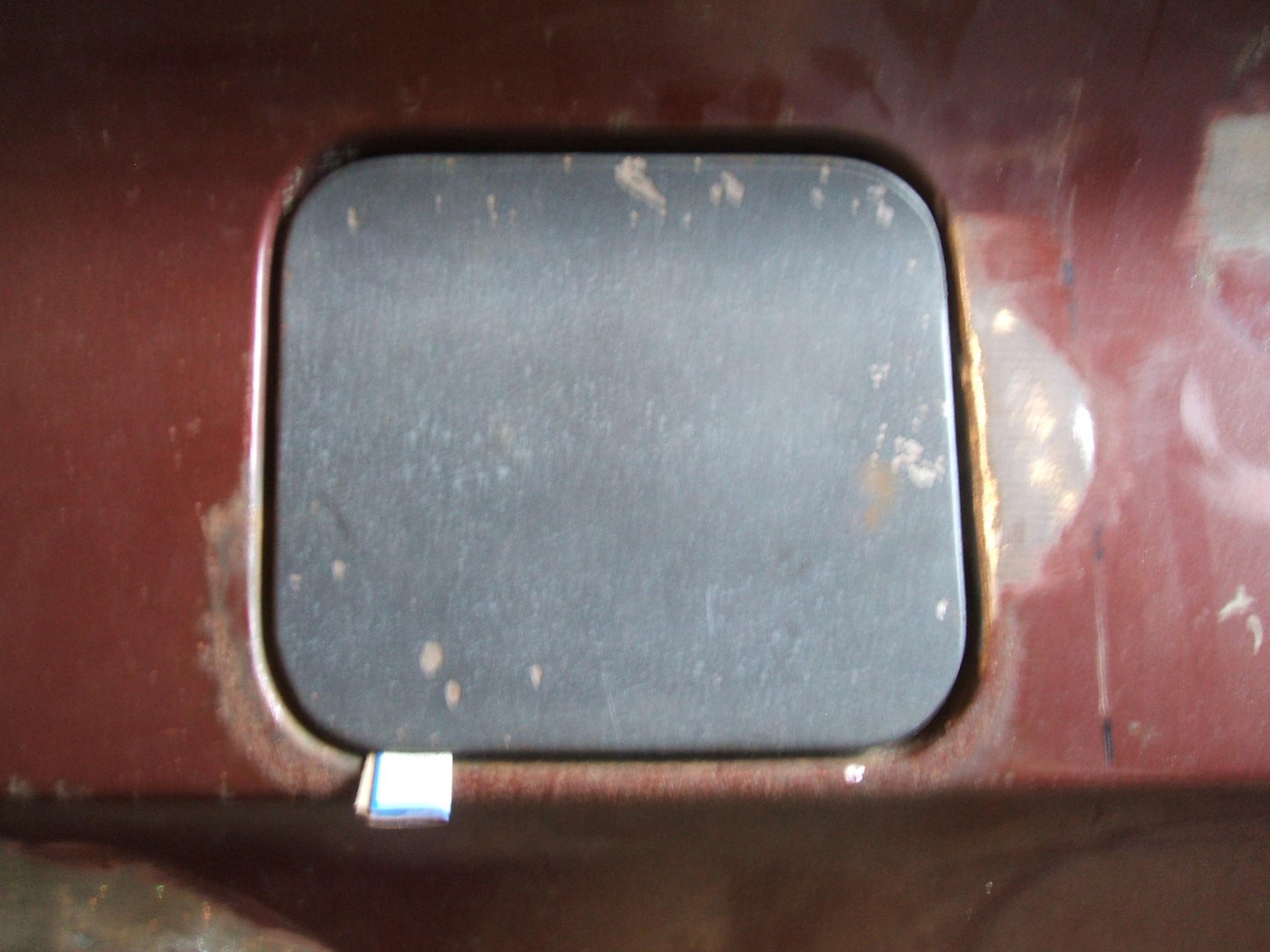

    Didn't get alot done the other day but here is what I did do... I finished filling the trim holes in my rocker panel, filled in the antenna hole, and removed the deck lid to address some rust issues on the bottom lip. It isn't severe but bad enough that I need to replace some metal. Excuse the bad pics, I used my cel.

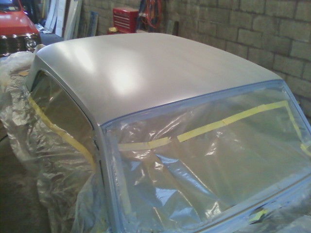

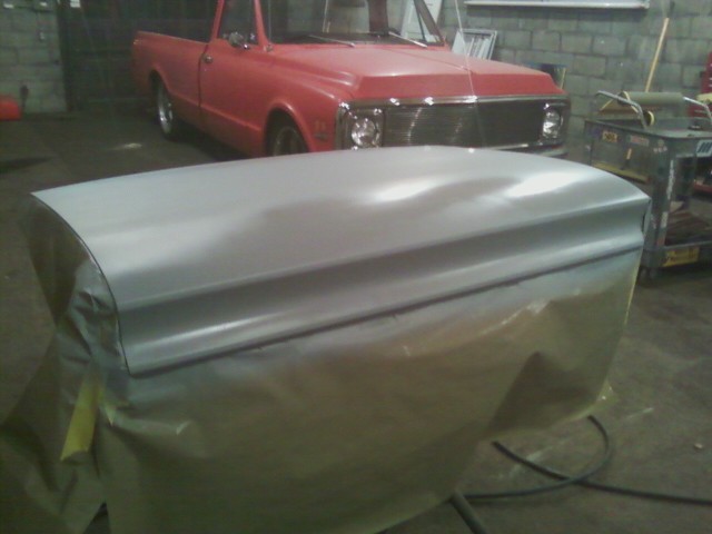

    So I made a little progress in the last few weeks... Got some of the car in primer and making some headway with the bodywork. my goal is to have it on the road by June 1...cuz I have some other work lined up to be on at that point.
    Don't think I am going to the lace on top now.. thinkin of doing the original burgundy and white... who knows? I will change my mind three more times before paint flies:D

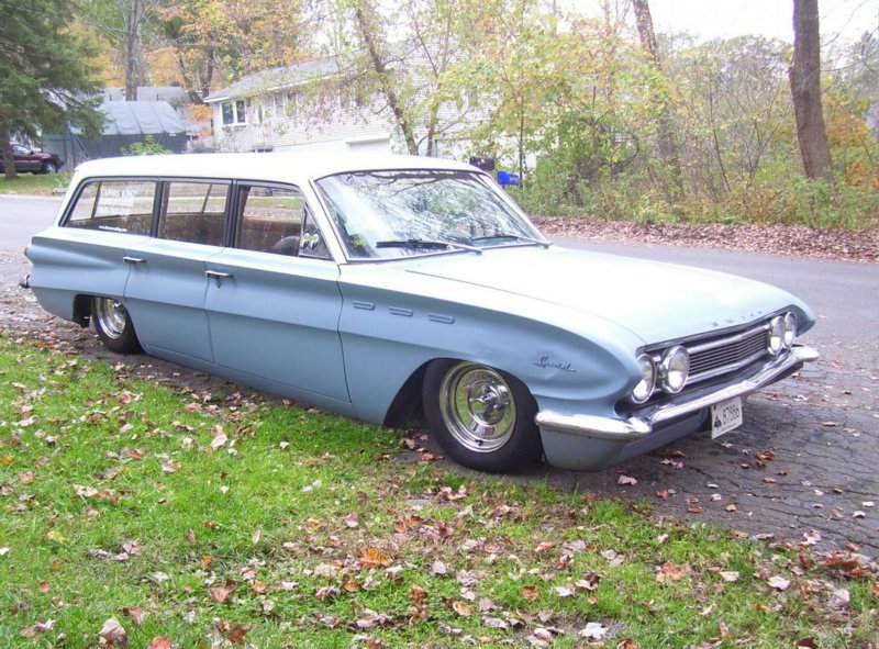

  28. Man I love the 61/62's, but I ended up with a low milage '63.
    I'm in the middle of doing the scare bird disks.
