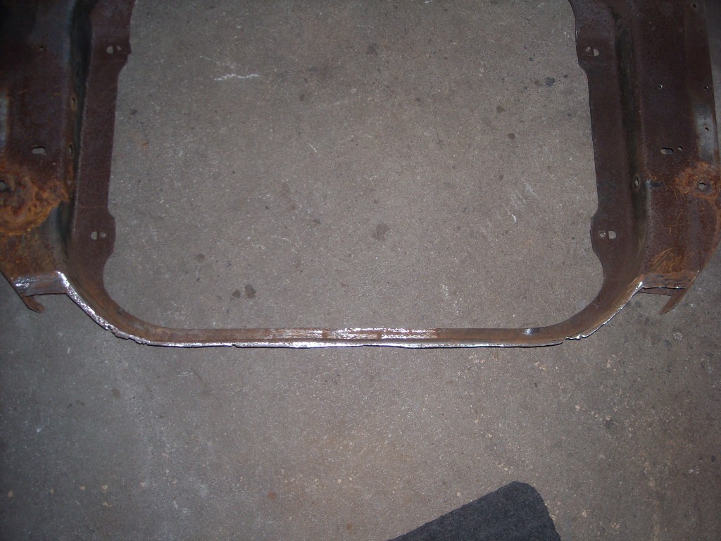

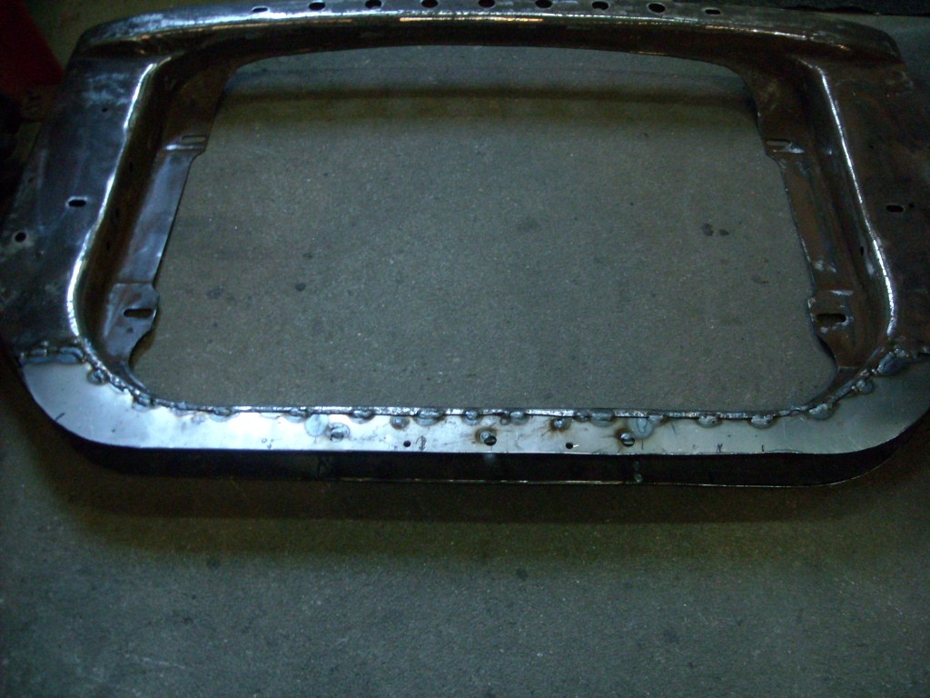

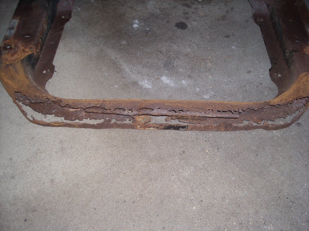

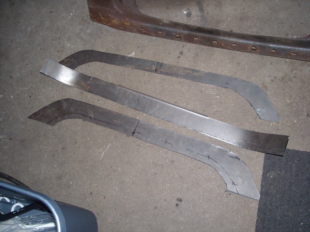

    Next on the Edsel list is repairing the core support.
    I am going to paint it, and the fresh air parts "black" of course!

    My radiator core support was also rusted through - and this is on a car that had good floor boards etc. They must be a weak item.

    I am bringing back my thread. Work on the wagon has started back again. This fall I painted the core support and am currently putting all the engine accessories back on, along with aerostar front springs.

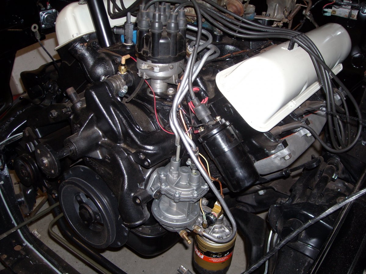

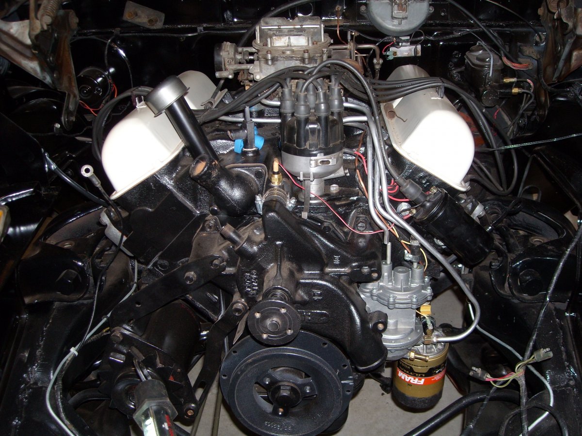

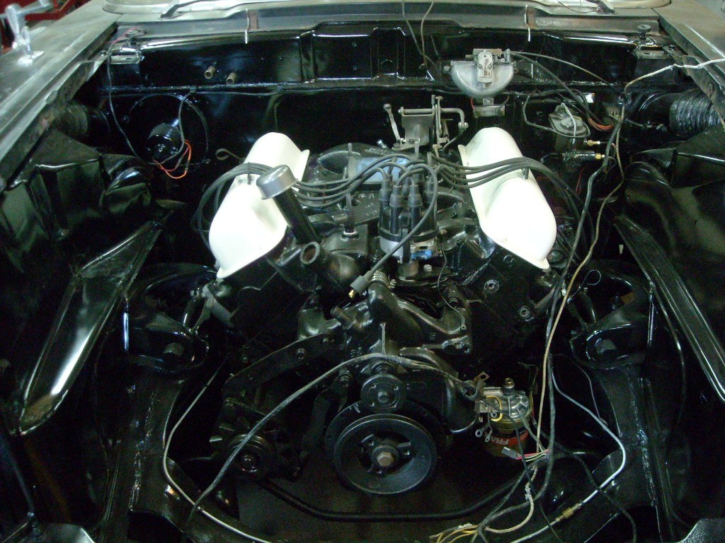

    A couple of pics of getting the engine bay together.

    I didnt realize how dusty it was till I looked at the pics.:eek:
    Thats what I get for it setting for 2 years.

    The paint is a satin, but turned out a little shiney. Its not running yet, but getting close.

    Its getting closer to fireing. All I need is the carb to run it. Sure there are tons of small items before taking it flying down the road, but I want to hear it run.
    The under the hood is finished! Fuel is in the tank! Radiator is full!, and it will crank over with the key, and it had fire.
