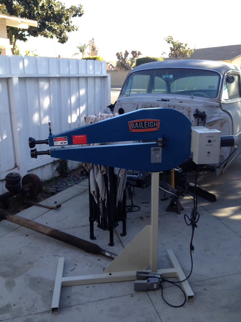

  29. ftwmfer
    Joined: Jan 24, 2013
    Posts: 79
    ftwmfer
    from Orange Ca
    This should help when it time to do the trunk!!!
  30. layedout49
    Joined: Jan 15, 2008
    Posts: 483
    layedout49
    I'll deff need one of those when it comes to doing my trunk as well ! How did that taildragger and mII work out ? Looked like a simple install . Nice work
