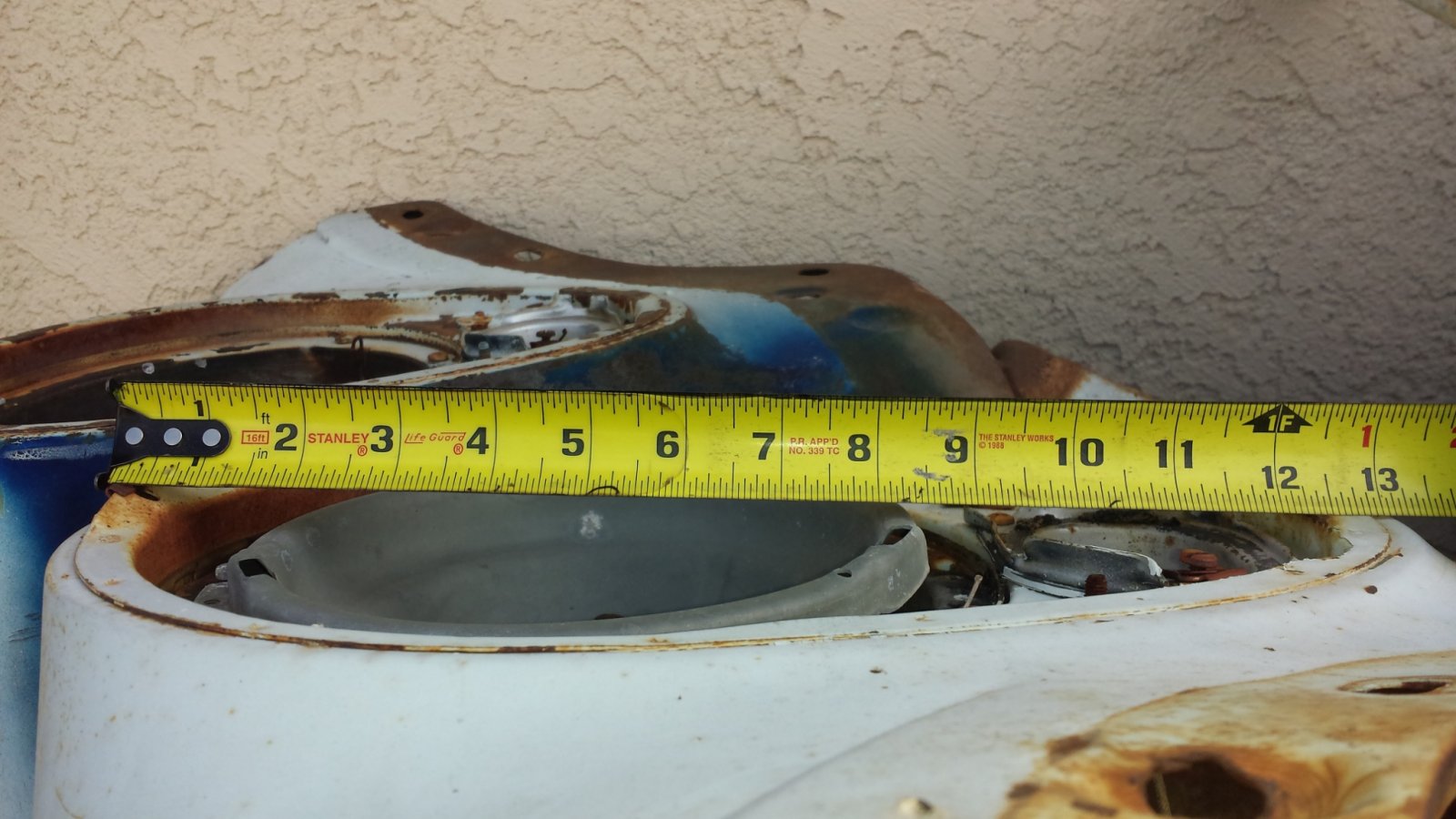

    Hey was wondering if you can check the headlight bezels on your 53 for me? Just wondering if they are pot-metal and cant be welded or if they are mild steel and can be welded.
    Guy came to get some 55 a arms from me and said the 53's were ok to weld maybe. Thanks. Oh and what do they measure top to bottom from the back please?
    Heard the 53 may be a bit smaller than 54 bezels.

    That guy was me..lol knew id find you here some day.. I have a pair of 53 fenders and they measure 13"

  27. Black Clover Custom
    Joined: Dec 20, 2014
    Posts: 500
    Black Clover Custom
    Nice! Thanks a bunch man. Got my 54 all ready for the move with a 401 in it. Scored a muncie m20 wide ratio 4spd too. Hows your car?
