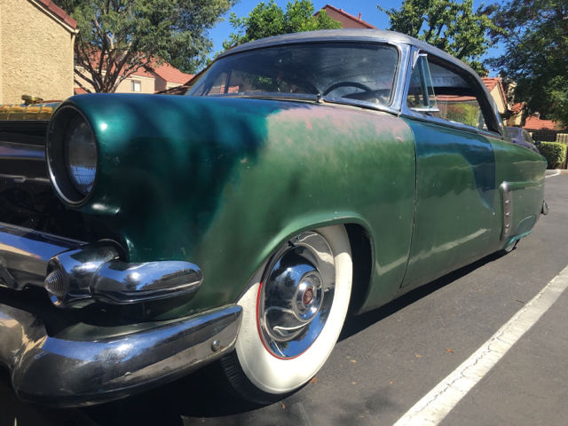

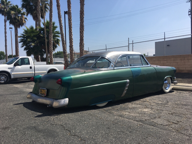

  25. Hey guys. Sorry it's been a while.
    I guess I've been mostly preoccupied with these two beauties. [​IMG] Elizabella Renee and Scarlett Skye born April 10th.

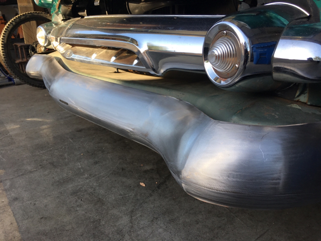

    While we were in the hospital with them, I had my bumpers stripped, straightened and had the bolt holes filled by V&C Metal polishing in north Hollywood. They did a great job.
    Chrome will come later.
    I've been driving the car to work every day this week since I'm working a little closer to home now. [​IMG]
    I also got the hood installed a few weeks before the girls came. It still needs some adjustment, but at least it closes and locks now.
    I took that pic last week when I got to cruise with my dad. He came out from Phoenix to pick up that 40. He's owned a lot of cars in his life, but never a 40 ford. It has always been on his list. It was good to cruise around with him again. His plans are to put wide whites and chrome reversed rims on it.
    Mechanically, my car is pretty solid now. Runs and drives great. The windshield does need to be replaced, so after that, i will be able to focus on body work and modifications. I plan on doing a kustom grill treatment, molding the front fenders to the valence and body and rounding the hood corners. still deciding if ill be running any type of side trim.
