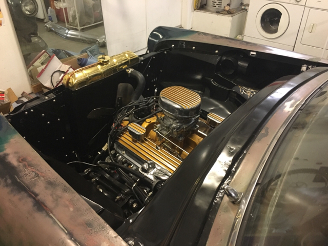

  1. After doing some research it sounds like adding a PCV valve on one of the valve covers might help some of the leaking issues.
    ImageUploadedByH.A.M.B.1465695911.166792.jpg ImageUploadedByH.A.M.B.1465695923.750857.jpg
    Out for a little spin. I ended up putting the second pair of valve covers on it so the breather would have a better fit until I can get the grommets posted earlier. Also installed a pcv. It may have helped somewhat with the backspray but I think this big finned breather is just too open and oil is dripping out of the bottom. The car is fast and loud though. Just how I like it. B

    Read both of these: http://www.fordmuscleforums.com/all-ford-techboard/475686-pcv-system-302-a.html And this: http://www.jalopyjournal.com/forum/threads/302-ford-eng-do-you-need-a-pcv-valve.623257/ Had problem with valve cover gaskets too,Fel-Pro and Mr. Gasket cork swapped to these and added baffles and problem solved http://www.ebay.com/itm/FORD-MUSTAN...ash=item35f1de95c9:g:aawAAOSwEetV-gm5&vxp=mtr Still get some oil around the breathers so will add a hose to the underside of the air filter to complete the system.

    Check your connections to the Carb with this ;) carb.jpg http://www.laroke.com/larryk4674/2009/AFB_Rebuild_Guide.pdf
