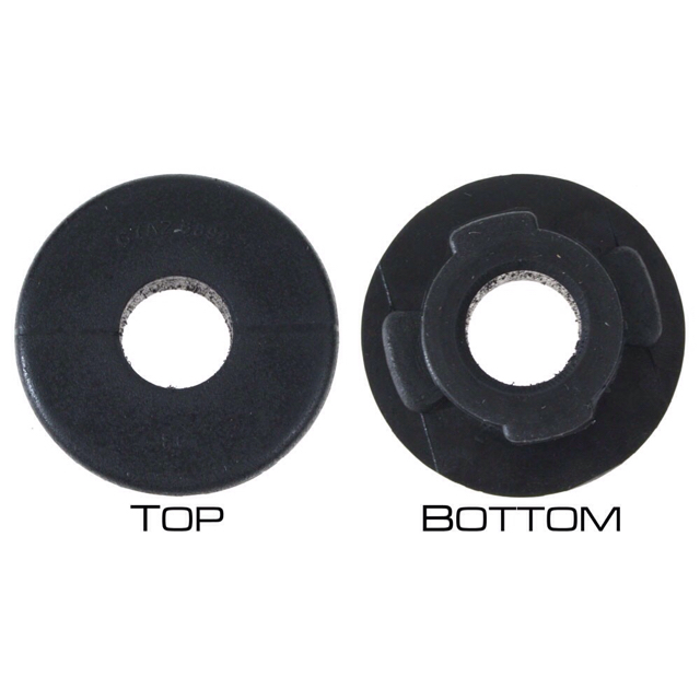

    I've got a question. These valve covers have an opening for a twist on style breather and my breathers are the push on style. Do you think a little bit of sealant to fill up the notches should be good enough to make these work? It would go between the valve cover and the rubber gasket. Also, the valve covers don't have baffles like the ones I just took off. Does that matter? Will a little more oil get through the breather element? Or do I NEED to replace these with some twist on types?

    They make a gasket in the shape of the twist on opening. I forget the part number.
