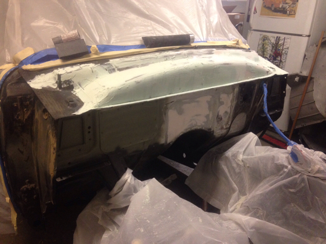

    Started smoothing out the firewall. I've made some progress since this picture. I'm figuring out how to lay the bondo each time I do it. This is definitely one of the harder things I've done. Getting it to lay down smoothly and follow the contours is hard. It makes me appreciate you good body guys even more than I have before.
  7. Laying down filler nicely definitly takes practice, the nicer you put it onthe less sanding you have to do. We all hate sanding:D

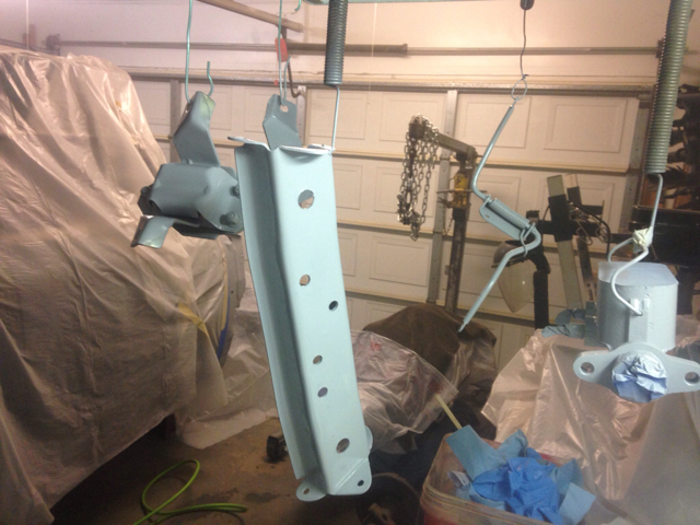

    It's PPG J128 single stage base with J78 gold aluminum toner. The PPG store in Simi Valley mixed it up for me and put it in a can so it could be shot at my engine builders place.

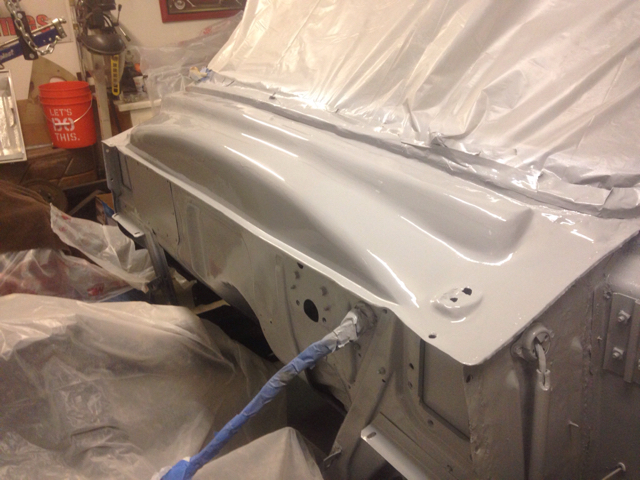

  13. I finally made a little more progress today. I got the firewall and a few random bits in epoxy primer. First time using an HVLP gun. Becides for the massive runs, it came out ok. Haha. I know that I rushed it and tried laying it on too thick trying to cover up my bad body work. Oh well. Now I know. ImageUploadedByH.A.M.B.1450992507.740204.jpg
    RockinRivi and michael knight like this.
  14. greaser 35
    Joined: Feb 15, 2010
    Posts: 623
    greaser 35
    from FRANCE
  15. Looks good. Dont worry about runs, you can always sand em out. Spraying primer is like anything else, just comes down to experience. :)

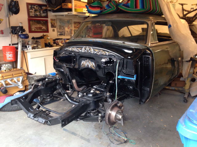

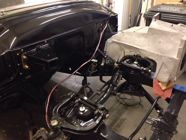

  16. I finally have made a little progress. After fixing the primer runs I got it all sprayed in black. It was supposed to have been semi gloss, but turned out high gloss. Being so glossy really showed more of my bad body work, so I couldn't live with it. Blocked all that out smoother and had the paint shop re-mix some semi gloss with more flattener and resprayed it again. This time I could live with it. It's not perfect, and still glossier than I wanted, but good enough for under the hood I think.
    I Started re-assembling the steering and brake parts today. Waiting to hear back from a pinstriper to see if I can get that done before the engine goes in.
    I got some parts painted in hi gloss to contrast the semi also.
    RockinRivi likes this.

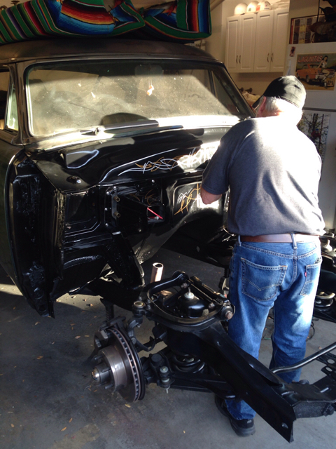

    I'm having the firewall pinstriped today. I'll post picture when it's done.

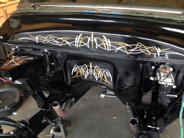

  27. ImageUploadedByH.A.M.B.1454029883.787652.jpg ImageUploadedByH.A.M.B.1454029903.019499.jpg ImageUploadedByH.A.M.B.1454029924.436895.jpg
    I'm pretty happy with it! Can't wait to get it all out back together now!
