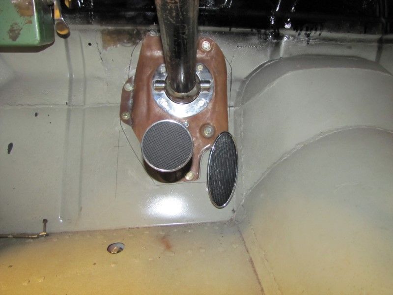

    While i was in Sweden,the gas pedal arrived.I tried to pick the less street roddish looking pedal and i think that will do:
    Its a kind of tight fit because of the transmission tunnel,but i think there is enought room for the foot.
    And there is enought room for the throttle cable too.I just need to clamp the cable,so it doesnt hit to
    the column's shifter lever:

    Looks good with the pedal, good choice!

    I like the throttle pedal.I have a spoon type that is even smaller and I can just barely get my foot in there.Likely because I have a size 14 foot! What I did was trim a little off the side of my (square) brake pedal.I had thought about moving the pedal pad an inch or so to the left by modifying the mount on the arm.If you do have trouble that might work.

    I have size 10 foot,so thats not an issue with the pedal operating.But i think there's enought room for the "bigfoots" too.

    I would move the brake pedal pad to the left. Good progress, keep it going!

    I would like to do that too,but its out of the question with the powerbrake unit.I modified the powerbrake unit and put it so much on the left than it was possible.I got it moved around 2-3" to the left by modifying it.Bolt on parts my ass...

    Those front fenders look mighty good! Antti could you move the brake pedal pad to the left by making the mount piece at the top of the shaft a little longer?

    Think it looks fine with the pedals! I belive the reson they are a little tight is the wider transmission tunnel right? Not mutch to do about that.

    Well,i have thought that too,to modify the pedal arm and move the pad to the left.I guess i could get it to the left around 1" or something like that.1" is not much,so i think its not worth effort.
    You are right,the transmission tunnel is wider and it looks like tighter fit because of that.The brake pedal is pretty much on the same spot where it was originally.I guess only way to fix it,is to get firewall mounted brake booster.But i am not going to do it,i think i can live with that.
