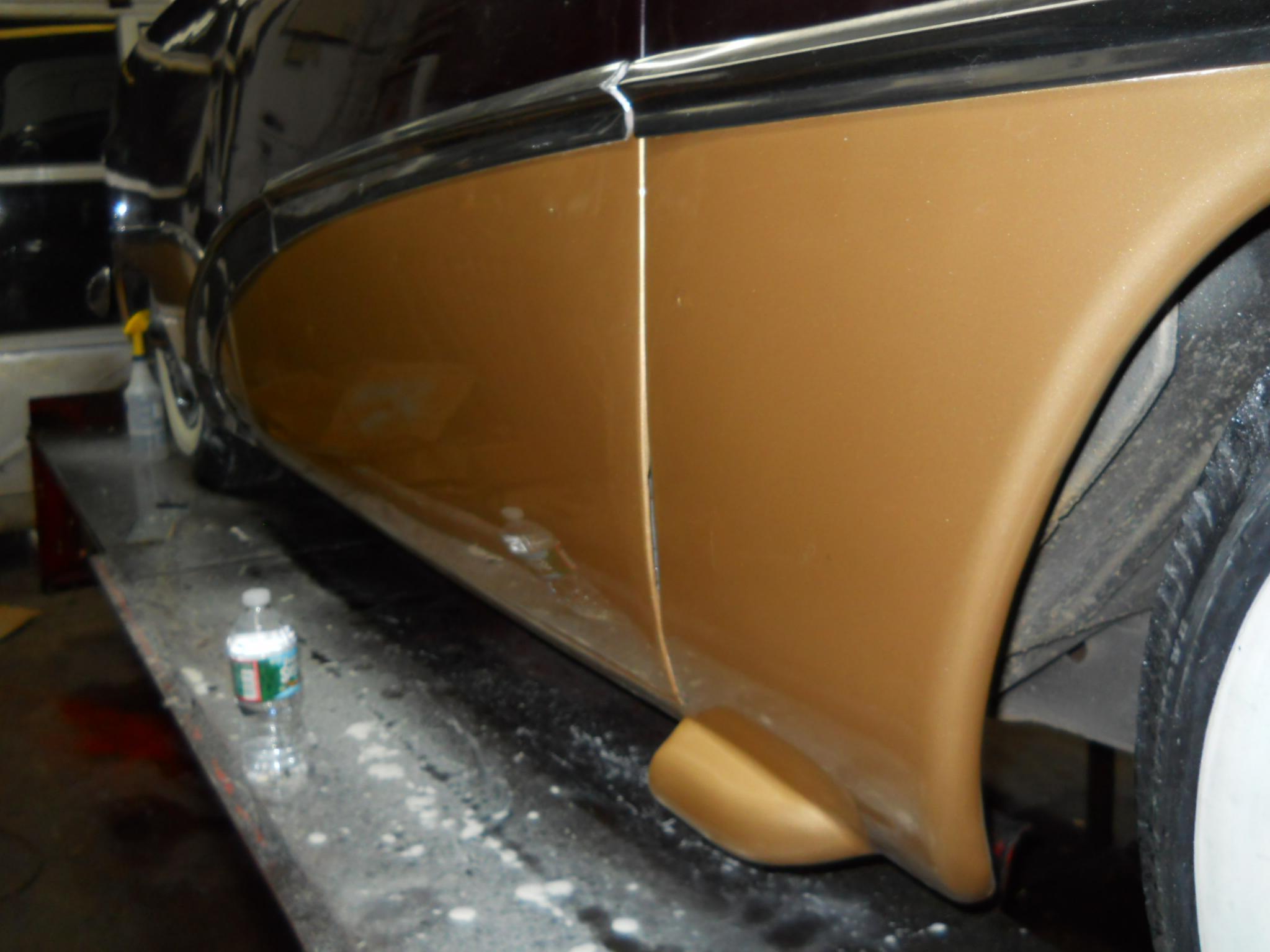

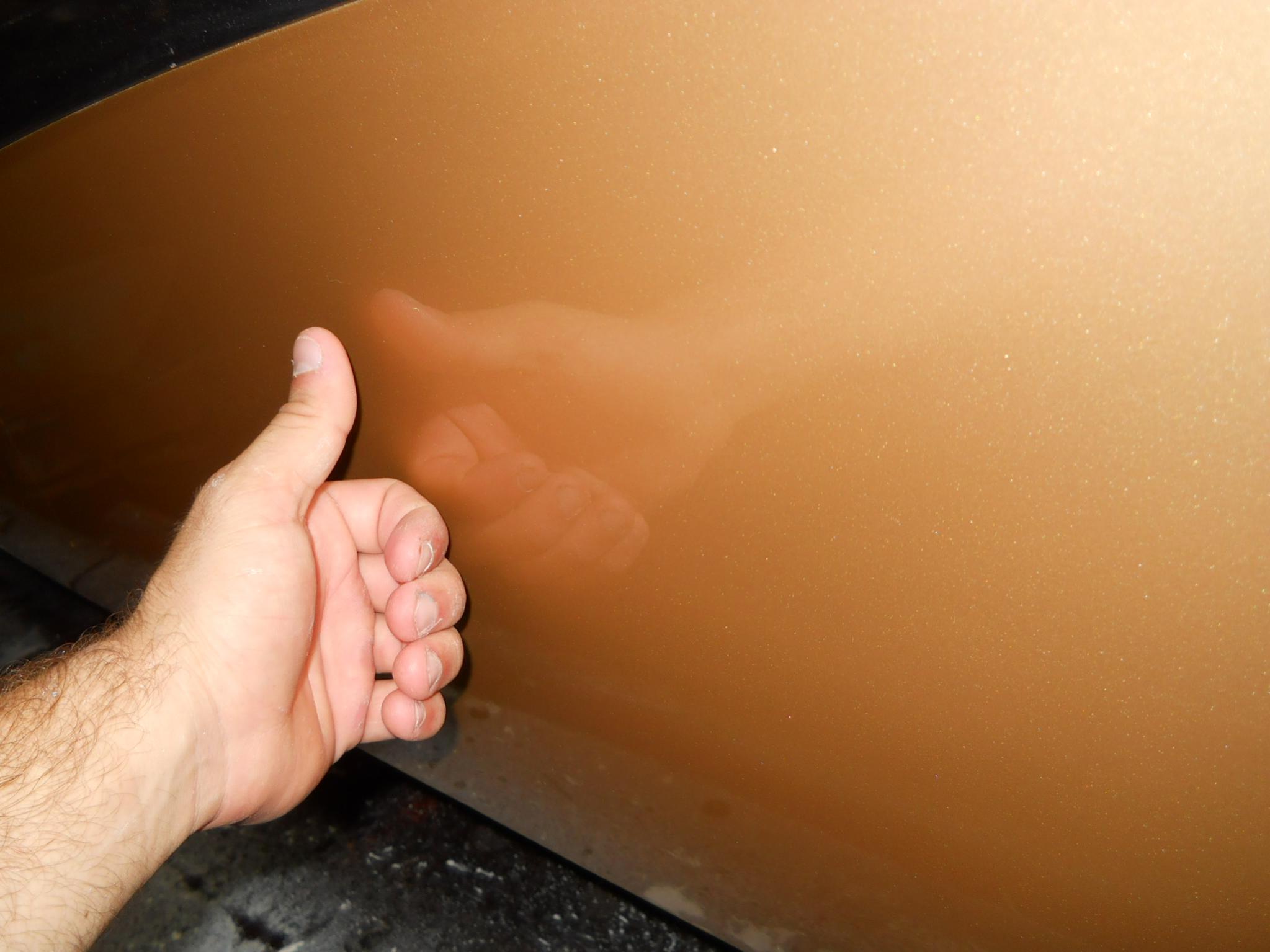

    I finished the passenger side wetsanding and buffing tonight...I'll finish the driver side tommorow.
  6. Fifty5C-Gas
    Joined: Sep 1, 2003
    Posts: 1,428
    Fifty5C-Gas
    Wet sanded and buffed.. Came out great.. Thanks supersized!!

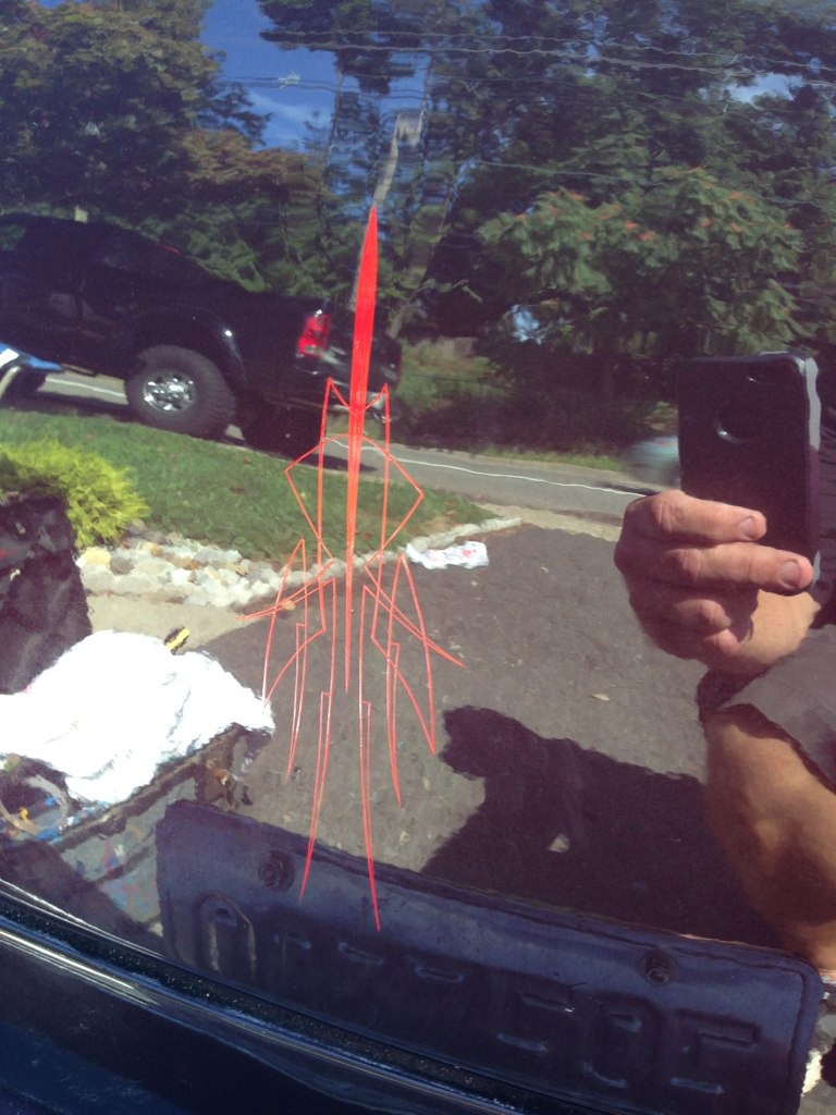

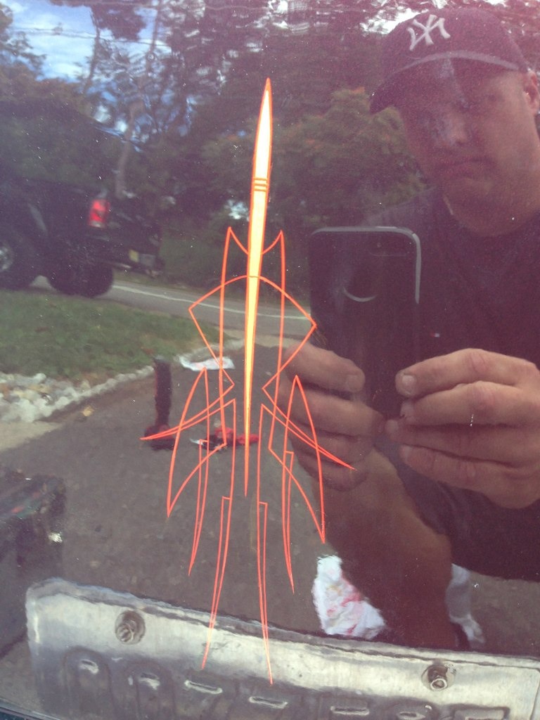

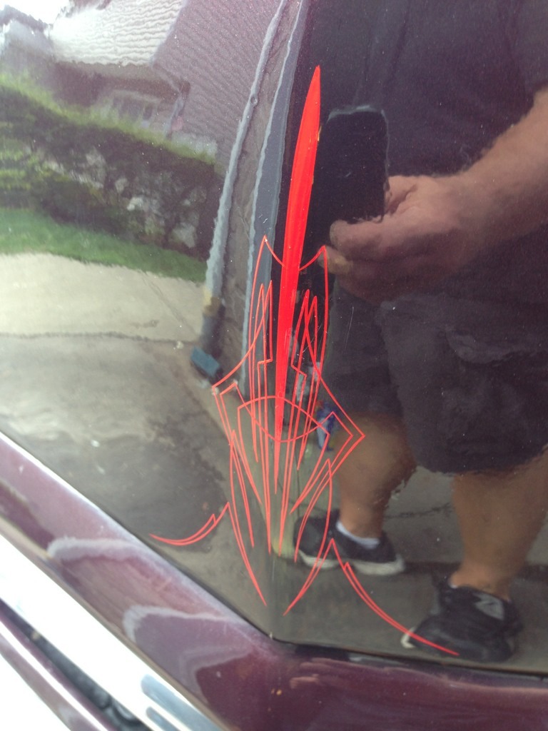

    Today some finishing touches...
    00Mack (Anthony White) came over to do some striping
    ImageUploadedByH.A.M.B.1376161695.255324.jpg ImageUploadedByH.A.M.B.1376161710.654320.jpg ImageUploadedByH.A.M.B.1376161728.854347.jpg
    ImageUploadedByH.A.M.B.1376161787.905022.jpg ImageUploadedByH.A.M.B.1376161818.154853.jpg ImageUploadedByH.A.M.B.1376161842.071408.jpg
    Finished deck lid..
    Finished hood...
    Put the lake pipes back on..
    And matching exhaust tips..

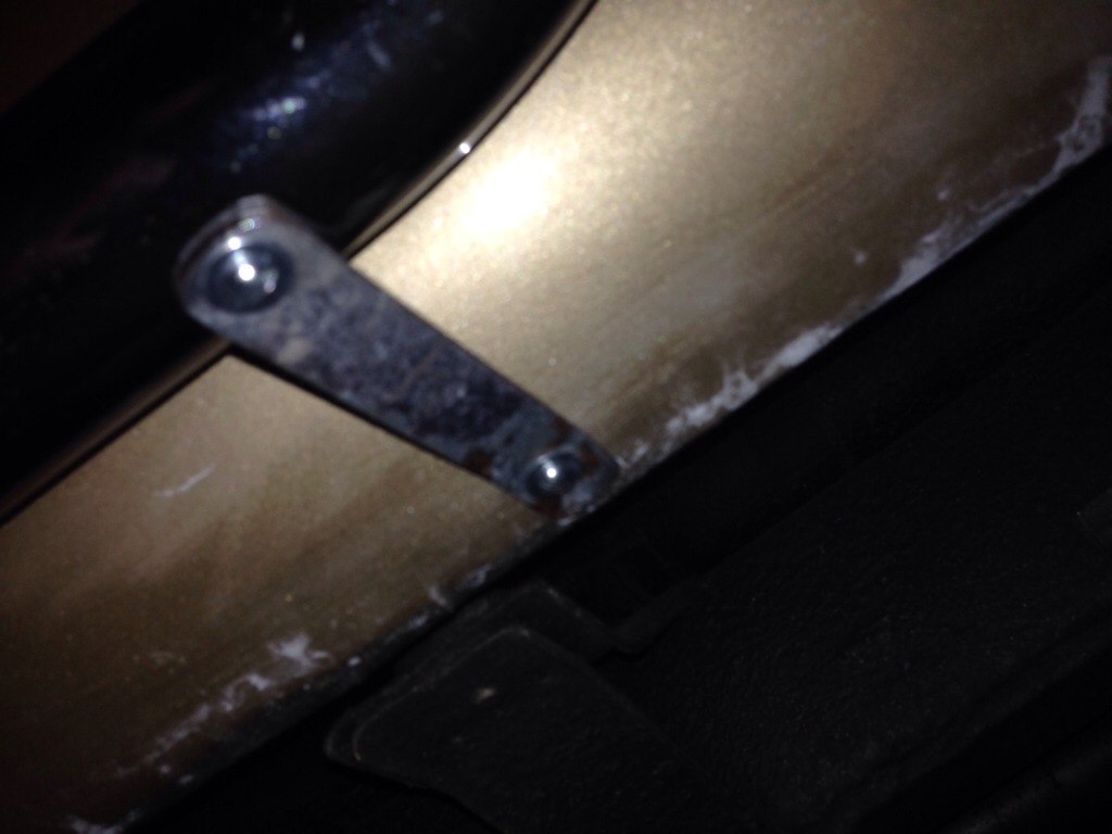

    Can you show me (or explain) how your lakes pipes are mounted? I'd like to do something similar on my car, but I'm a little stumped on how to mount the pipes up along the rockers and keep them sturdy, but as close to invisibly mounted as possible. Got any close up photos with the pipes off that show how they attach?
    Thanks in advance.
  18. Fifty5C-Gas
    Joined: Sep 1, 2003
    Posts: 1,428
    Fifty5C-Gas
    Well the front of the lakers are in the pods, the rears, I put nut serts in the rockers and under the lake pipes, then a bracket (piece of flat stock) I made that hold them to the rockers. If I didn't have the pods in front I would have did the same for the front as I did for the rear.
