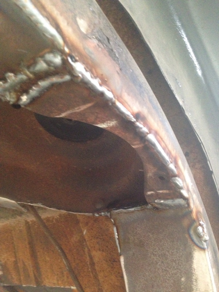

    Small update.
    Both sides are welded on the outside of the chassis rail, a little more welding and grinding then start we will start on the inside of the chassis rail, we are leaving the factory hole in the rail for now to line up the inside of the chassis, The inside if the rail where the rear spring sat the original chassis piece will be placed back in make it look as factory as possible. More pics to come tomorrow.

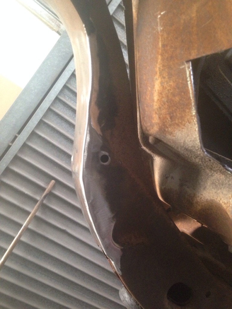

    ImageUploadedByH.A.M.B.1396003987.653814.jpg the outsides are finished, it took a bit longer that I thought..... But happy with the outcome. Next week I will reattach the original inner section and box up the rear crossmember.

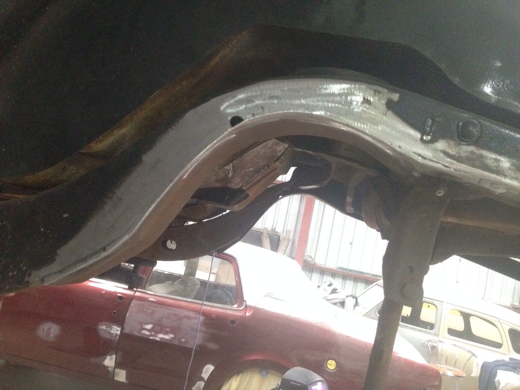

    ImageUploadedByH.A.M.B.1396552554.102840.jpg ImageUploadedByH.A.M.B.1396552568.308297.jpg
    Front part of the inners are finished, now to reattach the original piece that follows around the coil spring.

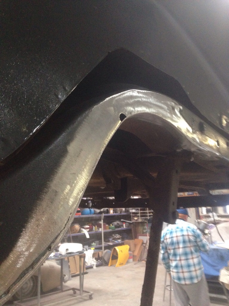

    ImageUploadedByH.A.M.B.1397563997.977445.jpg ImageUploadedByH.A.M.B.1397564011.504612.jpg
    The original inner section is welded back in, it just needs to be ground back.
