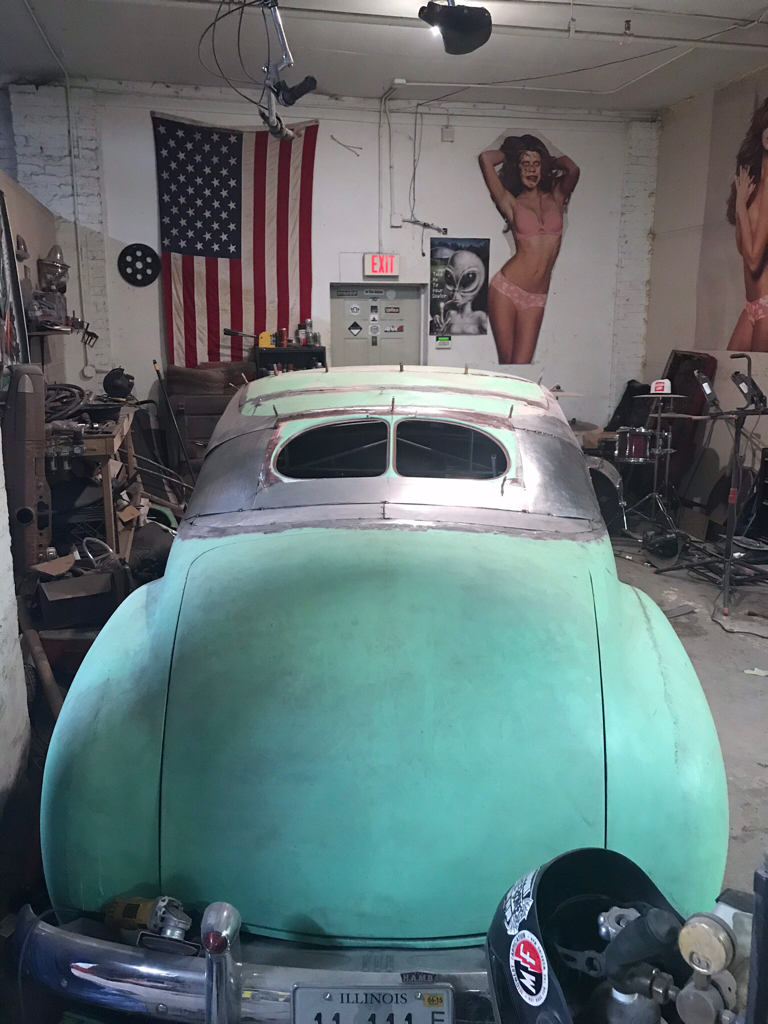

  8. Little progress. The English wheel is hard! but I think I’m getting the hang of it kinda. I’ve got my panels pretty close. I used the same templates for both sides and made both sides at the same time so they match. I’ll probably get this stuff tacked in and use hammer and dolly to fine tune it
    [​IMG][​IMG][​IMG]
    nunattax, 'Mo and Okie Pete like this.
