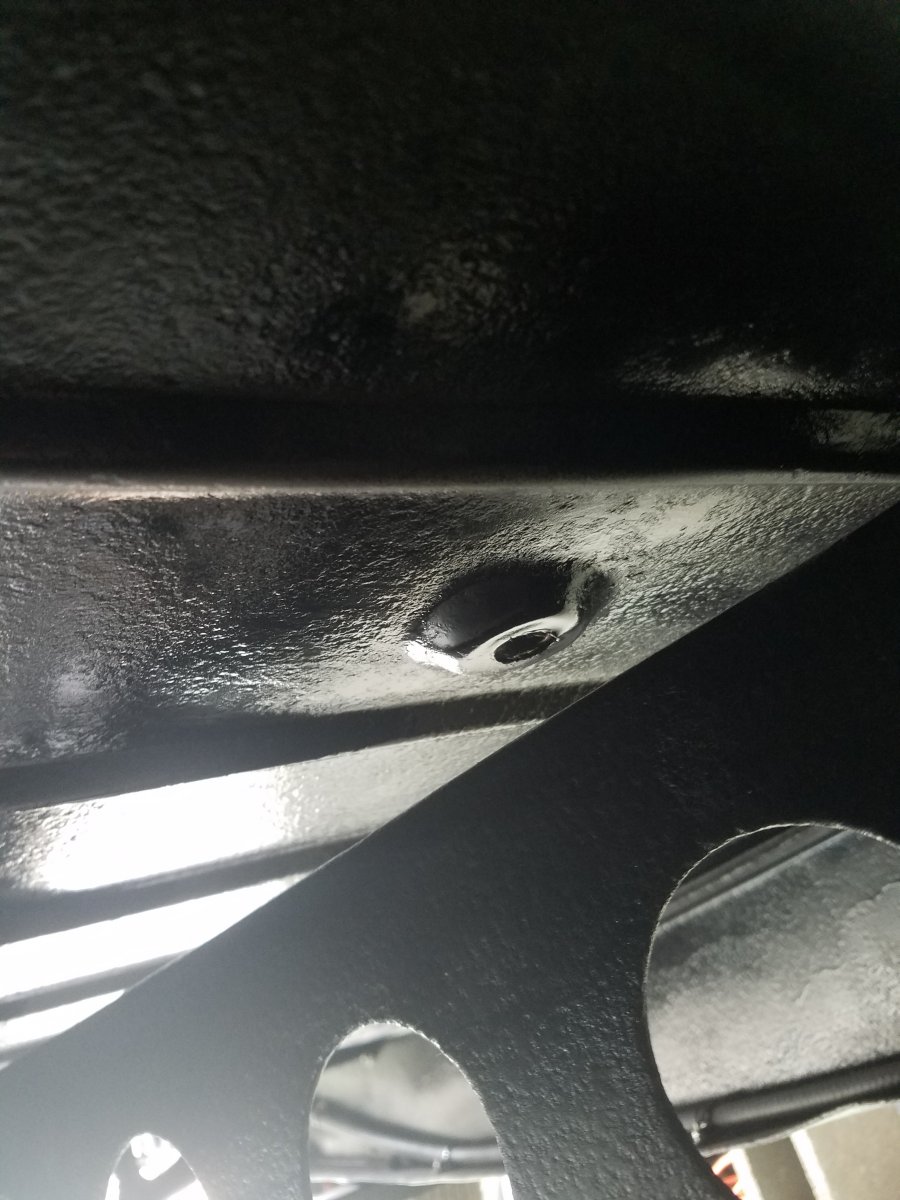

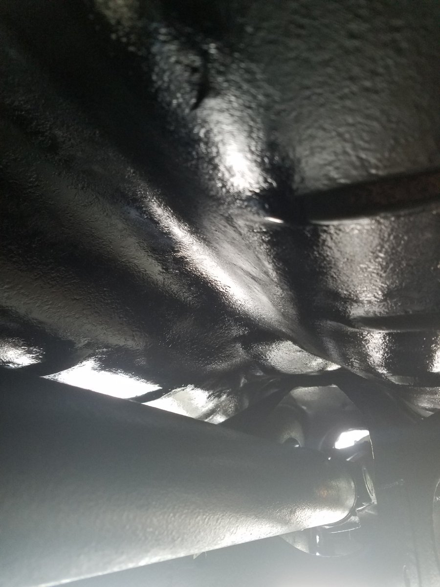

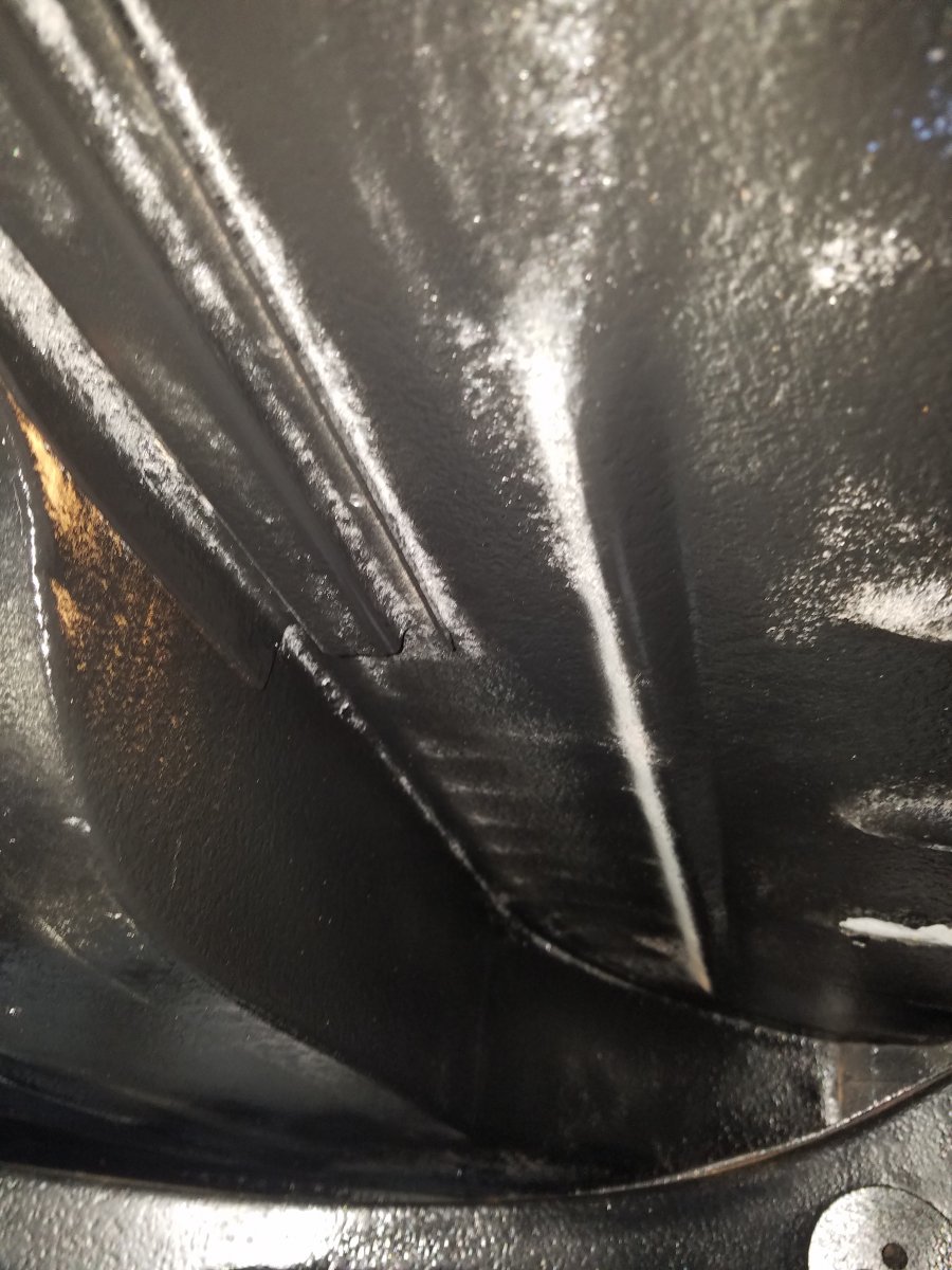

    I've wire wheeled, washed and de-greased the floor pan from the bottom. I am preping for paint. Found some por-15 type paint for allot less money, and its been impressive every where i put it. Also going to add thermal ceramic spheres for some heat reflection properties. I plan on doing a side by side test of its abilities. Bought it from Hy-Tech. For 13 plus shipping i figured I'd try it. I can't afford the lizard skin at this time, and i guess they do a similar product. I've uncovered some rust issues that i don't want to repair correctly(cut out and weld in) due to time issues. How low brow trashy is a fiberglass repar? Want to take my paw in the car before he can't. [​IMG][​IMG]

    I used a grinder with a wire wheel on the bottom of my floor pan also. I just used a self etching primer and an undercoat on it. As far as the rust, I have some of the same issues as you. Some of it Im not worried about since Im not building a show car. I did use a fiberglass filler on some of the small rust spots on the body and its working fine. Im building something between a rat rod and a street rod so its not going to be perfect looking, but the drive line, suspension and brakes are all new and perfect.
    Heres a few crappy shots of the floor pan bottom.

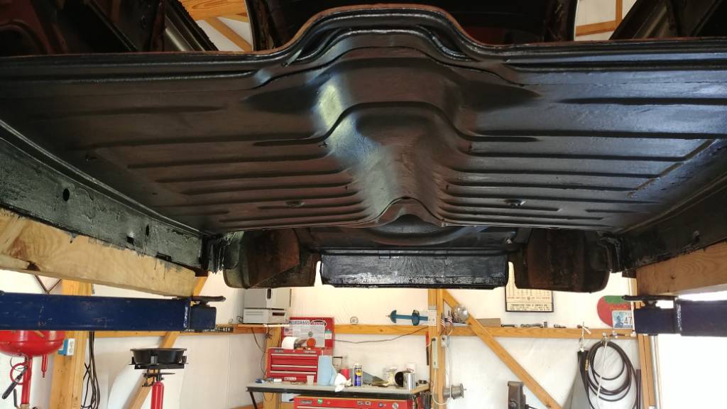

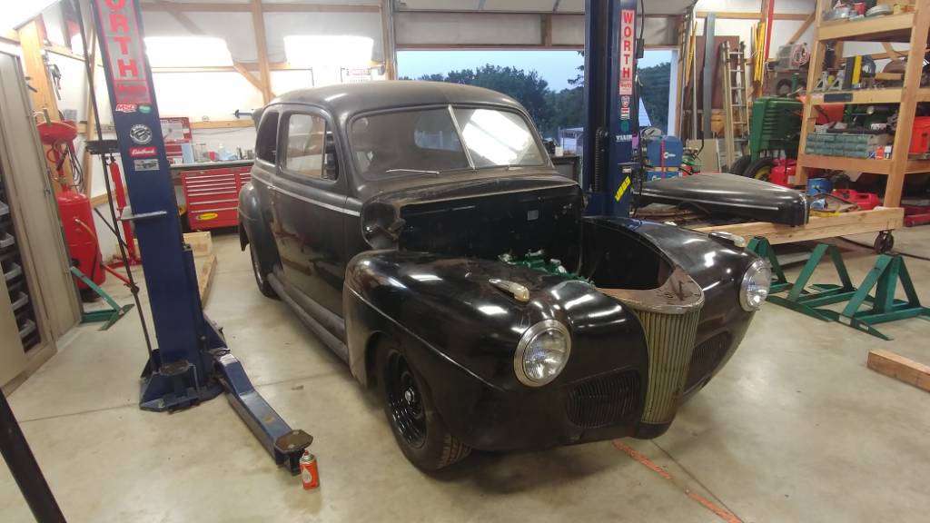

    Well, it's been a while. I have the underside of the floor pan painted, and the body back on the frame. Mounted my rebuilt distributor, rebuilt by Bubba's. Now i am in the process of rebuilding the steering box and the column. Slo and steady[​IMG][​IMG][​IMG][​IMG]

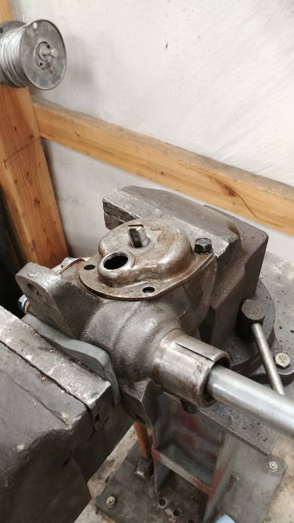

    I tore the box apart completely, and it was very dirty inside and out. But amazingly, even with no oil left in it it cleaned up like new. Worm and sector like new, bearings and races the same. I just cleaned it back to casting and re assembled. Working on preping the column for paint now( in between everything else). What part would you like to see? I didn't take a whole lot of pictures but i can shoot a few of what your after. I used the directions on van pelts site to reassemble and adjust the clearances. Also rebuilding the whole colunm and shift tube. I have all the parts, but i started back teaching in night school for the next 10 weeks and working a few weekends trying to evaluate candidates for employment. Now thats another sad story.

    How are you rebuilding your steering box? Are you using a kit or just taking it apart, cleaning and adjusting? My stock box seems pretty tight and I may not have to rebuild, but if its simple enough, why not?

    I completely tore the box and column apart. I expected to replace everything, but i couldn't find anything bad. Bearings and races perfect, and no visable wear on the worm or sector. Sector bushings also tight. So, i ordered a shim kit and lip seal. I needed to order the cover gasket but forgot, so i used silicone. I followed a set of directions of off of vanpelts web site to adjust it. It was very easy and i am glad i did it. I plan on painting the column parts and dash this weekend, and reinstalling in a week or so.

    Glad to hear it was in such good shape. I'm not going to rebuild mine unless it proves necessary. Before I started this project I worked the steering pretty well and there was no noticeable play. Also, I purchased a nice set of rams horn exhaust manifolds today off Ebay that were dressed and powder coated for fifty bucks. I believe you are correct about them clearing the stock box. I am soo happy! That just cut so much labor and cost not having to buy a new box, steering column, etc... not to mention more fab work! Plus I like the look of the stock wheel. I mocked up the steering today and every thing works great. But I will have to heat and bend the steering arms on the spindles up just a little to gain a comfortable clearance from the lower bar of the 4 bar set up. I am going to order a new steering rod, since the one end cannot be replaced, just to be safe. My steering wheel is a little beat up, but will have to do for now. I do like the fact that I have the original key to unlock the column ignition switch.
