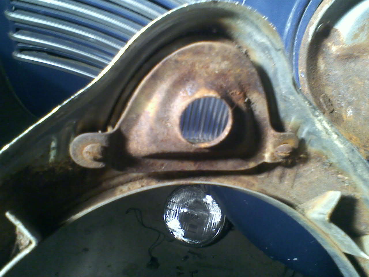

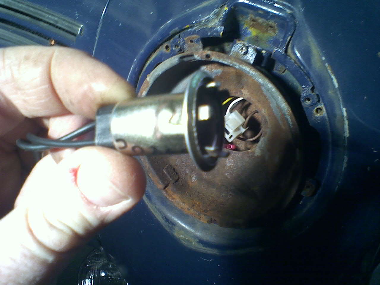

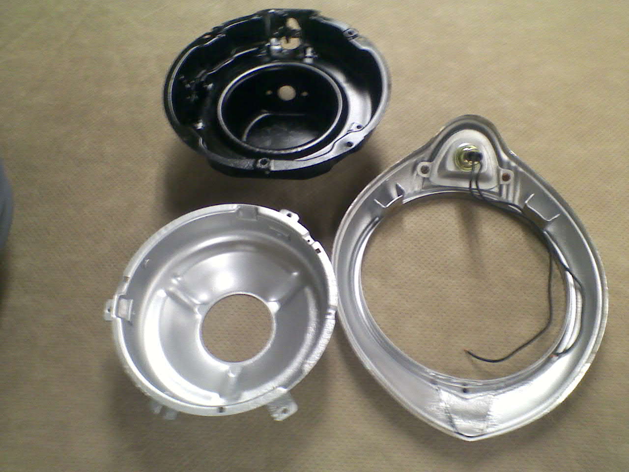

    So here is my proposed idea I'm currently working on..I will post more as I progress. I'm currently waiting on the bulb to arrive that I've ordered.. I searched and found the smallest dual filament socket I could find, which i purchased from Pico. it snaps into a 3/4 in hole. Which just so happens to be the same size as the hole in the back on the lens housing (see pics). This now left the bulb size to overcome to have clearance for the flat lens limited space. Again doing a internet search I found a motorcycle application of a compact dual filament bulb for flat lens applications..But like i said I'm waiting for it to arrive to confirm if it works..I believe it will. That just leaves a modification to the headlamp bucket to accommodate the depth of the longer bulb socket. which is no biggy, and I will overcome that next once I confirm the bulb works. The only other thing I will need to do is run a ground wire to the bezel to insure adequate ground to the socket. What do you guys think?

    That's exactly what I did with mine. I'll take a pic for you. I believe I drilled out the existing bulb holder to fit the mini bulb application, I grounded it to the bucket, and everything works great. I'm not running turn signals, so single filament bulbs are easy to find.

    That should work, as long as the mini bulb is bright enough. On my '40 I used the 1157 amber bulbs, I had to cut and enlarge the little bucket to hold the larger bulb and socket. But the amber light looks great behind the clear lens.

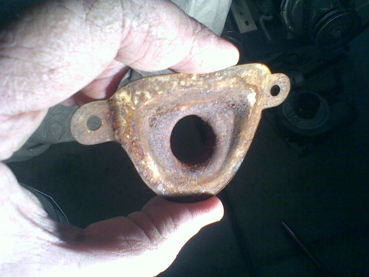

    Working on this turn signal upgrade and since im waiting on the bulbs to arrive, I thought i would clean up some rust..
    One of my favorite peices of equipment in my garage is my harbor freight sand blast cabinet..its great for small item clean up..Best $100 buck investment. Here is some pics of its handy work I got done today..

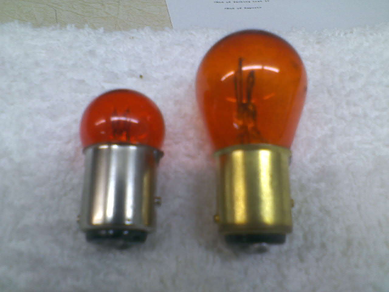

    I just received my "mini dual filament" bulbs I've been waiting for. These will work great with my flat lens application. I will post a video when I have them installed. Here is the pic of one sitting next to a conventional 1157 style dual filament.

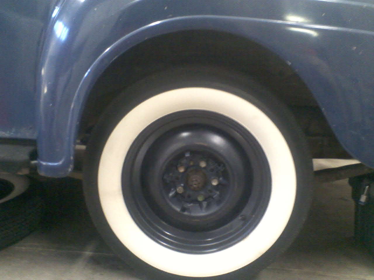

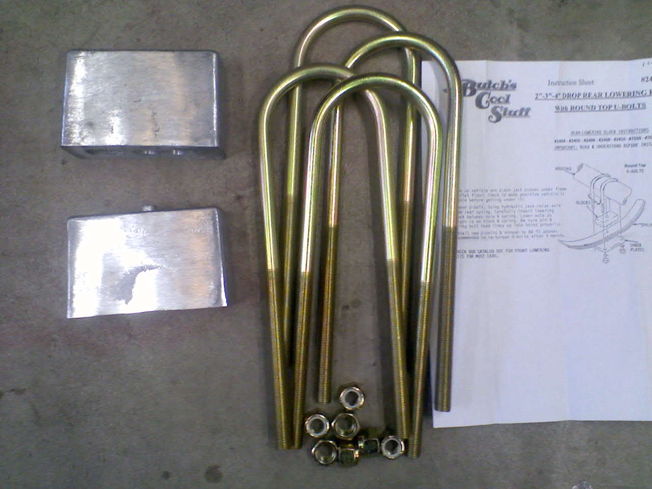

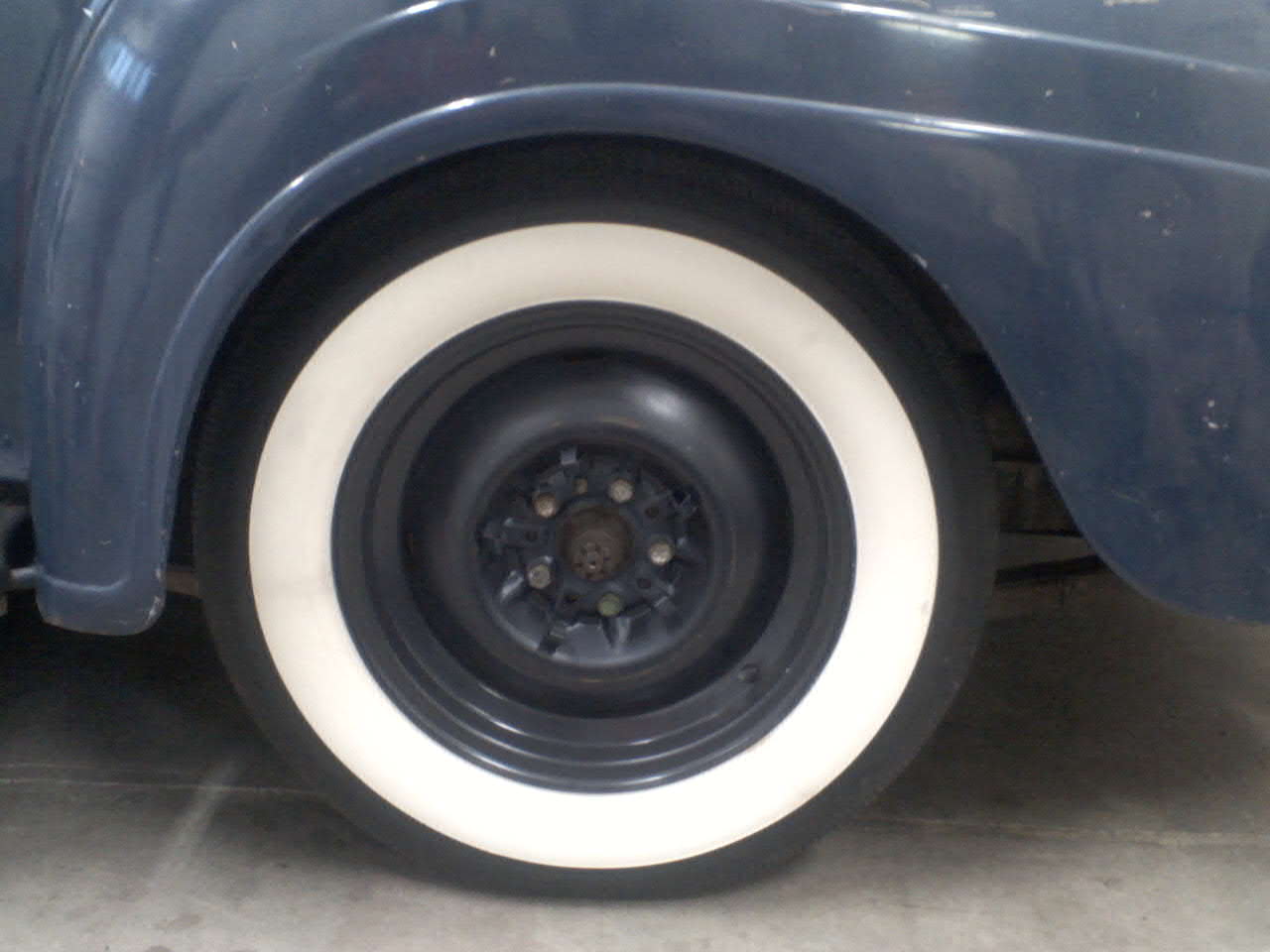

    Well this weekends accomplishments where good. I was able to get the front supsension stripped off so I can get it all cleaned up and painted for the new fatman dropped uprights..For the rear suspension I installed the 3" lowering blocks, which looks much better..However its not the final end result..Eventually its gonna be much lower, just did the blocks for now so I can cruise it this summer until I can afford the 4-link and the other parts involved with that..Here are some pics showing the progress and the before and after of the rear end lowering..Hope everyone had a good weekend too..

    That rear looks a lot better in the fender than before. Should also improve the handling. Looking good!
