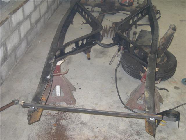

    Heres a few pics of my build process up til now. So far just a whole lot of cutting, welding and grinding on the frame rails.

    A few more pics through 3-14-11. Hopefully we'll have a good n productive weekend.

    I made alittle bit of progress this weekend. I had made some leaf spring brackets and tacked them to the inside of the frame, then found out the tank may interfere with the rear of the leaf springs. I wound up removing the brackets. Instead of either making a bracket or buying one to mount below the frame rail I cut the inside frame rail and the bottom out where the leaf spring is going to mount. Then I boxed in the cut out area so the leaf spring will slide up inside the frame rail. One frame rail is almost complete and the other is cut out.
