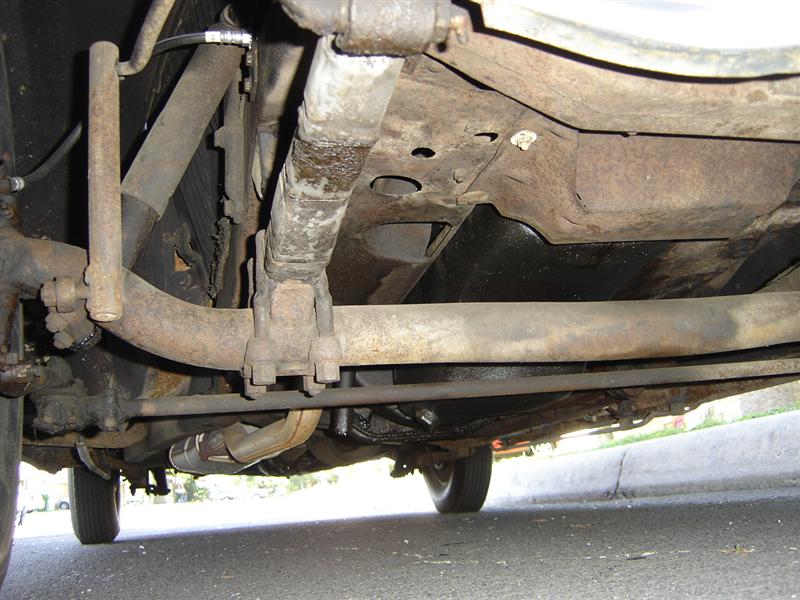

    Right, so shocks are fitted, wheel cylinder done, just need to bleed the system now. Should be able to do that tomorrow with a little test drive to boot :).
    I've been thinking on how to lower this car... I'd like to see it about 4'' lower.
    - I can't rearch the springs, as they don't have much of an arch to them already.
    - Can't flip the axles, as on the rear the leafs are already mounted under the axle and in the front the leafs would be interfering with the draglink;
    - Don't see longer shackles do anything to the stance on this car;
    - I'm not a big fan of lowering blocks, especially with big drops.
    Any suggestions? Maybe make new mounting points for the leafspring shackles at the rear? About 4'' higher :rolleyes:..? And is it possible to run a draglink that isn't straight, so could I make up a new ''bendy'' one?
    I've put some pics up to clarify things... Some input would be much appreciated!
