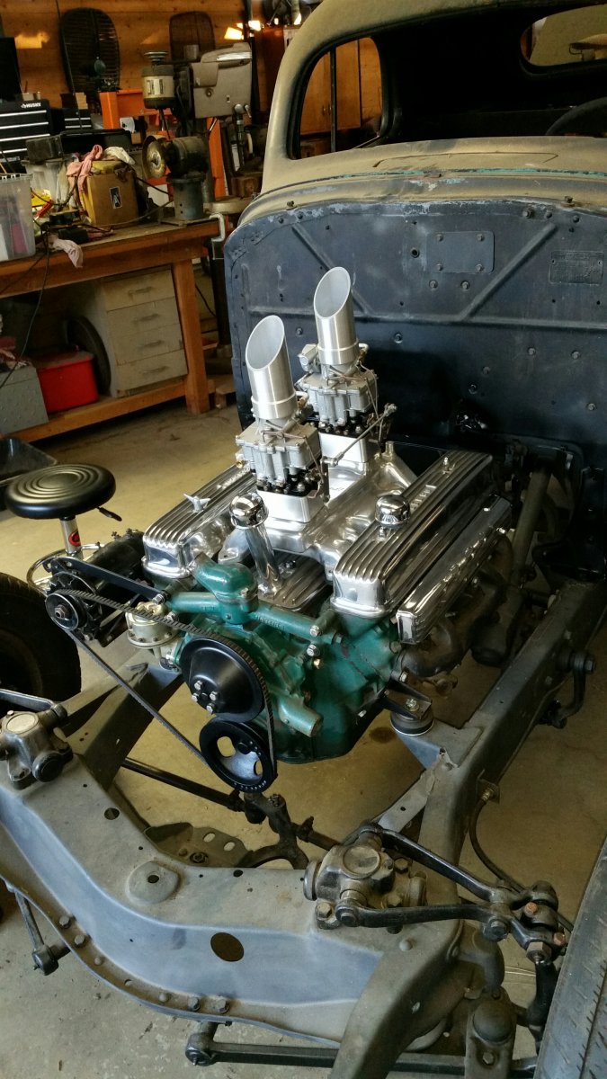

    tstellhorn
    Another crappy cell phone picture, but here’s a quick shot of the carb setup for my car. That’s twin Stromberg Aerotype carbs on an Edmunds 2x2 intake. Dick York of Dick’s Hot Rod place ([email protected]) did the work and did an excellent job. I want the carbs to sit up high, so Dick fashioned 2” risers and the cool velocity stacks. Great plumbing work all around.<?xml:namespace prefix = o ns = "urn:schemas-microsoft-com:eek:ffice:eek:ffice" /><o:p></o:p>

    tstellhorn
    Still working on the front suspension but I placed the intake and carbs on top of the engine for mock up and a few pictures to share. Hope you all enjoy.

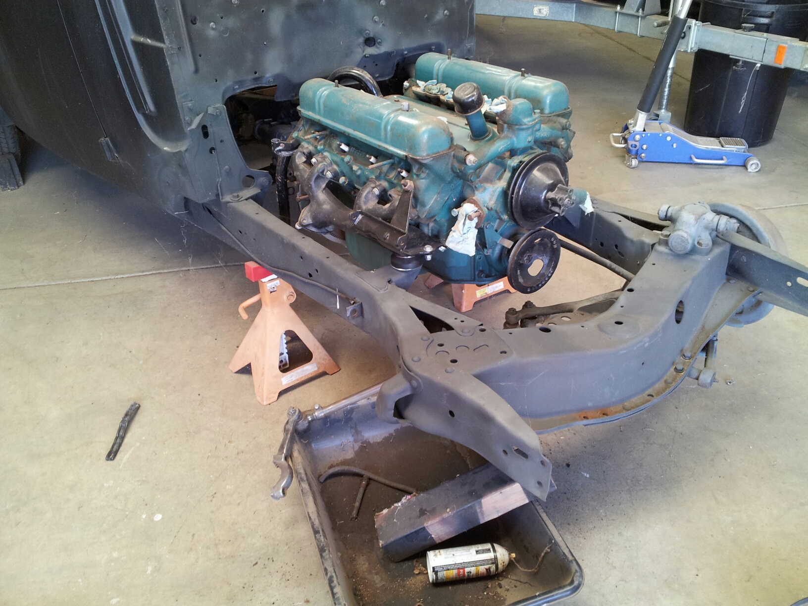

    Just getting back to this thread. Wow - Another 36 Olds with a 264 nailhead. Amazing.
    Another mock up picture attached. Still making progress - Working mostly on the rear brakes right now, but finally got the valley cover installed. Needed to have it milled down a bit to fit without having the remove one of the heads.

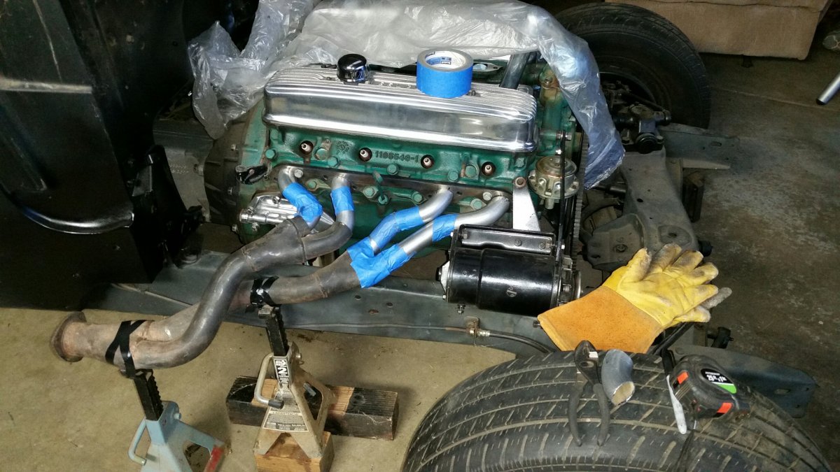

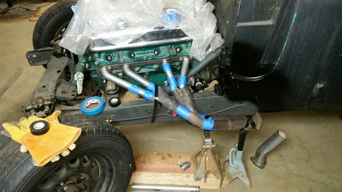

    tstellhorn
    Working on headers. The bottom half is a set I found at a junkyard cut down with the top half pieced together. Needs final welding. I will either wrap the top half or paint them depending on how my welding comes out. Other than a few companies selling lake-style kits, I can’t find anyone making nailhead headers.

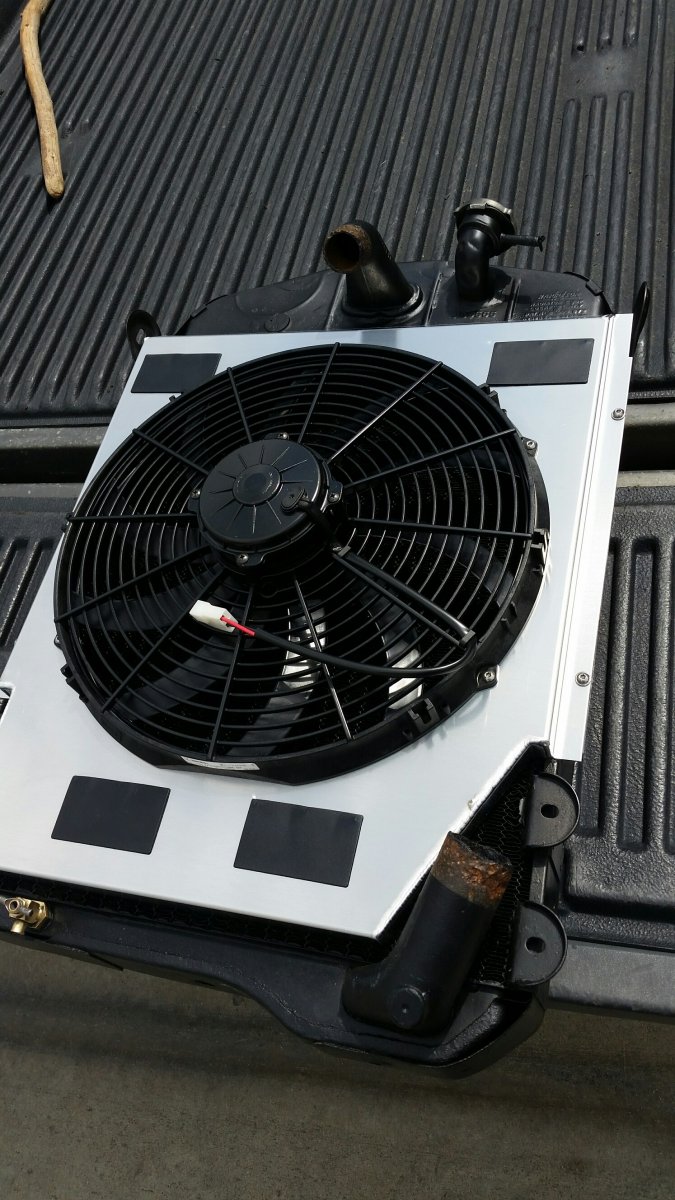

    tstellhorn
    A few updates on my project. Radiator shroud and the radiator install mocked up. And the grille shell and headlights mocked.
