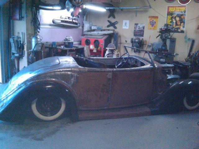

  1. Here's a car I did a few years ago. I kinda missed the mark on the shape a little. The metalwork was okay. I had planned on redoing the back end at some point. I had so many people offer to buy it I eventually let it go. I really regretted it. ImageUploadedByH.A.M.B.1403317842.740893.jpg ImageUploadedByH.A.M.B.1403317949.753859.jpg ImageUploadedByH.A.M.B.1403317994.450203.jpg ImageUploadedByH.A.M.B.1403318038.281016.jpg ImageUploadedByH.A.M.B.1403318071.234609.jpg ImageUploadedByH.A.M.B.1403318199.689094.jpg I bought a four door because I was going to build a woodie. Some how it turned into this. This was my daily driver for year.

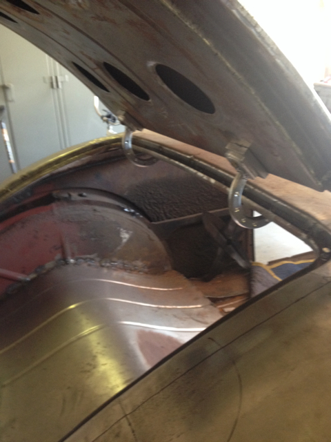

  2. ImageUploadedByH.A.M.B.1403570444.906276.jpg my decklid is coming together. Needs a lot more fit and finish. but so far I like it. It's amazing to me how fast Metal rusts when you sweat on it.

  3. Squablow

    Posts: 17,432

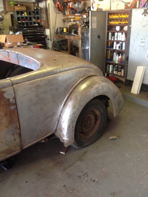

  7. ImageUploadedByH.A.M.B.1403910930.846953.jpg ImageUploadedByH.A.M.B.1403910944.565936.jpg ImageUploadedByH.A.M.B.1403910956.702612.jpg
    Been working on getting my deck with fitting correctly last few days. Josh over at true metal shaping makes decklid skins for 600 bucks. I really wish I would have bought one. It's funny the panel that would seem to be the easiest to make really turns out to be the hardest.

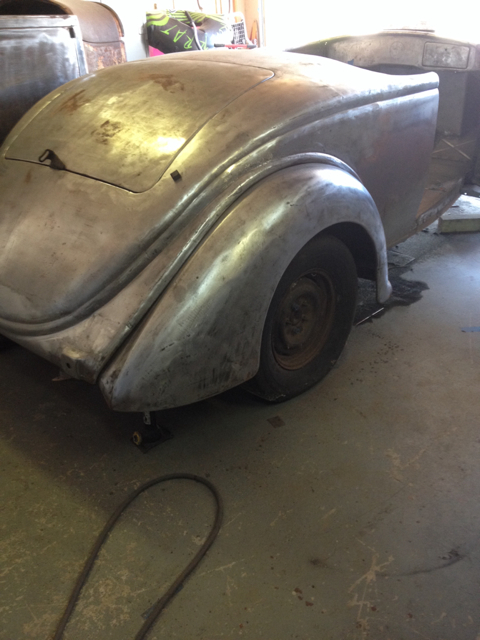

  9. ImageUploadedByH.A.M.B.1404182955.053453.jpg ImageUploadedByH.A.M.B.1404182978.076358.jpg ImageUploadedByH.A.M.B.1404182999.001942.jpg ImageUploadedByH.A.M.B.1404183035.111389.jpg
    Got all four corners looking the way I want. It's getting close

  12. ImageUploadedByH.A.M.B.1404498018.475342.jpg ImageUploadedByH.A.M.B.1404498030.860615.jpg ImageUploadedByH.A.M.B.1404498042.147963.jpg
    Been working on the back panel for the interior. I wanted the lip in the doors to follow all the way around the back area. That way the upholstery would have a nice finished edge. I don't really like the way stock roadsters look with that big heavy lip on the back for the top. This will have nice finished edge when the roof is off. Main reason why wanted to build a Carson top.

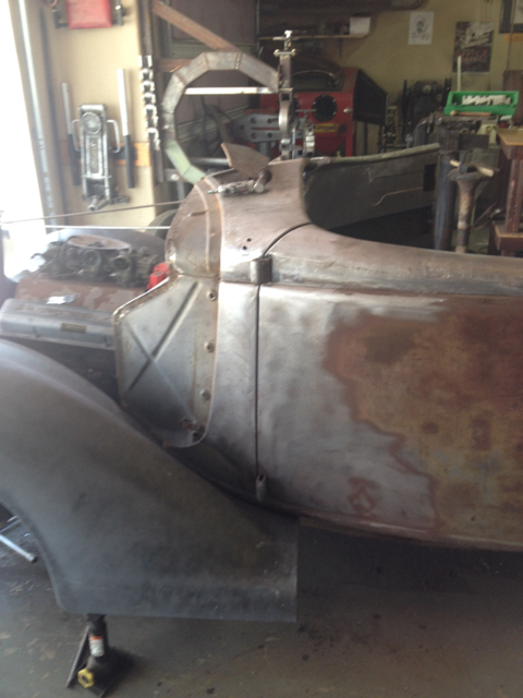

  14. ImageUploadedByH.A.M.B.1404600841.516185.jpg ImageUploadedByH.A.M.B.1404600854.192902.jpg ImageUploadedByH.A.M.B.1404600867.340296.jpg ImageUploadedByH.A.M.B.1404600881.811244.jpg
    Good day for door gaps. Trying to finalize all the little things so I can get the body in primer.

  20. ImageUploadedByH.A.M.B.1408473396.650221.jpg ImageUploadedByH.A.M.B.1408473432.182012.jpg ImageUploadedByH.A.M.B.1408473489.965334.jpg
    Nothing to exciting going on. Just been working out the metal and finishing out some of the small stuff. Trying to get the body in primer so I cam pull the body.
